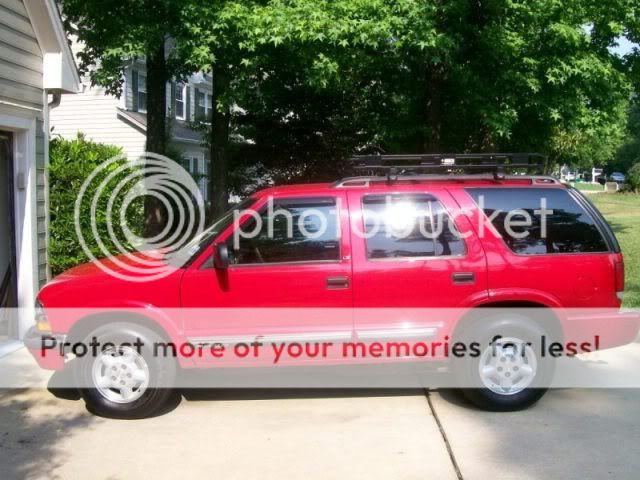

A body lift gives you the same frame clearance that you have now. personally I have a 2in suspension lift, I have had it for 4 years and only replaced 1 ball joint on a truck that has 104,000. As far as tires go, i had the orginal skins on them and yes it looked a little weird, but people knew that it was a raised truck, once i got 30's you really could not tell the difference, they looked like stock wheels. To me body lifts are not worth it, and i can tell when other truck have them on, by how the boddy is sitting on the tires, frame is expesed, and the rear axel is showing.
i would say do what you want with your rig, it is yours and yours only, this is just my opinion
