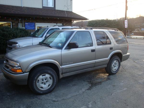

this is my truck when i first got it i believe its the 70r15 tire
how much lift will the 31in tires give with out a lift kit
i havent found a site yet with the kit do you know any??

What kit?
I do not believe they make 3 inch bls. You can get 2 inch body lifts, and the suspension you just crank the t-bar.

If you do a torsion bar crank with no body lift you can run 30"s with the stock rims. 31"s with fender trimming or a body lift.

ok ill get the 2'' body kit 31'' tires and ill put another 1'' on the torsion key
