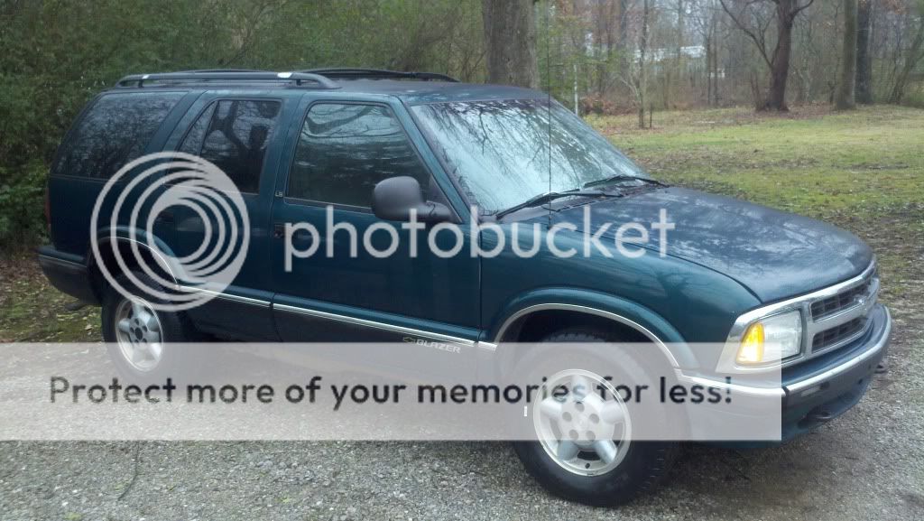

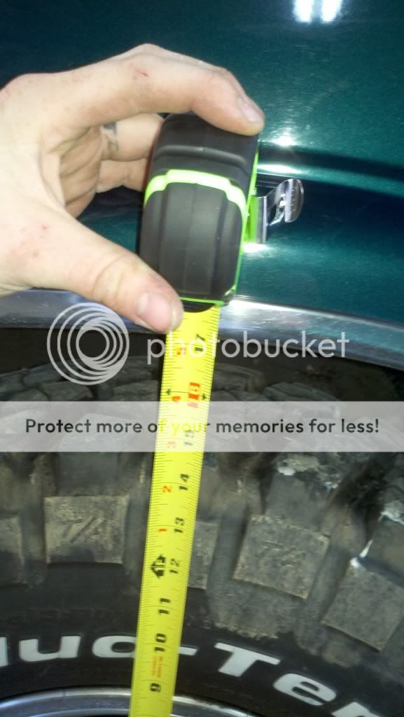

I leveled the blazer today...6 turns on the torsion bar adjustment bolts gave me exactly 2" of lift in the front...seeing as how there r tons of guys that have done this already...I didn't take many pics...
not worried about parts wearing out as of right now..I plan to do the BDS 5"lift in the spring which should do the trick
Before
After
