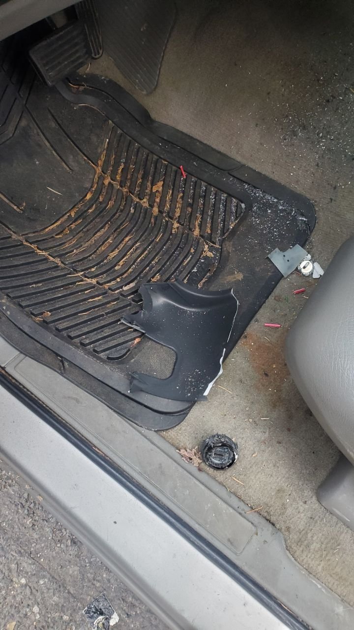

I park on the street outside my apartment, and there's been a LOT of vandalism and theft recently. Two nights ago, after I'd gone to the car wash to flush my heater core to try to get some heat blowing (was only getting cold air, now it's just warm) someone tried steal my baby. [see pics] She came with an alarm, but I'm pretty sure I forgot to lock her up, and they got in. Lord knows what the hayl they thought they were doing, but they royally screwed my ignition, destroyed the wires underneath, and generally left me stranded. (I have AAA, and I'm going to tow her to my buddy's.) They also absconded with my new toolbag (+ impact driver, new ratcheting wrench set, and OH YEAH.. my HAYNES REPAIR MANUAL! The jerks!)
So now I've got this to tend to before I can move forward with anything else. Has this happened to anyone here, or do you have any experience with replacing this stuff? I'm thinking I can go to the picknpull and get the harness. But I'm not sure what other electrical components are damaged? What can be repaired vs must be replaced? Since I don't have the Haynes on me, I can't even check IF there's sufficient info on this section like a schematic?

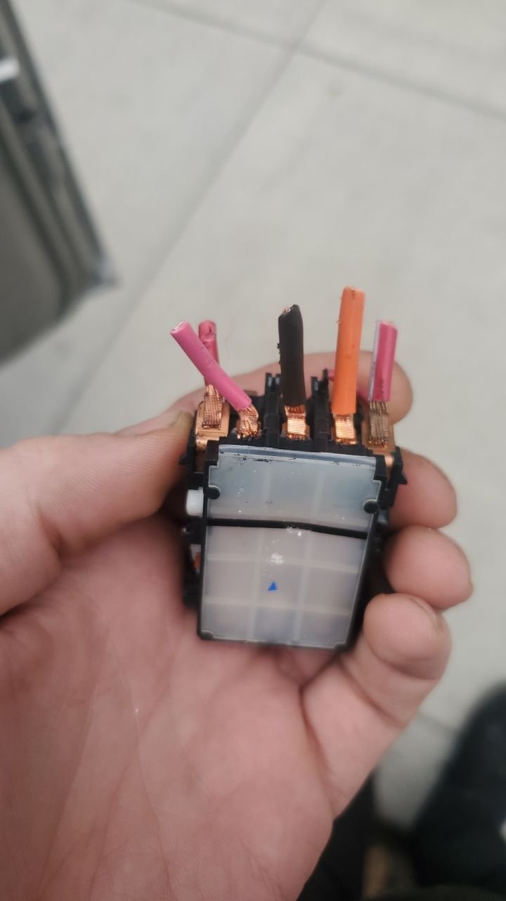

Can anyone guess or tell what pic-3 is of? is has a white, toothed half-wheel on the side. I can get a couple more pics if that would help figure it out.

Look at my poor ignition!
Column shroud broke.

Oh man, that sucks! The third pic is part of your ignition harness. Doesn't look like the person who did that had any idea what they were doing. Got all their auto theft lessons from TV.
Old Nov 24, 2021 | 05:21 PM
I think I would pick up a complete column at the junkyard.
