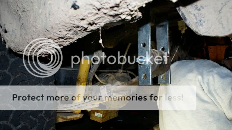

So this past weekend I wanted to put rear shackles on my blazer and I thought it would be an easy install. which is should have. only problem is if you have an older blazer you have the problem of rust. It took me 12 hours to remove the shackles and bushings from the right leaf spring and the frame. I took some pictures and I'll have some instructions on how to make it smooth.
1. Jack it up and put it jack stands on the frame. once this is done put the jack under the pumpkin and just jack it up a little.
2. The two bolts you will have to remove are going to be very tight from rust if you have an older blazer. I used an impact wrench on one side it worked pretty good. A long socket wrench would work as well. you may have to pound on the screws to get them to come out.
3. Then once you have the screws out the shackle will come right off. The easiest way to put the new shackles on is to take both shackles off at the same time or else u will have to pull down on the leaf spring.
its as easy as that if you don't have any rust, my problem was I did have rust. What I did was take a torch to the bushings and melt the rubber inside and eventually push the rubber out. after that there is still the metal casing around the bushing still in the hole at this point we used a saw-zaw and cut down and bent and twisted the casing untill they popped out. it sounds easy but it takes a long time to do this.
Here is some pictures:
heating the bushing on the frame
the new bushing on the leaf spring (should fit really snug in there)
the side that didn't give me trouble
the bushing in the frame it was really rusted in there
almost have it out at this point
the mess we made
before lift
after lift
any questions I'll be happy to answer them

I did mine Friday night. I took a torch to my passengers side no problem but i dropped the leaf on the drivers side because I was afraid of catching my full tank on fire. is that some universal shackle kit?

yea i bought the shackles at advanced auto for $16 cant beat that haha. Only things it doesn't fit is a 1955-1957 chevy for some reason? I have about a 1.5" in the front and 2" in the back so it sits almost level now. lol yea I didn't have the problem with the gas tank since that side came off ok. I had to drive to about 4 advanced autos and one auto zone the dude there was trying to sell me $52 bushings and I'm like dude I didn't even pay near that much for the shackles. None of those people at advanced auto know what they are talking about for the most part i wouldn't even trust them to put in a new headlight or windshield wipers haha
