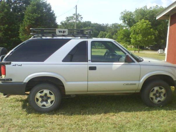

Can anyone tell me what kind of lift I have...I know I dont have a suspension or a body lift but for some reason my blazer sits higher then most I have seen stock? I have the 2DR 4X4 with the G74 Heavy duty suspension, G80 posi-trac/limited slip...it looks like my T-bars look like they are cranked but I am not sire...this is my first blazer so any help would be good...I want to put a 2" body with 31" tires but need the money first....my pics are under my galleries (97vortecblaz).

from the pic your blazer looks to be stock height, you could always measure your ride height from the ground to the wheel well and then compare that to another 4x4 blazer that you know is stock and if you cant a stock 4x4 for comparison im sure sure if you ask someone on the forum to take measurements for you they would.

I know the Z85 sits up a little higher than most others - except the ZR2... Yours looks stock to me.
It also looks like you are running a 70 series tire and not a 75 series tire, which would give it more room in the fender.
Center of the hub up to the edge of the fender should be around 19", give or take a 1/4".

yeah it is a 70 series...I baught the blazer with those tires on it. I thought it was stock seeing as I had no body lift and all the springs and shackles looked stock I just wanted to make sure. I will measure the wheek when I get off work today. Thanks for the help.
