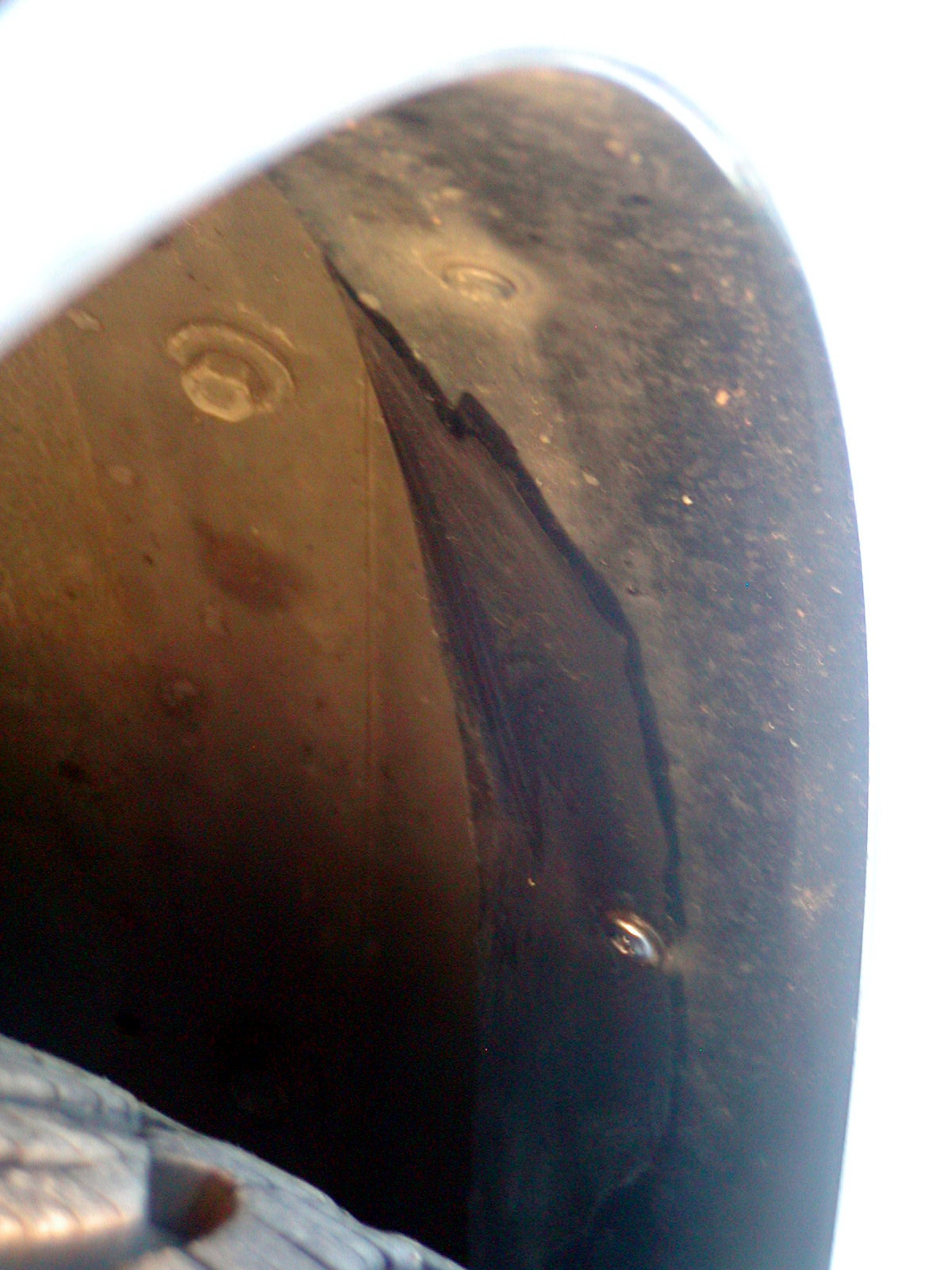

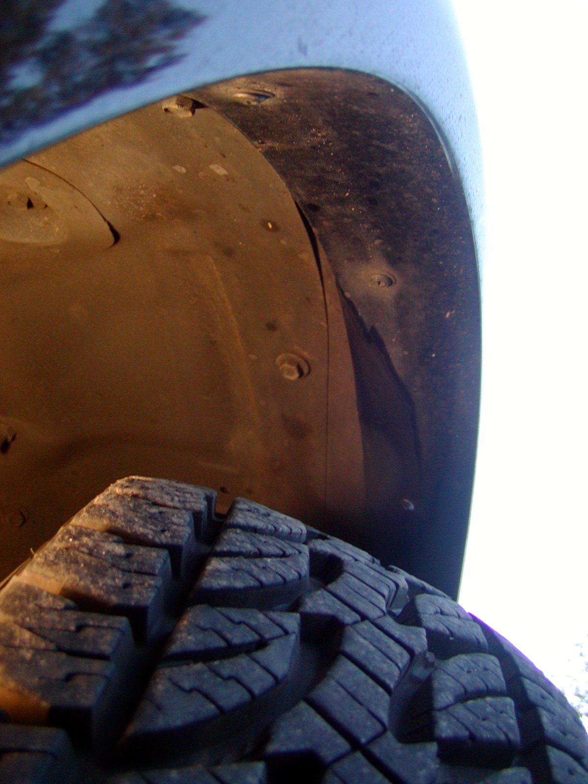

Had a look at my fender flares today. They're wearing pretty quick so I need to do my lift sooner rather than later. I'll do the t-bar at 1" & fit the 2" shackles.
Problem is, there is only one shackle supplier I could find on e-bay and they don't do international shipping.
I've checked the local 4x4 shops - nobody makes them. So, I've decided to get a metal shop to fabricate some for me (price permitting).
Attached Thumbnails Time for a lift.-p1010001.jpg   Time for a lift.-p1010003.jpg

foxxie has some welding skillz... maybe a meet and greet could be in your future...
Save those flares! they are too pretty to be ground up

So today I decided to do the t bars. Lifted it by 1" and no more rubbing on my flares.
I had 100mm between the top of my tyre and the flare. Now there's 130mm.
For those who do not know, my tyres are directly under the flares & not inside the wheel well.
After a test drive, I checked all the measurments - frame to ground & then top of tyre to fender. Both sides are equal.
Problem now I see, is that the right rear is 15mm lower than the left rear. Not sure if this has always been the case or if the left t bar is now pushing the opposite corner down. (If that's possible). I note the t bar bolts are not in the same amount - The RH one is now screwed in almost as far as it can go.
Maybe I've just got some sag in the right side spring.
I took a pic but not sure if the "lift" is obvious or not. Otherwise the truck looks level from side on so maybe there's no need for new shackles.
WHAT YA ALL THUNK!!!! LOL
