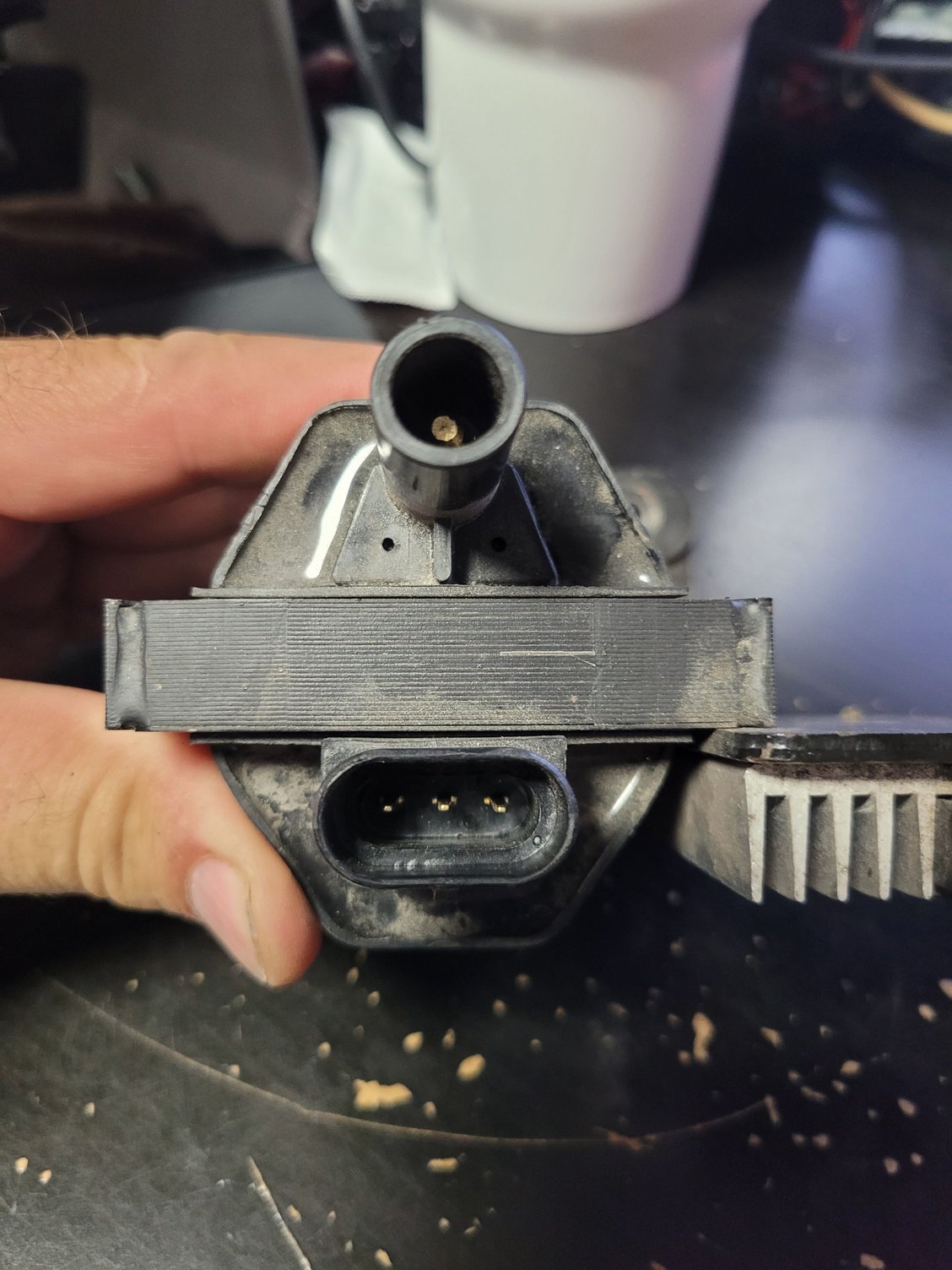

I've searched a bit on here but can't quite figure out what the problem is with my 2001 Blazer. It was running fine and then all the sudden.... crank but no start. I have diagnosed that there is power up to the coil... but no spark out of the coil to the distributor. I have put the ohms meter on the coil and I'm getting 6.78K on all three prongs to the main post. I have actually put another used coil that I have from a 1999 blazer just to make sure. Same issue. I have also tested the output post side of the coil with a spark tester and nothing. I have added a couple of photos for reference. The plug going into the coil has a pink wire and a white/black wire. Pink has power with key on when unplugged and stays hot while cranking. White/black does not. Both pink and white/black have power when plugged into coil with key on and while cranking.

So after some additional troubleshooting I saw a video on how to run power to the signal (white) wire on the ignition control module in order to generate spark in the coil (basically bypassing the ECM). It worked! I put my spark tester on the output of the coil and ran the test. Got spark! So that ultimately told me my coil was good and narrowed it down to three things.... cam position sensor, crankshaft sensor, or ECM. I bought a new crankshaft sensor and a cam position sensor and thought I'd just replace both. I went ahead and did the crankshaft sensor first.... and bang! It started up. Thank goodness! Guess I'll return the camshaft position sensor tomorrow. Hope this can help someone else.
