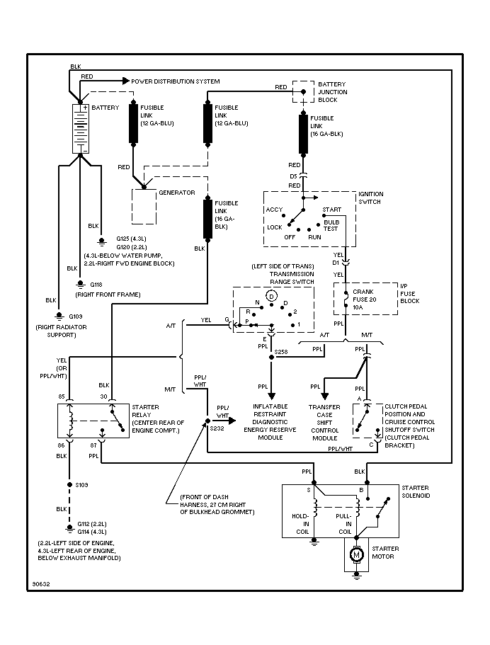

I just spent the weekend troubleshooting an intermittent starting problem on a 97 blazer.I had the chilton manual but the schematic was wrong.
It drove me crazy because I had 12v at the solenoid when it would not crank and after replacing the starter it still would not start.
As you stated there are problems with the ignition switch but diagnosing the problem using the correct schematic is the only way to gohttps://blazerforum.com/forum/attach...arting_sch-gif
In my case I always had 12v at the yellow pin of the starter relay even when the problems were intermittent and there was power to the relay but when I turned the ignition there was sometimes no output on the relay that feeds 12v to the solenoid
I replaced the starter relay($16) and was up and running .
Hope this helps

Hey thanks Steve this is really good info!
I will get back to it tomorrow morning and let you know how it went down.
In my case, I guess it could still be a problem with the starter motor solenoid switch.
I will measure the voltages I'm getting at the starter motor first thing tomorrow.
Thanks for the schematic clarifying how the fuses are wired up in respect to the various switches, that makes things a lot more clear.
