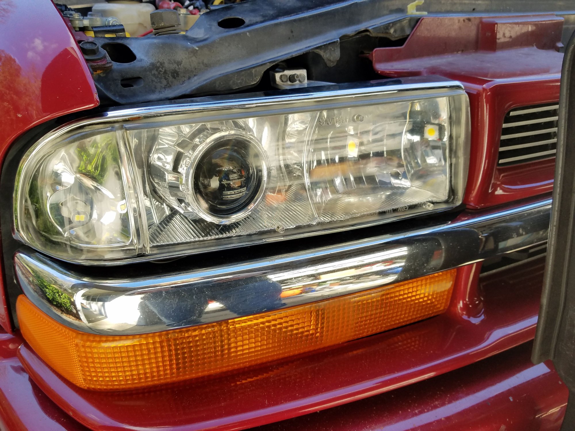

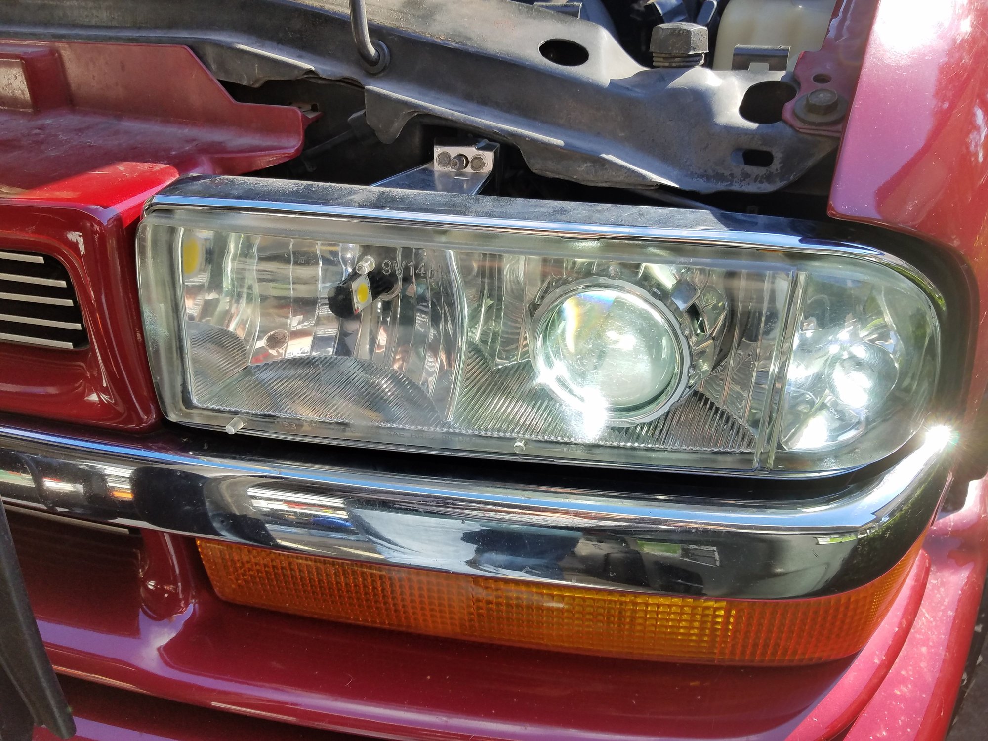

I've done several projector retrofits with great results. I did a set of aftermarket clear headlights for my Blazer some time back, and the lenses have started fogging up and I've been fighting moisture inside one of them, and I'm just tired of dealing with them and am ready to just replace them lol. It was a real chore to get them to fit inside of the basic clear lens aftermarket lights; lots of cutting and even clearance the radiator support because of how far back the projector had to sit into the light... Just wondering if these lights that already have projectors in them would be any easier to convert over.

Yeah judging by just pictures the lens definitely look smaller than the 2.5" lenses in the Morimoto Mini H1 7.0's that are in these lights I built for the Blazer, or the cheap clone Mini H1's I have a dozen of in the garage left over from when I was doing some retrofits for friends lol. I also have some LED projectors out of a Prius that I've been wanting to try on something, I'm not sure on how big those are exactly, they're buried in a box in the garage somewhere...
I have no issues dremeling out the opening for the lens if needed, but I would cross that bridge when I get there if it came to that.
I've been spoiled by the light output of good projectors now, so there's definitely no going back to stock reflectors or sub-par projectors lol

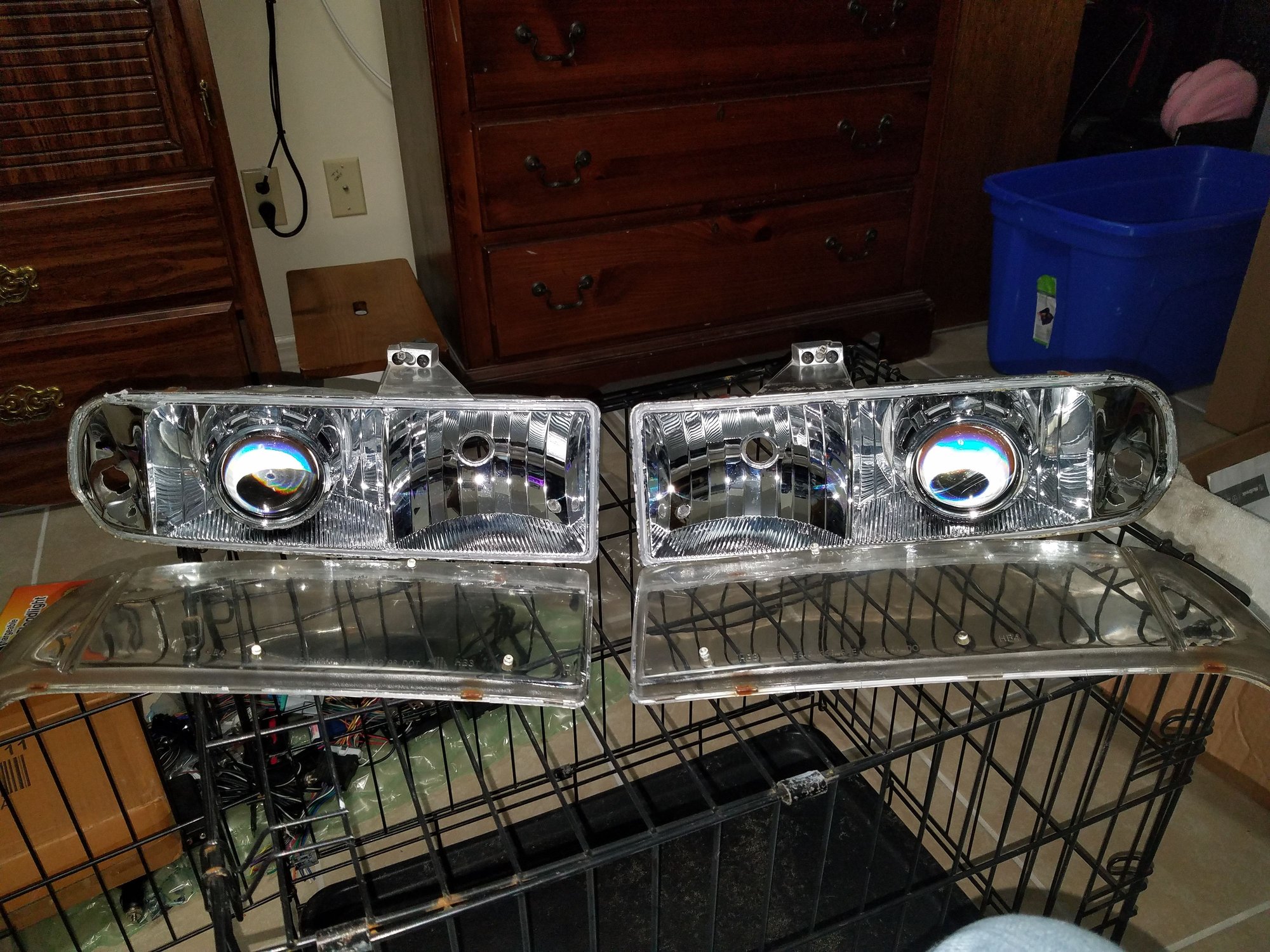

Well last night I went ahead and ordered a set of the headlights, so I'm diving into this and we'll see how it goes

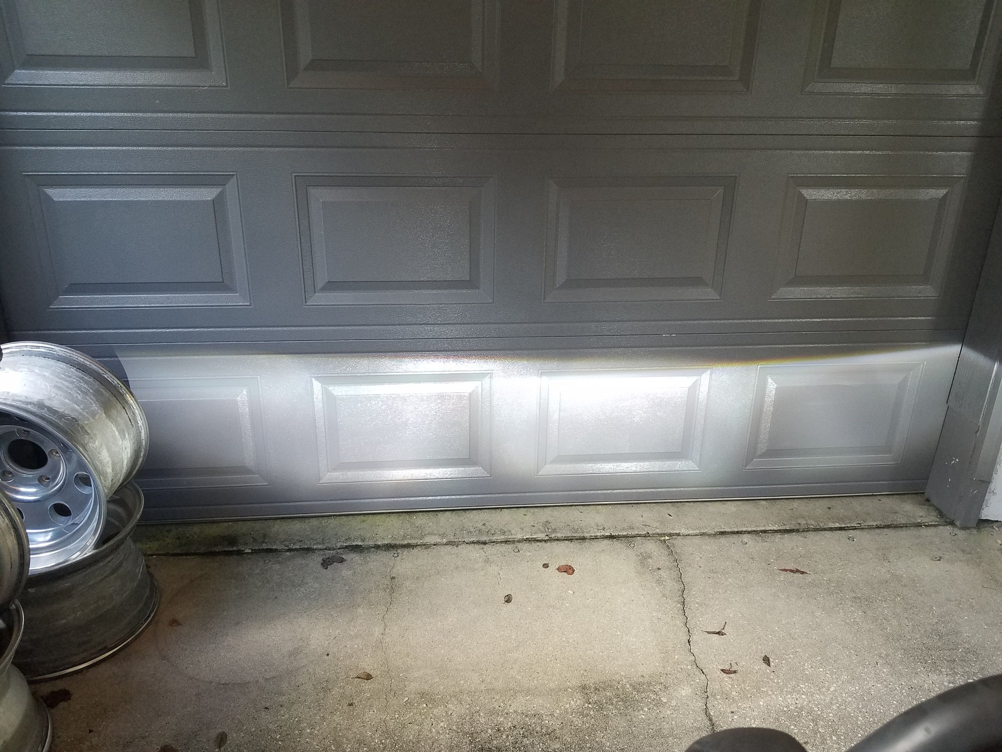

I aimed them as per spec against a wall at night, and the hot spot on the driver side is down and to the right as it should be. Passenger side is pretty straight ahead and down, so glare is kept to a minimum.
My truck is lowered, so aiming the lights properly is tricky, but by trial and error I can usually get them just right.

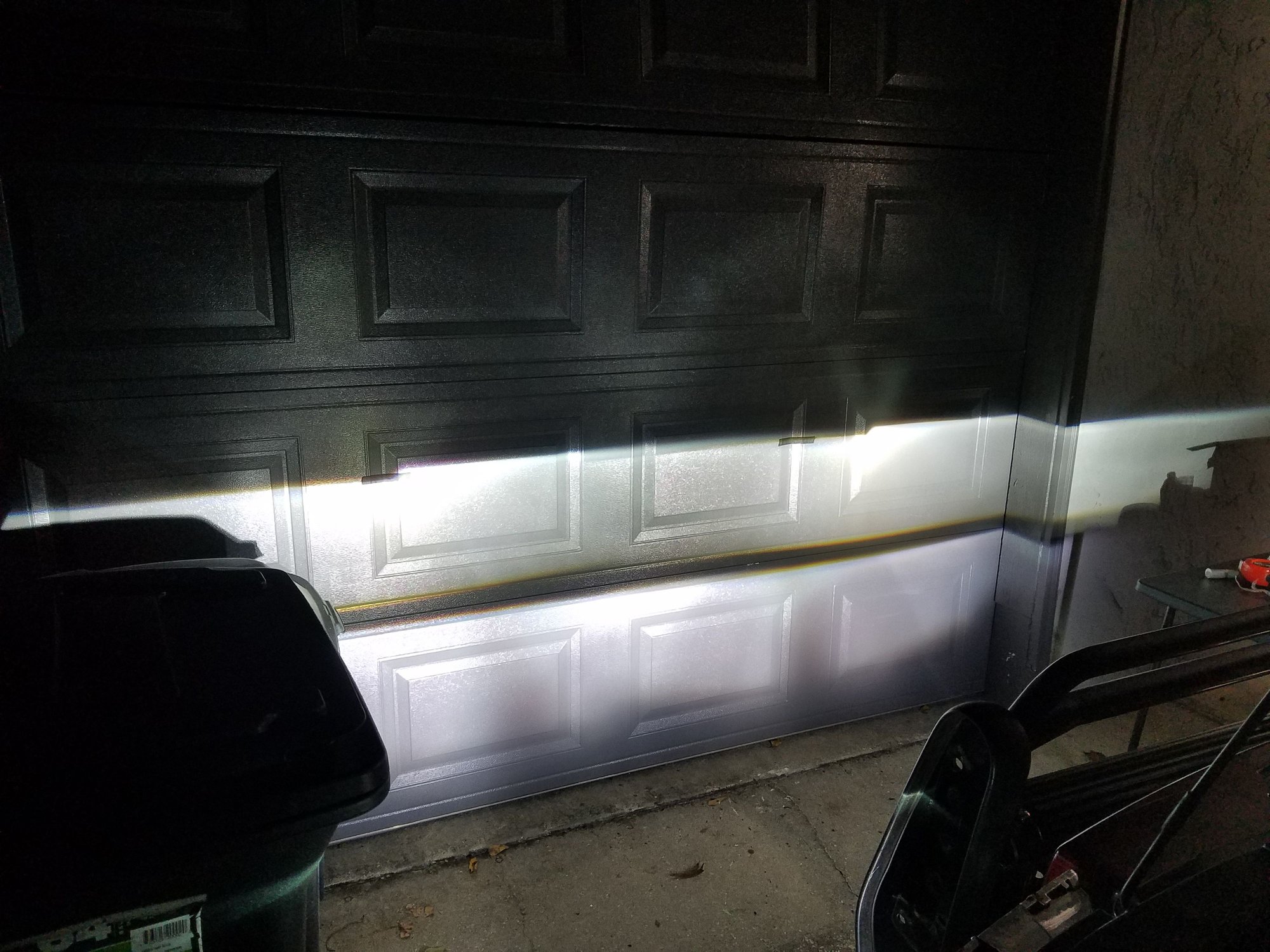

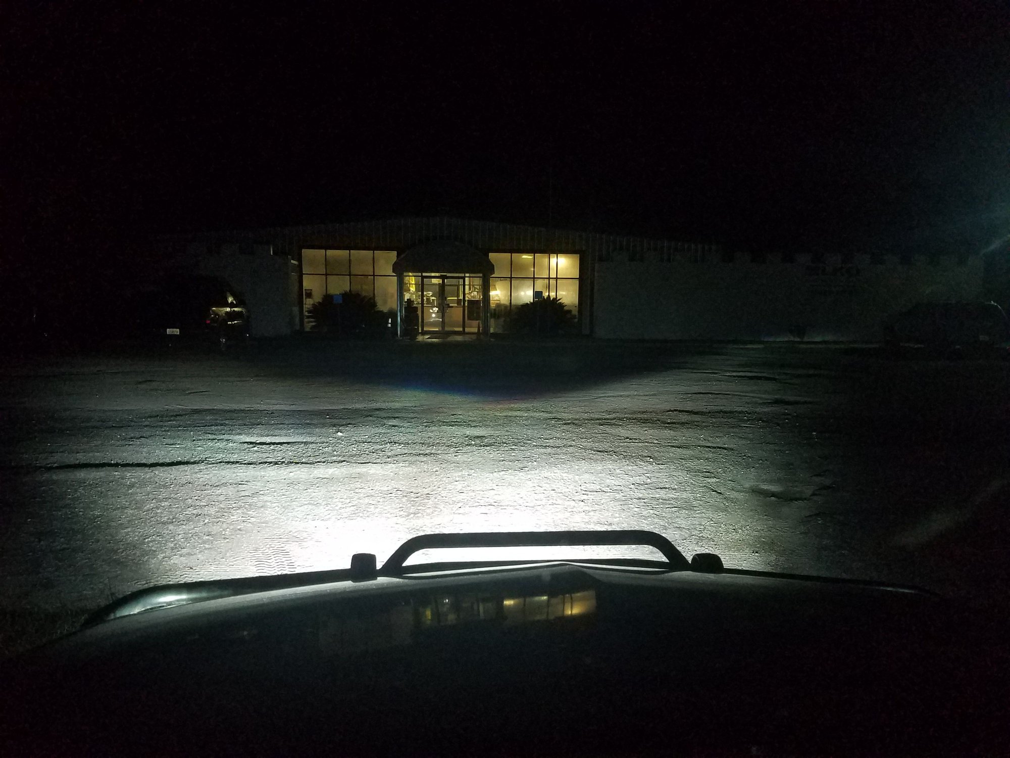

The current setup is the retrofitted clear aftermarkets, Morimoto Mini H1 7.0's, but running cheap eBay 55w 6000k bulbs in them with some cheap digital ballasts. They output is amazing, and despite using cheaper bulbs and ballasts, I've never had any issues with them. Also using cheap LED bulbs in the high beam spots. They're not really bright by themselves for high beams, but luckily the bixenon feature of the Mini H1's has made that a non issue lol.
These retros came out looking and working great. I wanted something that didn't look ricey looking, and the end result was an almost OEM looking projector headlight. I just wish they didn't have the constant moisture issue... The back housing on one of them cracked and split during the lens separation. I tried to seal it the best I could, but I don't know if the moisture is getting in there, around the lens, where I sealed the back of the projector bowl to the back of the housing, no idea... But the light assemblies themselves are older, the lens is in rough shape now, so I just want to do away with them and start over...

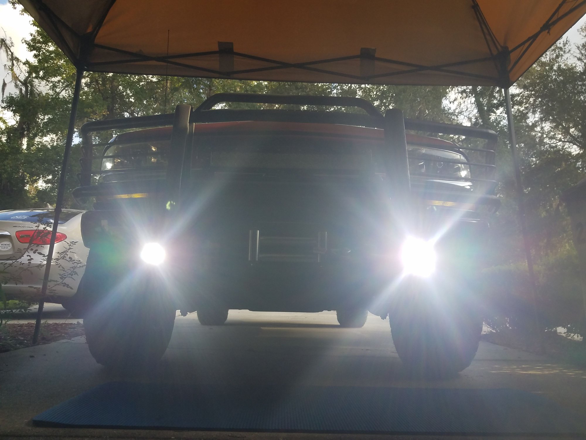

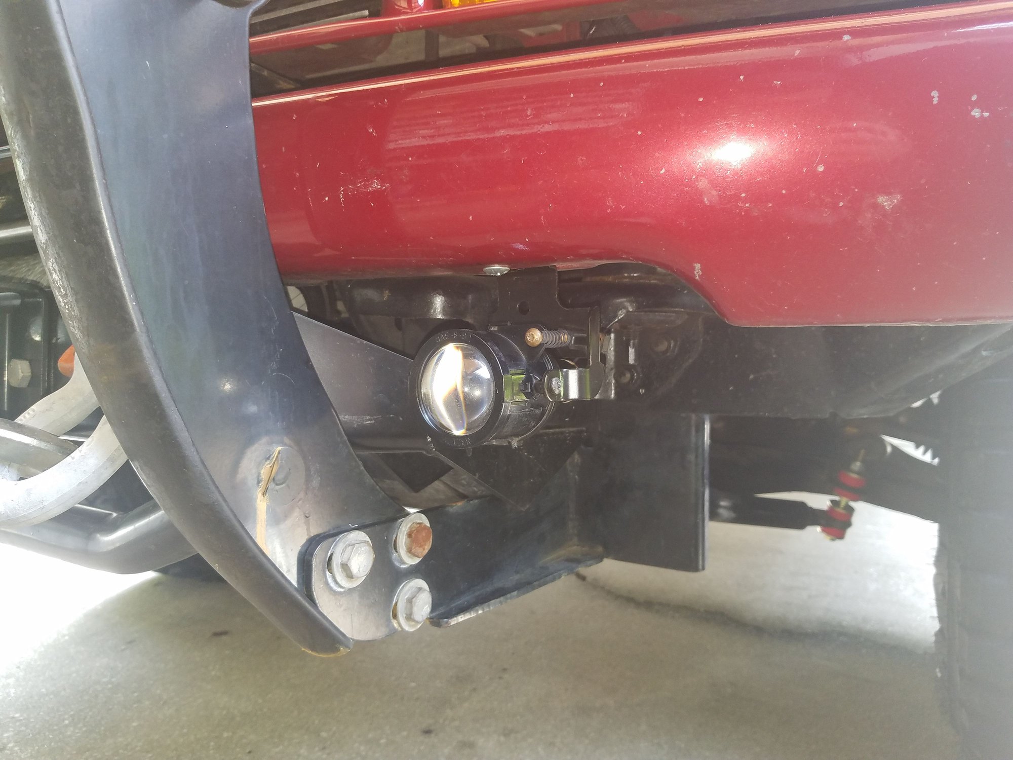

I'm also using Blazer brand projector fog lights I pulled off a Corvette in the junk yard, threw some 55w 6000k HID's in them too and they're stupid bright for they're size, and have a great cutoff. I can actually drive at night with JUST the fog lights on as low beams lol.

Well hopefully it's a somewhat straight forward projector swap. I'll take photos and document the process!
