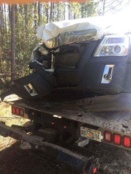

i have a set of GM Factory Headlights for a 2014 Terrain, i may do some experimenting with the HID lenses in there since being OE factory units they have a really good beam as is and there are drop in LED upgrades that work with stock wiring.

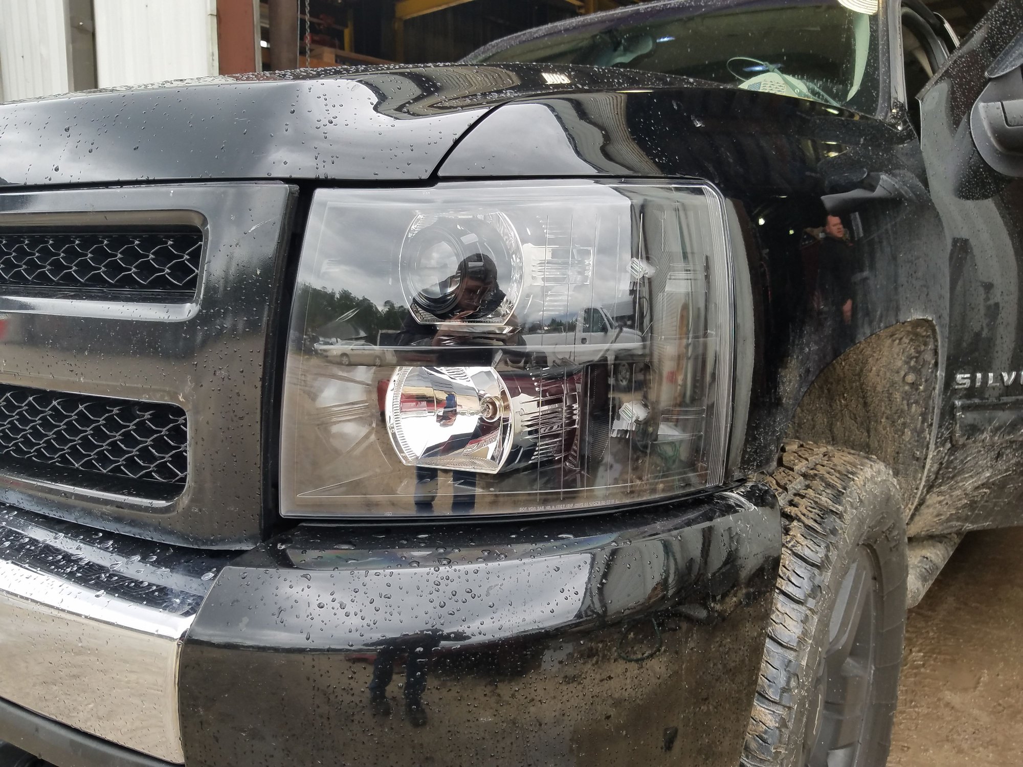

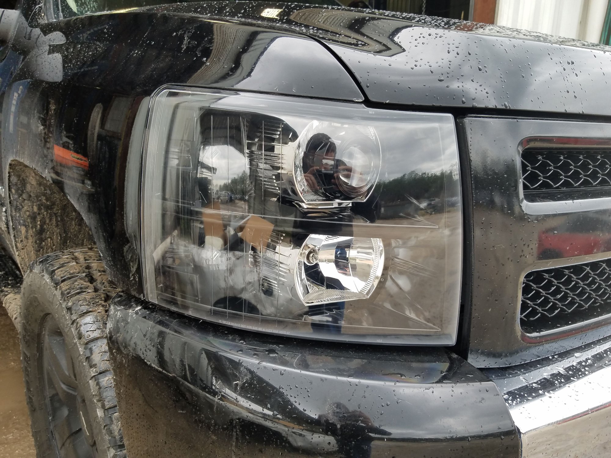

Newer GM OEM headlights are a bear to separate... I did a set for a buddy's Silverado, full HID projector retrofit. They came out great, but it was NOT easy to get the lens off... GM uses a different type of glue that doesn't soften when heated up like the sealant that everyone else uses...
Good thing the lenses are cracked to high hell then! They were on a vehicle that had a frontal offset crash at low speed, and then later totaled at 80 mph into a forest, The Square body terrains are extremely good rigs, as i learned.

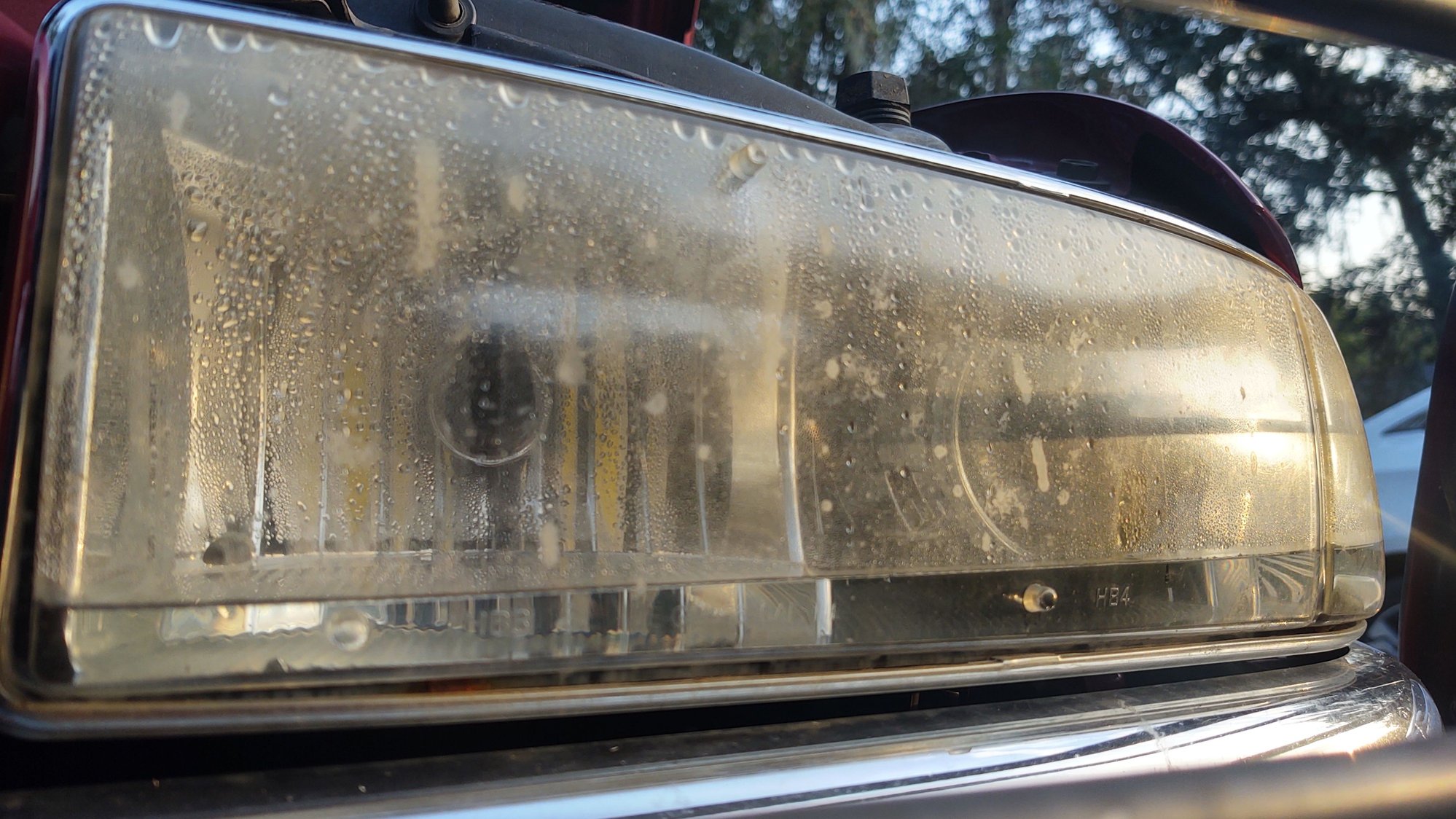

It sort of halted during recent events. Intake gaskets let loose, then a week later my radiator split open, so I've just been focusing on those lol.
But I really need to get them done and installed... As the truck sat for 2 weeks while I hunted down a new lower intake to replace my cracked one, my original driver's side projector retrofitted light turned into a fish bowl lmao. I drilled a little hole in it for now to get by :P
