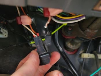

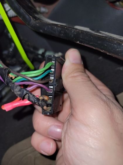

  • INSPECT WIRING
A damaged 'orange' or 'white' wire may prevent power from being sent to the lamps when brake switch is engaged.
Inspecting the harnesses on the brake and turn switches may indicate a wiring fault.
Unconnected orange and white wires seen below should probably lead somewhere...

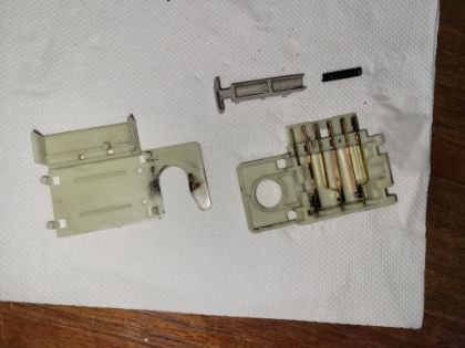

UPDATE! - Fix'd
You're right it was the switch.
So I pulled the brake switch off the pedal and opened up the inside...
These copper pins have circular disks attached where the pins meet. The disks are supposed to make contact with each-other.
I found that the pins weren't aligned properly which meant the disks weren't making contact with each-other.
Bent the pins slightly into the shape so that they make full contact.
Put everything back together and I now have brake lights
Only tools used were a pick and hook set
WIRING
I did check out the wiring before pulling the switch apart.
The power wire looked a bit burnt out which had me concerned...
I put circuit tester to it and it lit up so all works I suppose.
