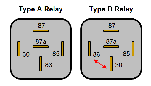

  1. Is the "Fog LP fuse 26 blown?
  2. Is there a schematic picture and a part number on the "headlamp relay ground"? If so can you post them?
There are 2 different types of automotive relays, type A and type B. Pins 30 and 86 are reversed. Both will fit in the same socket.

Old Apr 28, 2023 | 08:51 PM
