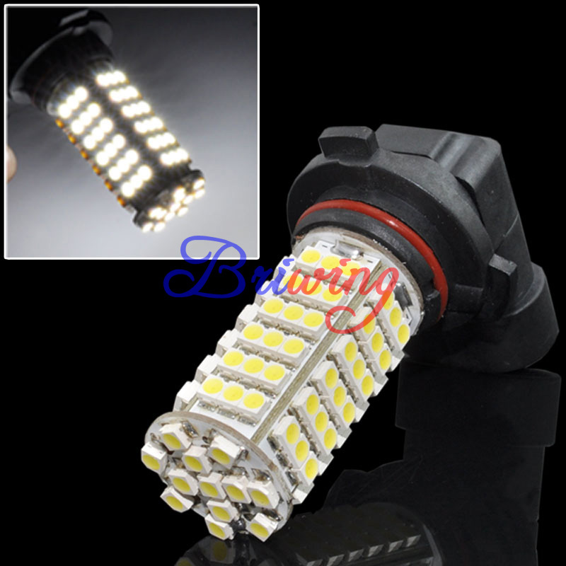

Well, because those lights use high powered leds and have reflectors designed specifically for leds. If you post the pics of the bulbs you are using I can tell you for sure the max lumens something like those can put out, and you can compare it to how many lumens a halogen bulb puts out.
Edit: Ok they probably look like this right?
This paticular bulb has 102 leds. These are 3528 style leds. The most lumens I have ever heard of this style of led putting out is about 1 maybe 2 each, but for the sake of giving the benefit of the doubt, we'll assume they put out 5 lumens each.
So 5 lumens times 102 = 510 lumens. The stock halogen bulbs put out about 1200 lumens, making the led bulbs less than half as bright, and that is not even taking into consideration how the reflectors take the 360 degrees of light and aim them into a useable beam.
The only thing these bulbs are good for is DRLs and nothing else. To get real output, you would need to spend a ton of $$ for something like an offroad led bar, or try to do the work to retrofit one of the new led headlights into your stock headlights (which is unheard of at this time BTW.)
I'm sorry, but physics is working against you here.
Attached Thumbnails Dim 9006/HB4 LED Bulbs-%24t2ec16vhjg8e9nyfnfrhbruzqsst-q%7E%7E60_3.jpg
