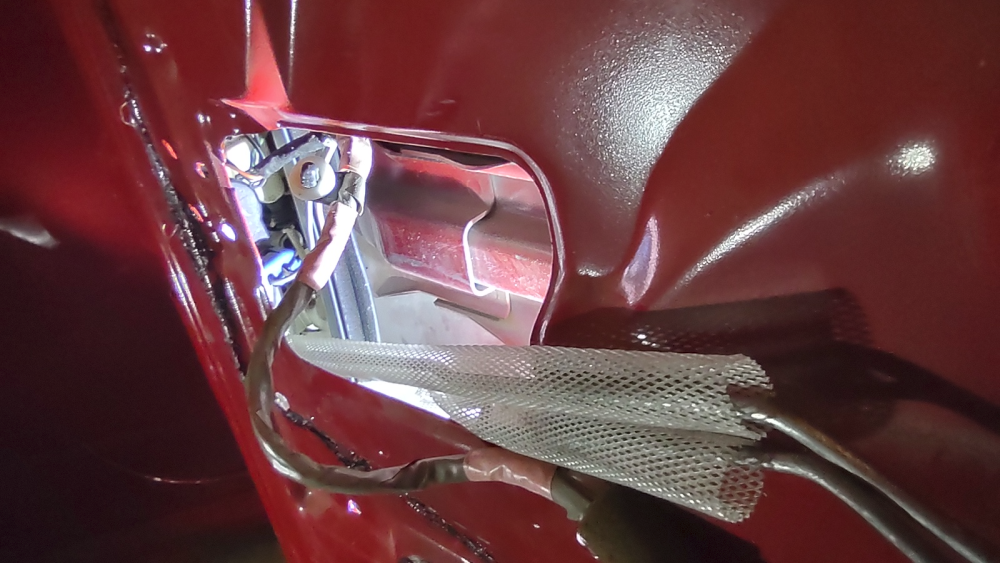

As you say, there's a switch built in to the front door latches that triggers a feature the owner's manual calls "Illuminated Entry". In my '99 manual, it's described on page 2-51. It does not say "if equipped", so it was a standard feature on the year's effected - I'm guessing '98-'05.
The electrical schematic shows the interior light circuit being controlled by wires colored orange and black (standard for decades). I figured if I could pull that plug, the lights would go out if that switch was the culprit. I've gotten as far as seeing the plug with orange & black wires in the top connector on the latch, but it's so tight in there I can't get access to the locking tab to disconnect it.
Left Front Door Latch Access
See new thread titled "Help! R&R Left Front Door Latch"
