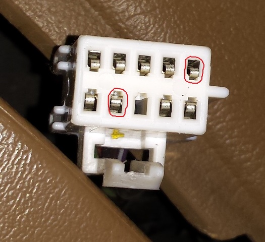

So is there a way to test the switch? I have it out and have power to 2 of the terminals, one on each side of the connector. I'm guessing I could jumper from a pin that is "hot" to one that isn't hot and check mirror functions. The pic shows the hot pins circled in red.

Neither of my mirrors worked completely. I took the control switch apart to clean and re-lube. They have been working for the past year. Hopefully, yours will be similarly simple.
