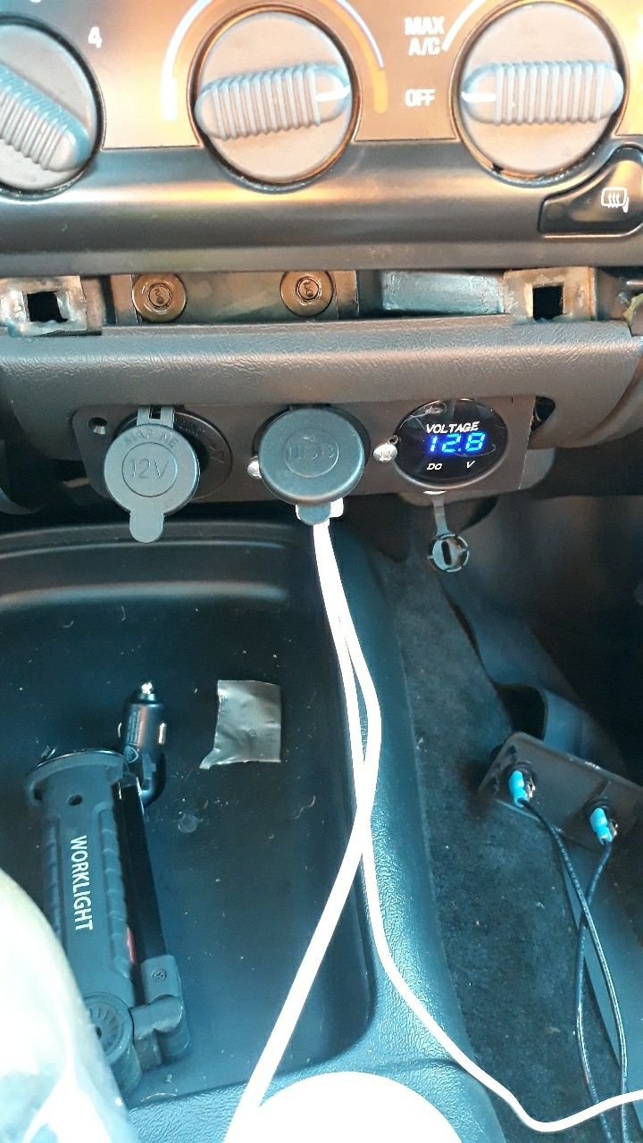

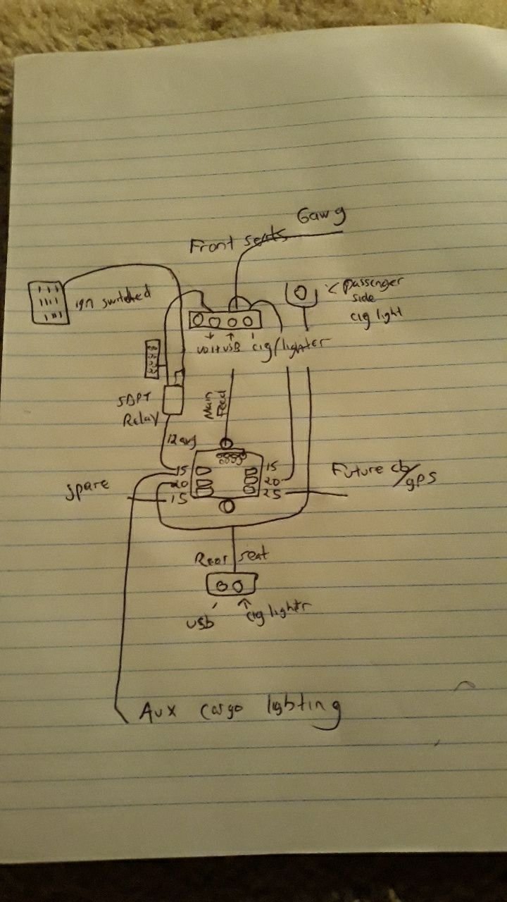

Thought is was time to do some upgrades to the interior for current and future needs. I'm in the process of prep and planning now. I'm open to ideas and suggestions
My mock up on what i wamt it to look like
Most of the materials
Going in astray area. Voltmeter, usbs, cig lighter

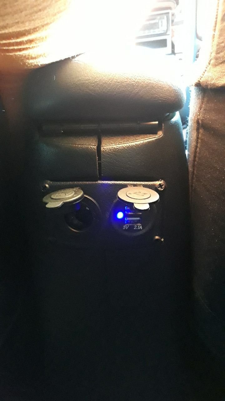

What im hoping to fit in jack area in the rear

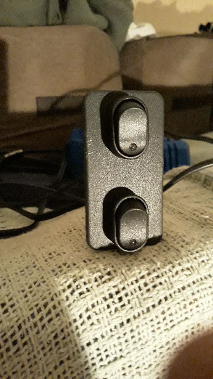

Aux switches in the spare dash plate

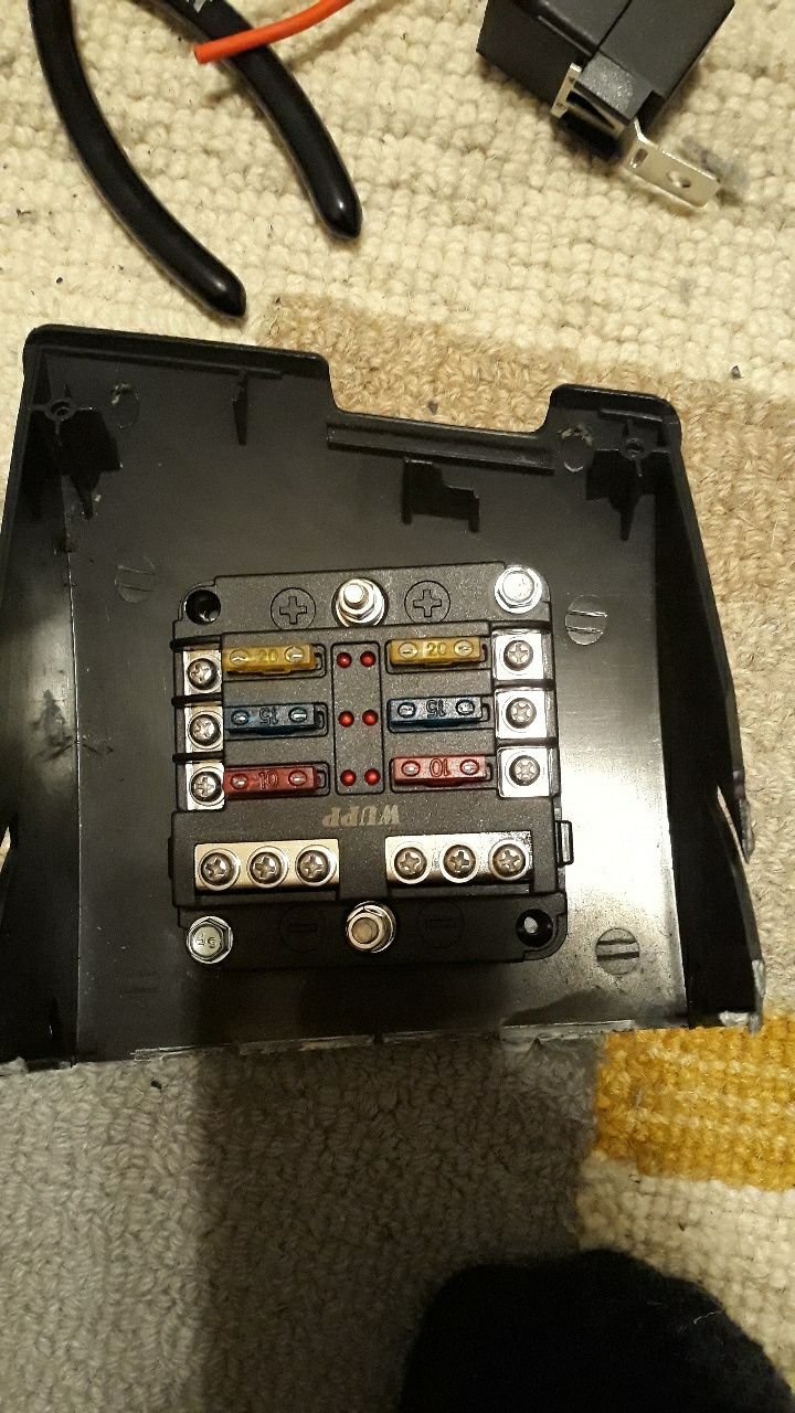

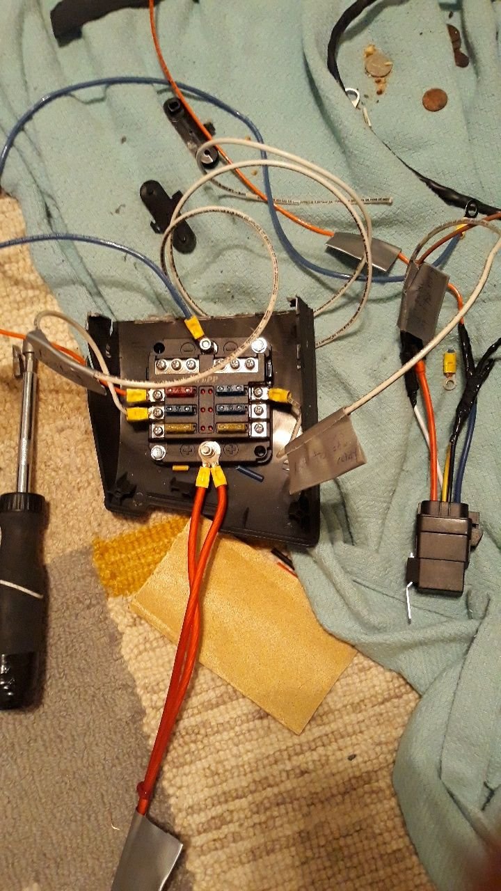

The fuse distribution block thsts going in upper center console, and relay for ignition switched power

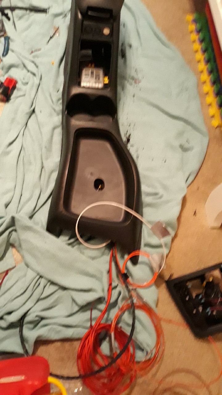

Got more headway on upgrades

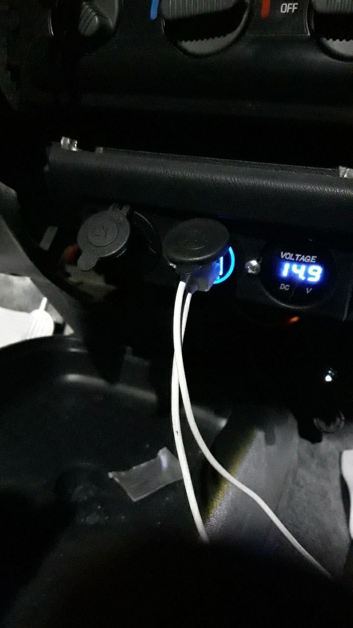

Front cig light, usb, voltmeter
Underside of the center console
Ign power relay
Mini fuse panel
