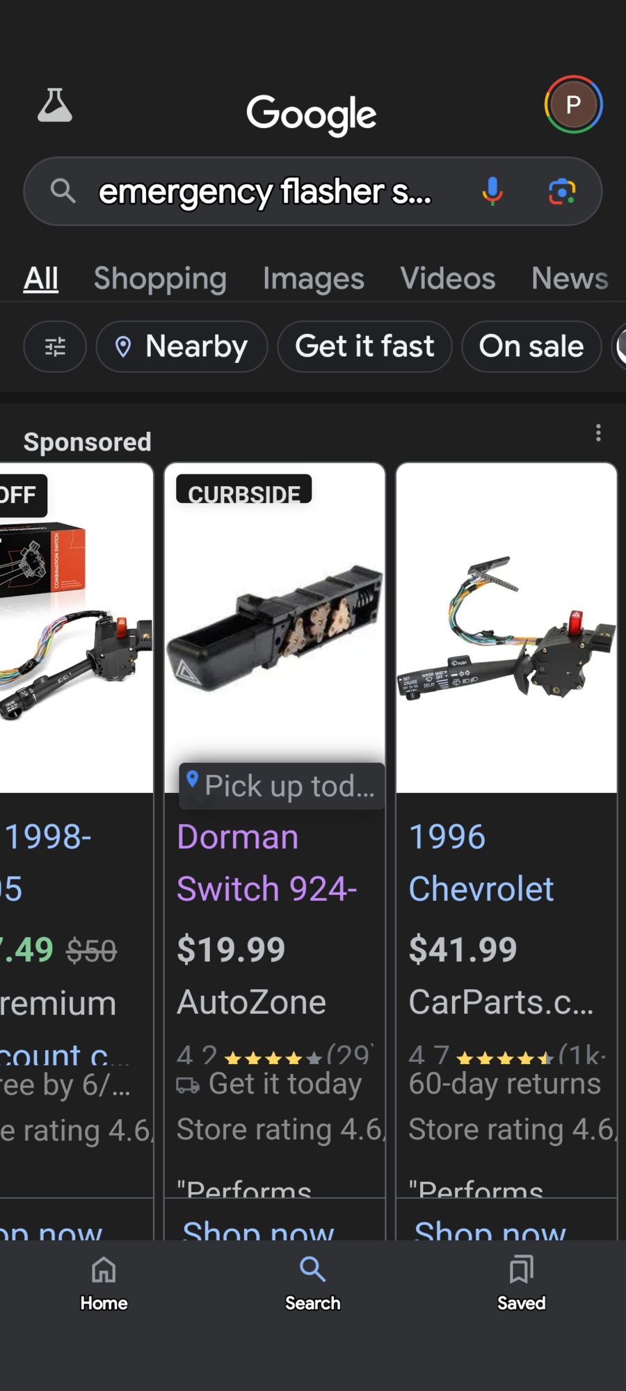

96 Blazer with a broken emergency flasher switch can I just pull out the switch and replace it or will I need to replace the whole mechanism?

It’s an assembly, I have never seen the hazard switch portion separate.

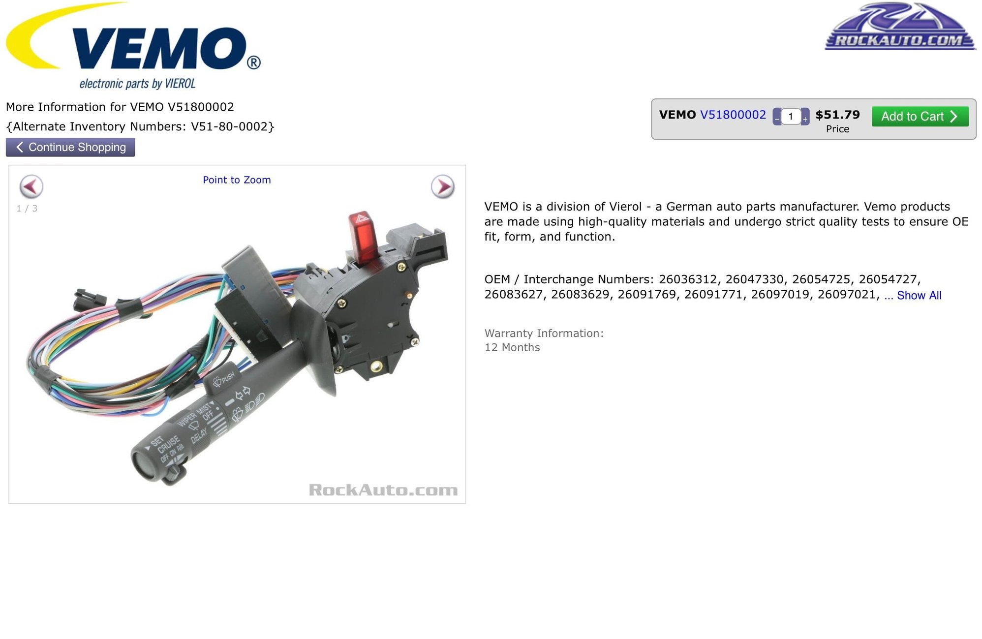

See what I'm talking about?

This this is why I'm confused. I'm just going to start pulling my dash off to get to it. I really wanted to avoid that if possible. I might try disconnecting the battery and see if I can't pull it out with a pair of needle nose I mean it's broken anyway right?
