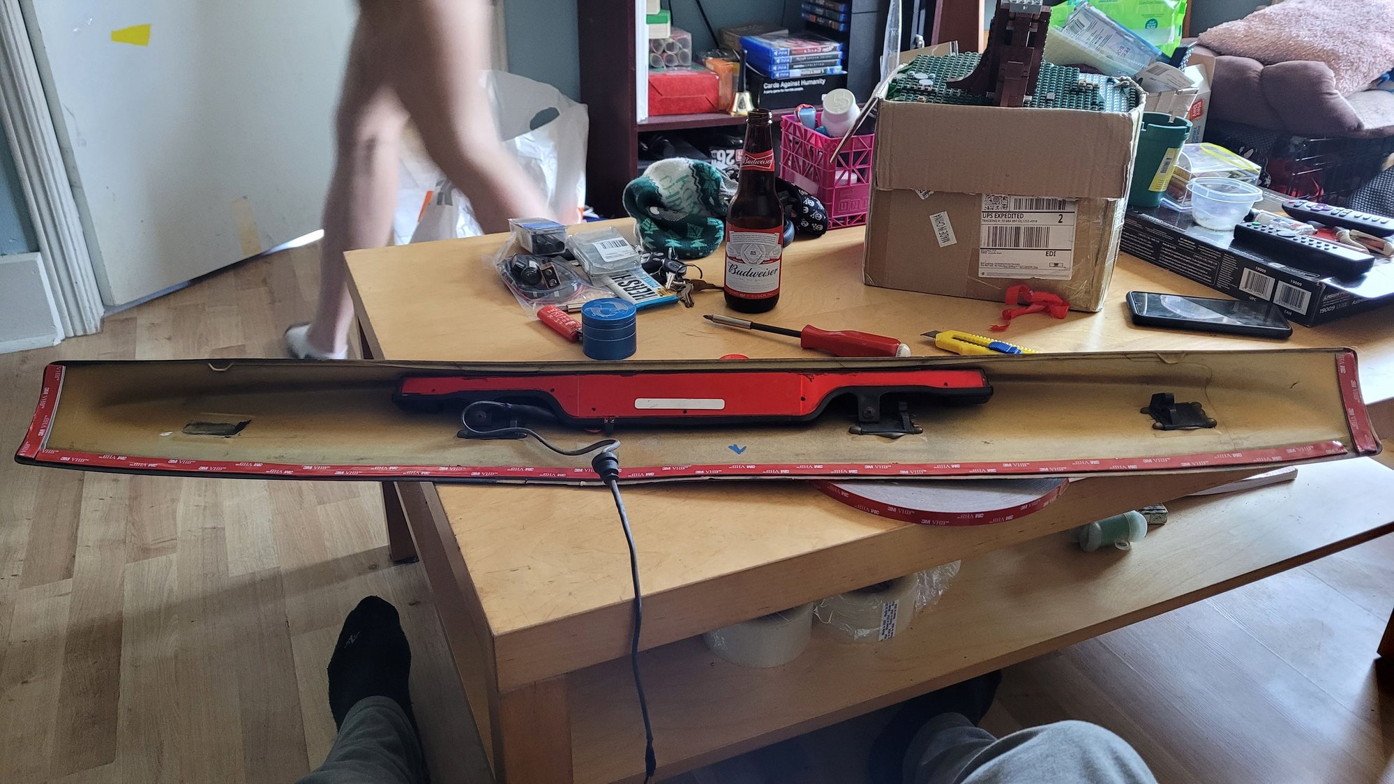

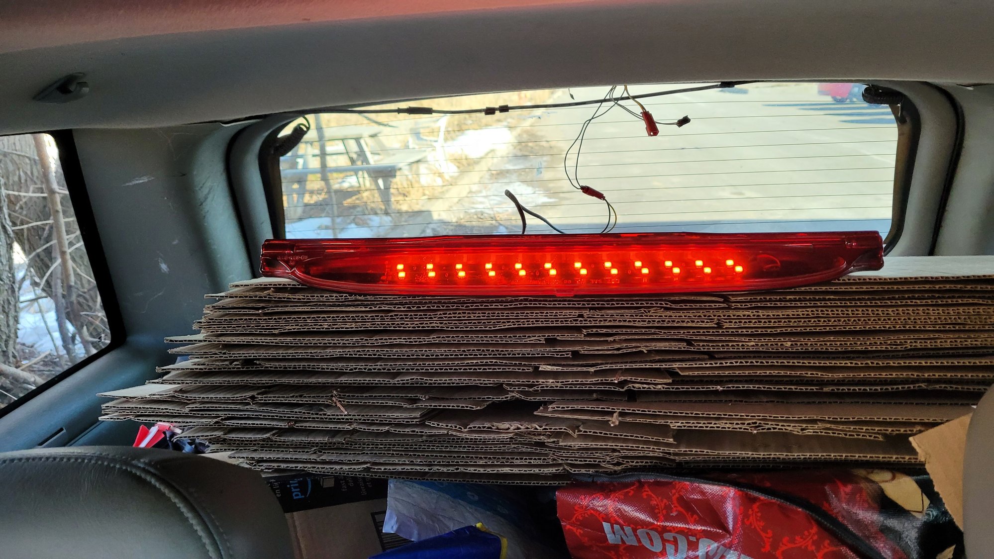

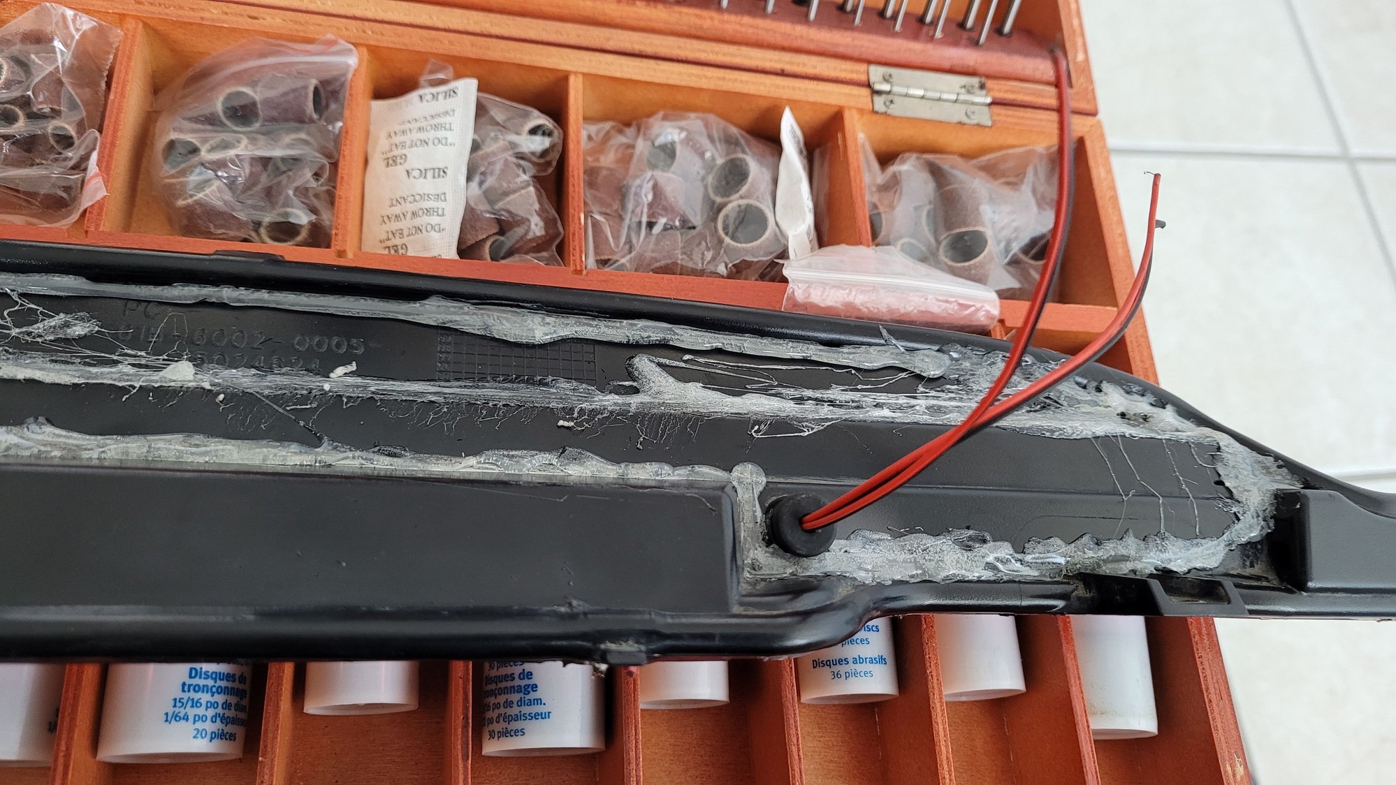

So I haven't finished the wires pr hooked them up yet, but I got the strips inside the spoiler housing.

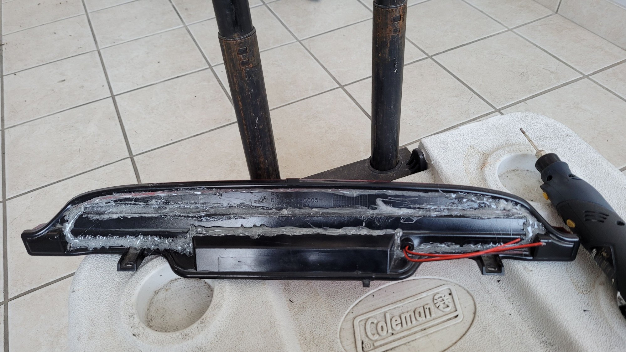

I couldn't get it hopened, so I cut access into it through the back, I should've made 1 cut, but I made 2 not thinking. It's not the prettiest, but its sealed, and won't be seen lol.
Two piece shouldve been 1, the dark part on the inside is the back of the chrome reflector for the neon
The balast for the neon
Glued back together

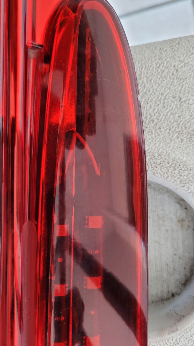

Leds. One is on the chrom reflector. The other is on the cut of piece
Grooved the chrome piece a little for the wires to sit, noticed when i put the back on, they were getting pinched.
Rubber vent cover from thw back of the light ficture, drilled out center for wires
Really tight fit to get the rubber back in with the wires, but just enough to keep everything snug

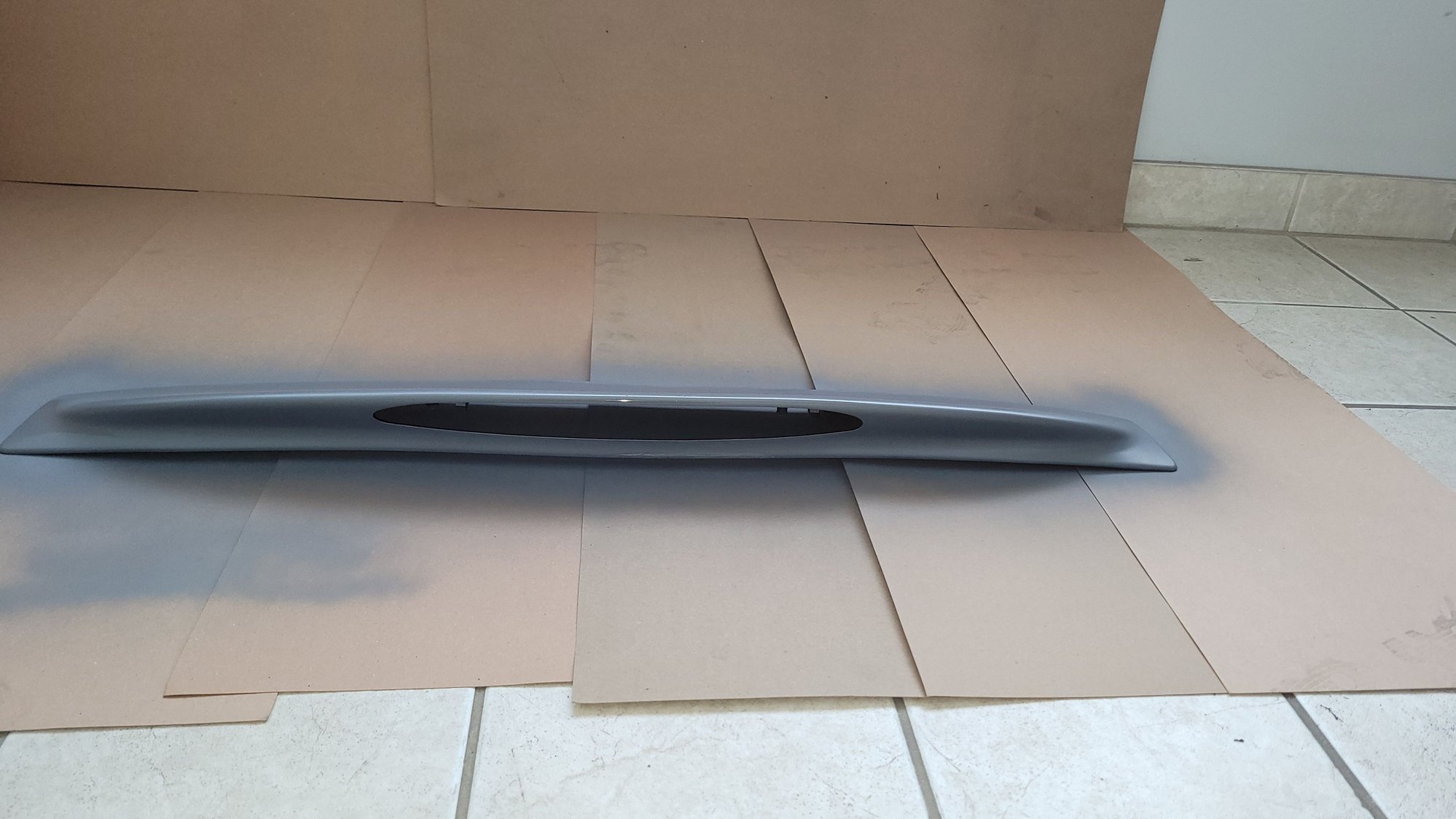

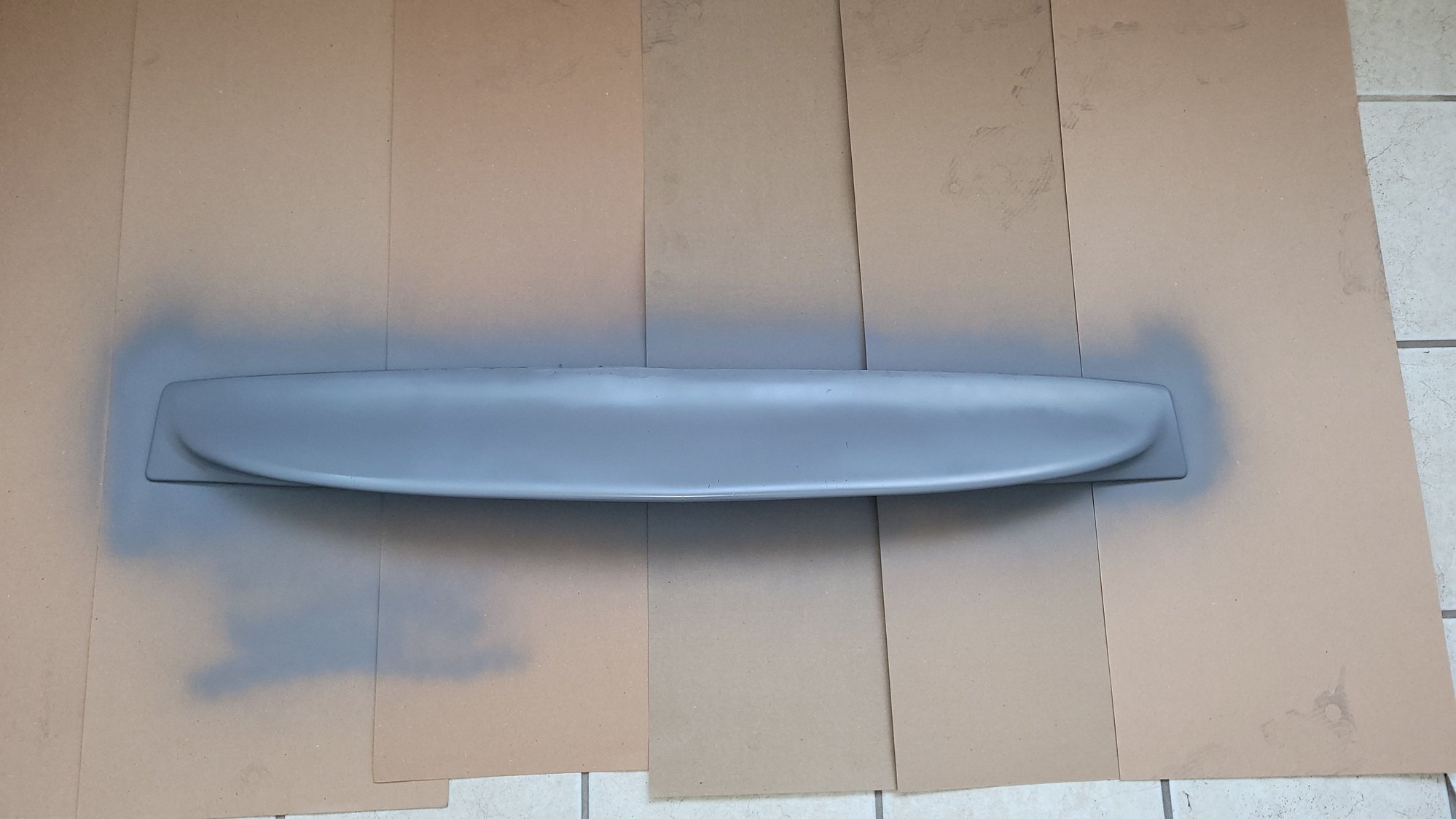

Will prime and paint the spoiler today, and put it all together hopefully over the weekend.
Edit: primed the spoiler
Old Mar 4, 2021 | 01:40 PM

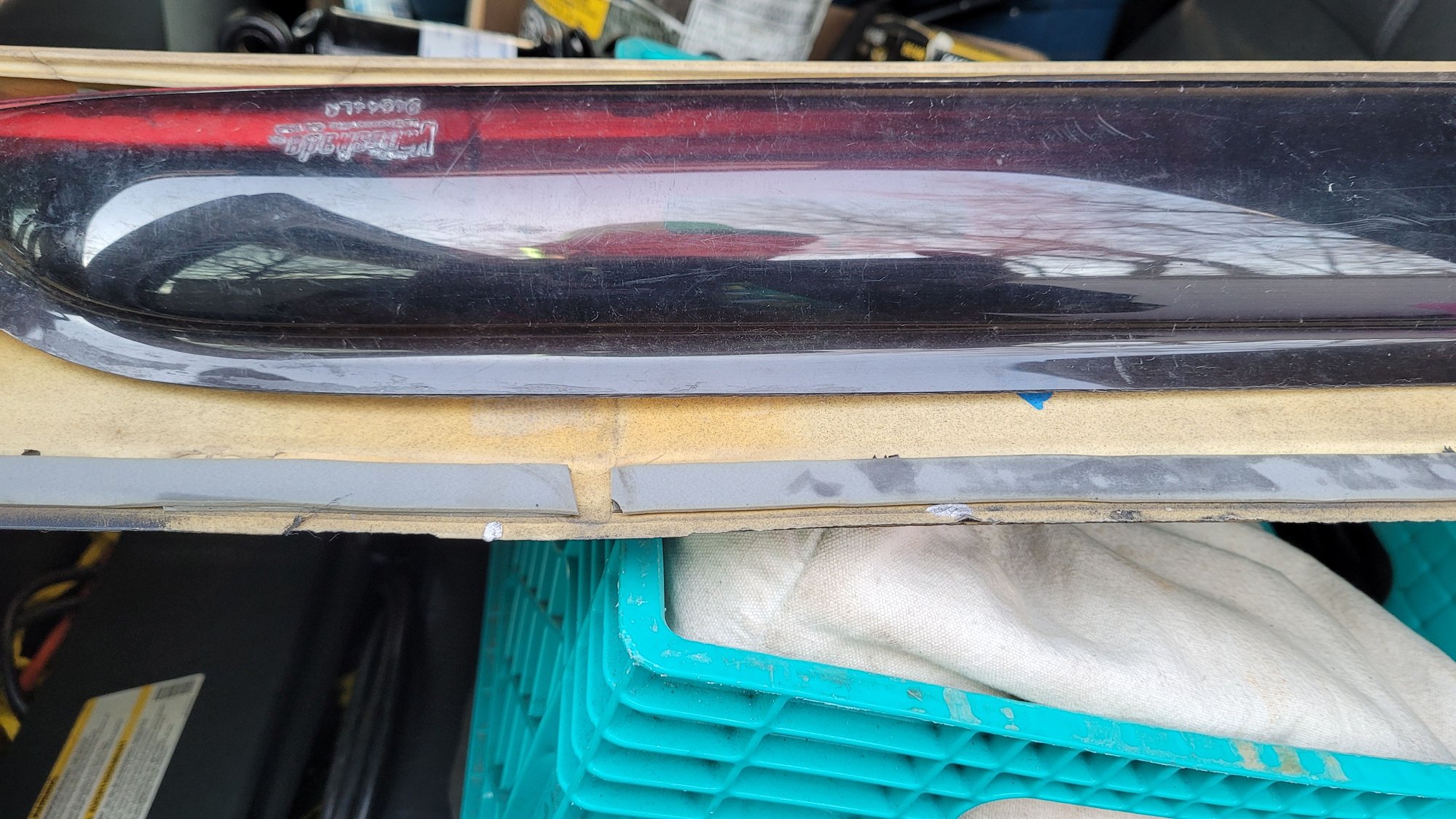

Painted, taped, and going to install on the blazer, I left enough wires and it accessible to add the roof third light when I get one to replace it lol.

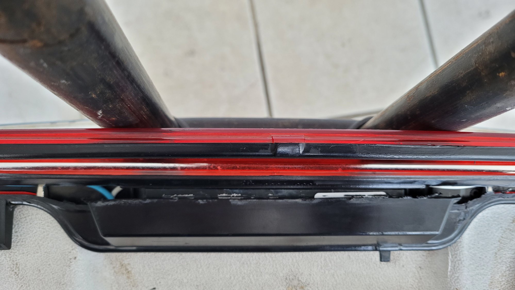

Went to install. But ran into a couple of things. Hopefully will have time to tackle over the weekend.
Placed on st patys day

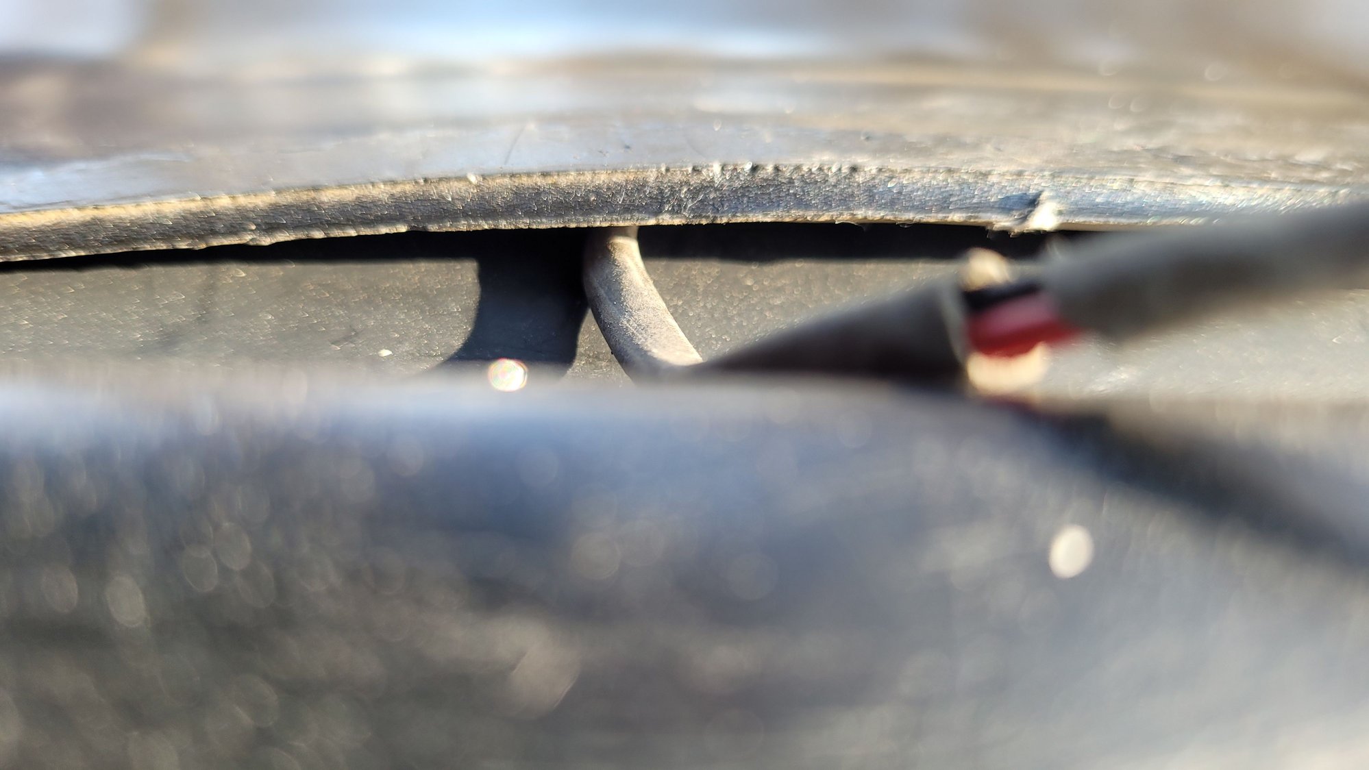

Will have to cut about 1" back from the edge to fit, or drill a hole
Can kinda see the lines i made. Might drill a hole, but will need a uv protected guard around the wire going to the body.
Left a gap in the tape for the wire, but no go. I could build up to the height of the wire, got it doubled so far.

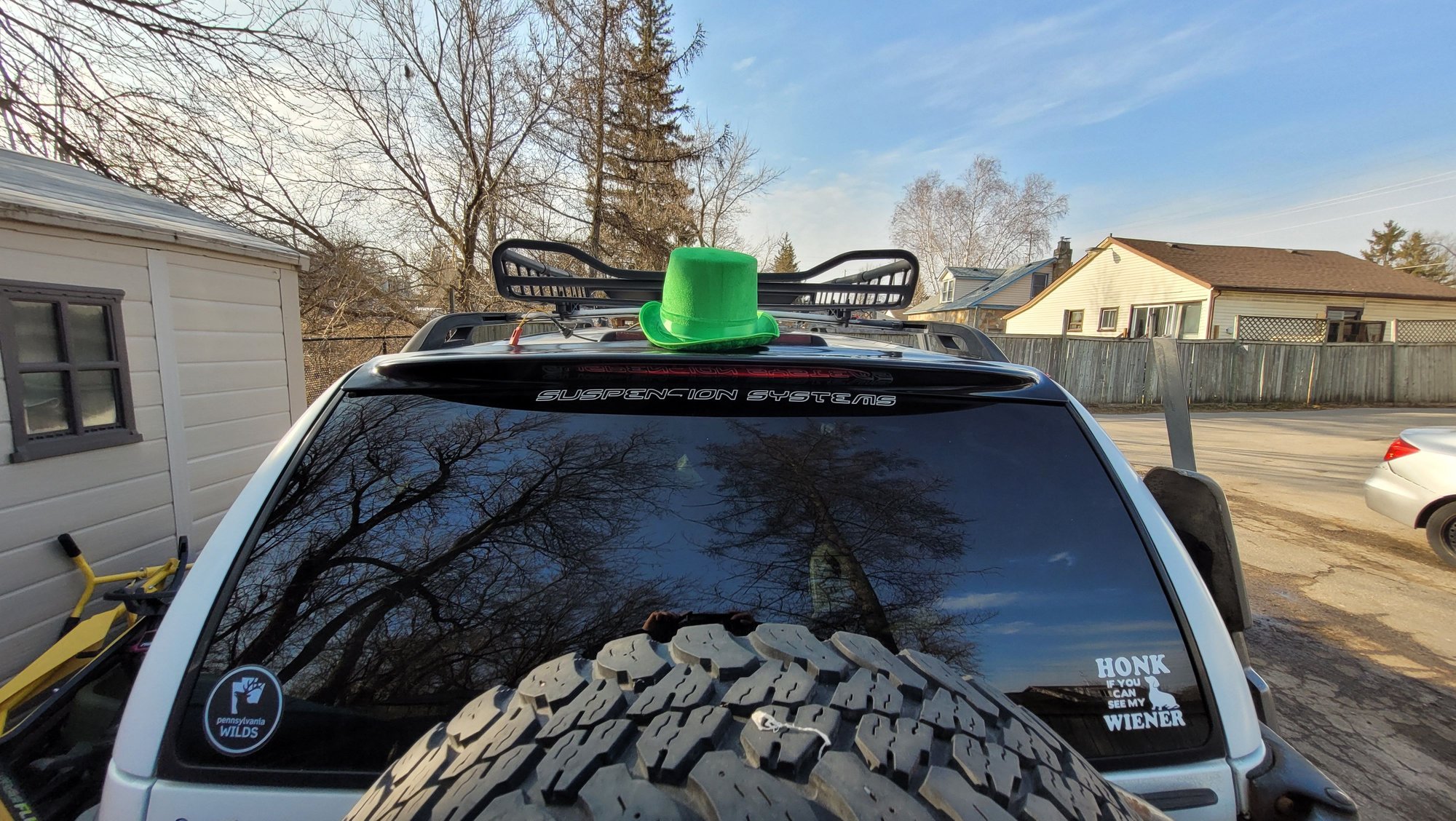

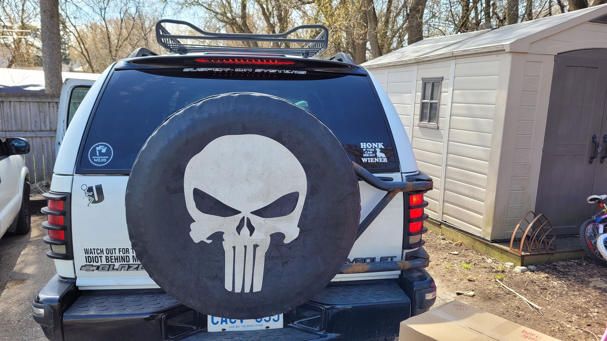

Old Apr 21, 2021 | 06:28 PM
Not too bright, but works. Dont mind the bad driverside light, bad ground, works qhen the right turn signal is on lol

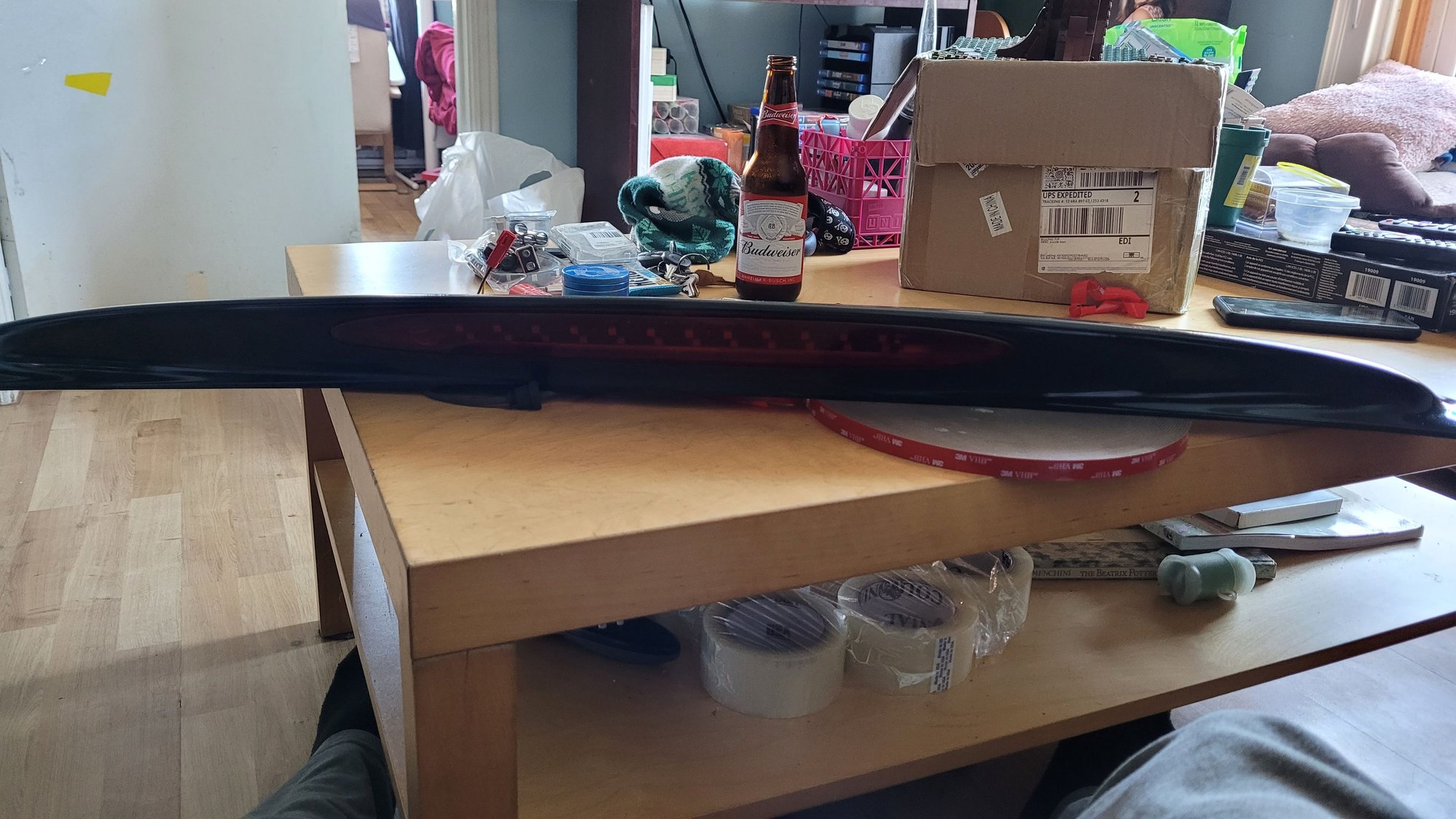

Old Jun 22, 2021 | 02:53 PM
So since then, I've notice one strip start to sag out of place lol.
Time to look into some brighter strips and glueing them in place this time lol, or maybe gorilla double sided tape.
