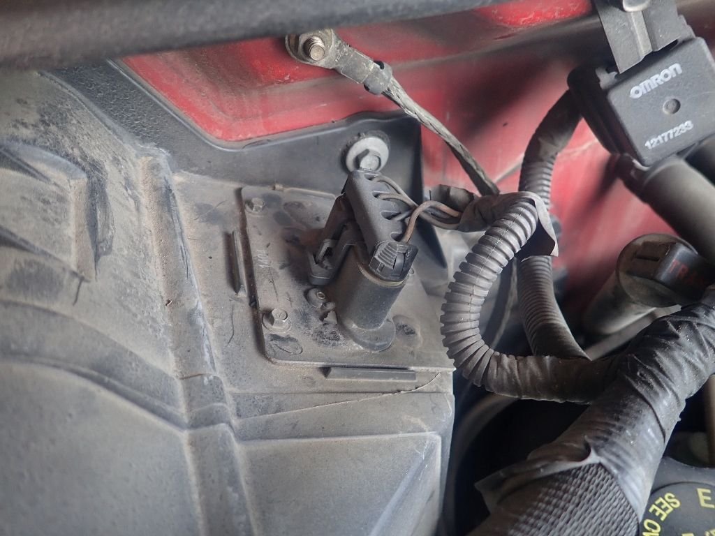

Here's the blower motor resistor, mounted near to the fan on the firewall.
It removes with one electrical connector and three hex screws. Easy peasy!
