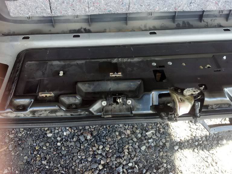

There is an access hole just under the top middle section of carpet on the inside of the tailgate. There is a small arm in there that you need to push to the side to unlatch the window. You can see it here with the carpet removed.
It's the little goldish arm in the hole there.

Thanx!! got the back glass and tailgate working!! But still have an issue with lock button not releasing glass. Works from dash button but not from rear lovk button. Any ideas?
