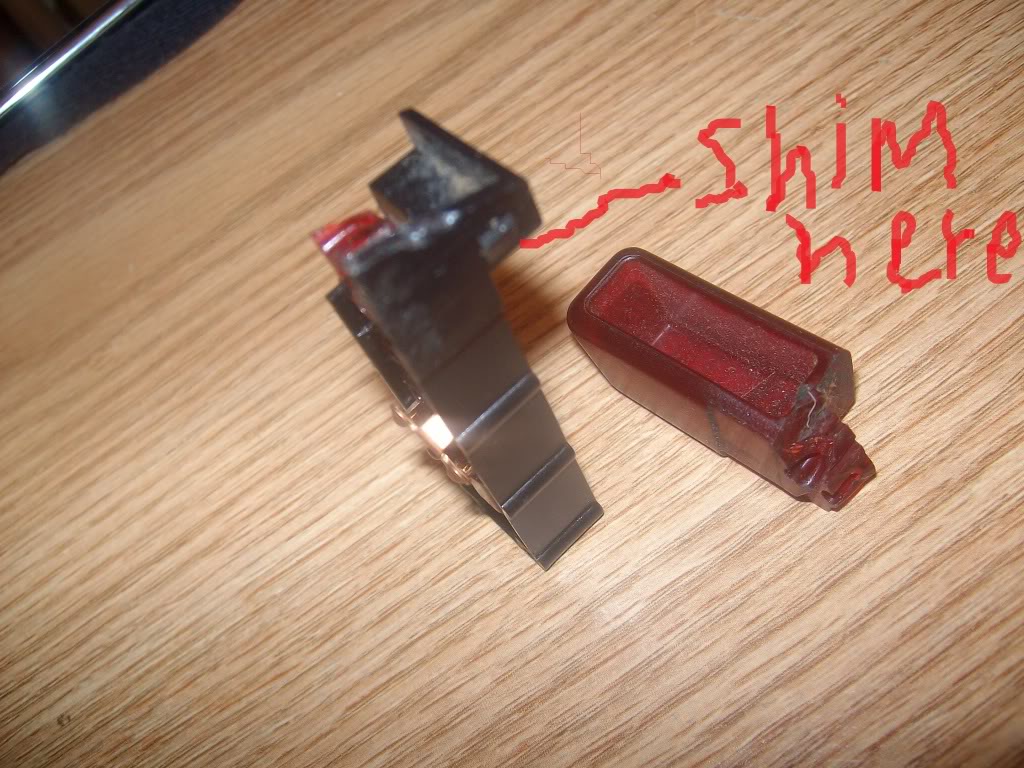

ITs either the hazard switch or the multifunction switch. Id pull the hazard switch to see if the connection is clean and not melted.
This is how you remove it. Broken Hazard Switch Repair How-to - Car Forums and Automotive Chat
What you do is get a very fine screw driver and pry the back end of it gently so the lock tab gets pushed. Gently pull the switch and she should slide out.
Crappy picture but you can see the lock tab from here.

I removed the switch and then a spring (I assume?) flew out into the darkness never to be seen again. lol
The connections look clean, but flimsy and worn out on the plastic post (a red, one piece component). I managed to place it back in to where I have working flashers at least. I guess I'll buy a new switch and hope that's all it is. If not I'll google how to replace the mutli-switch.
