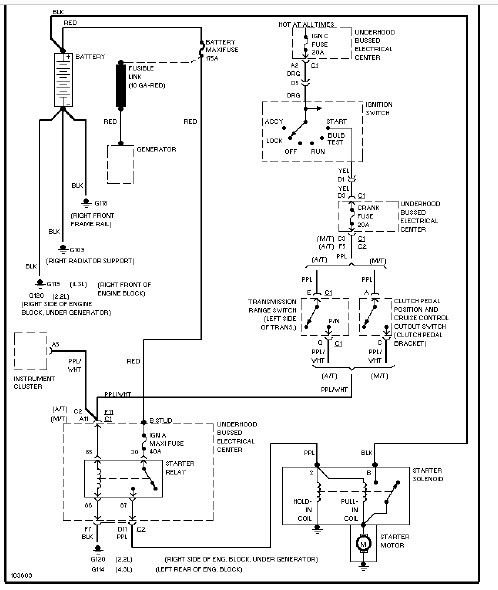

So the motor will not crank or start until the scanner is plugged into the ODB port, correct? This one is bending my electronic and schematic knowledge to the max. I'll start working through this one. In the meantime we should measure where the voltage failure is to prevent cranking with no scanner. It doesnt matter which end you start with but because your at the steering column with the scanner lets start there/ With the ignition key in the crank position do you have 12V on both sides of the Crank fuse, 20A in the UHFB?

Crank fuse reads 0.04 for the crank. I should also mention that I don't hear the fuel pump engaging when I turn the key to the on position. Didn't notice it before

OK then this part of your problem is relatively simple. Its either the power into or out of the ignition switch during cranking. Next test both sides of the Ign C fuse, 20A in the UHFB. if you have power out of that fuse on the way to the ignition switch on the orange wire then its the switch, its wiring or connectors. Just for sh&*s and giggles, try moving the ODB connector around without the scanner while you try cranking the starter.
