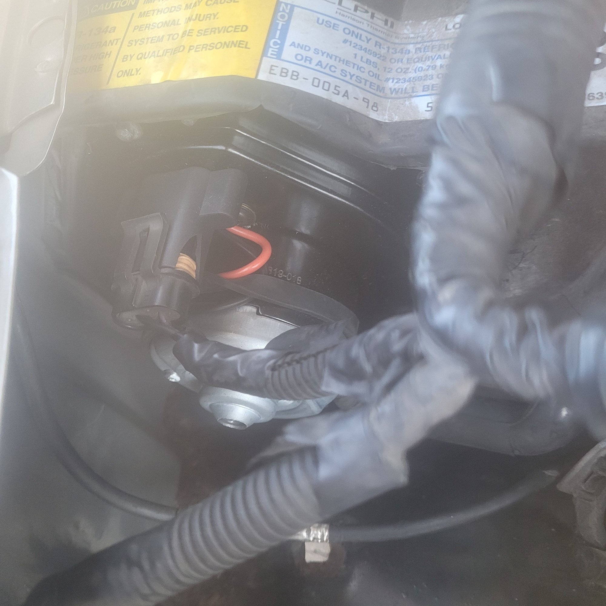

This is the 2nd new blower I got , the first one said continental and it shredded the fan as soon as I turned it on and the plug wasn't right but I forced it in to work. So I spent time thourally looking for another one online and wanted one with a white fan so I didn't get the same black one that broke and got one from parts geek for $50 and was successful. The only bad thing is the plug had a peice broke off but insignificant. Also It seems like such a difficult job when you watch the you tube videos since you have to cut the plastic/rubber over it and the ECM and coolant tank have to removed and some screws on blower are hard to get at but I simplified it to the extreme. I only put one bolt in for ECM and coolant tank since they just rest there, and only put 3 screws on blower that are easy and **** on the other 2 and pissed on putting the outer piece back over it so it was about a 7 minute job for me the 2nd time and is good to go.
