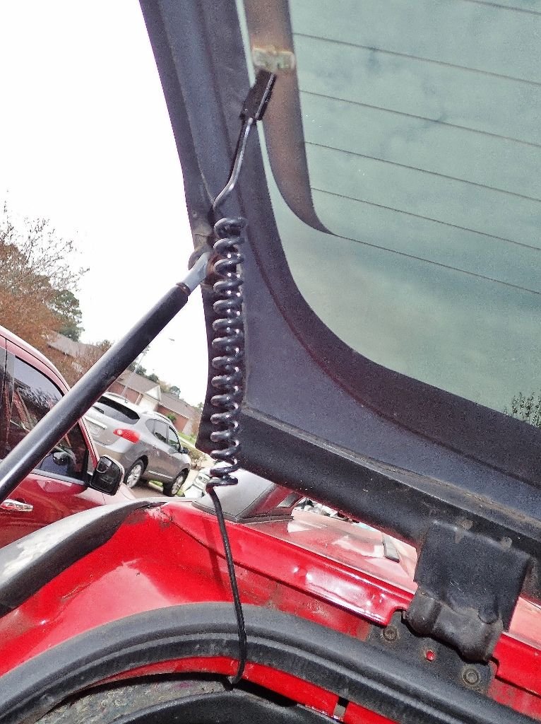

"Clamshell" rear: the window hinges up, and the tailgate hinges down, like a clam. Look! You can see the Eiffel Tower's reflection in the window! Viva la France! Actually, that's a cell phone tower. And the bottom right corner of the window is not curled up, that's a reflection of the corner of the building. The license plate number is photo-edited to be fake.

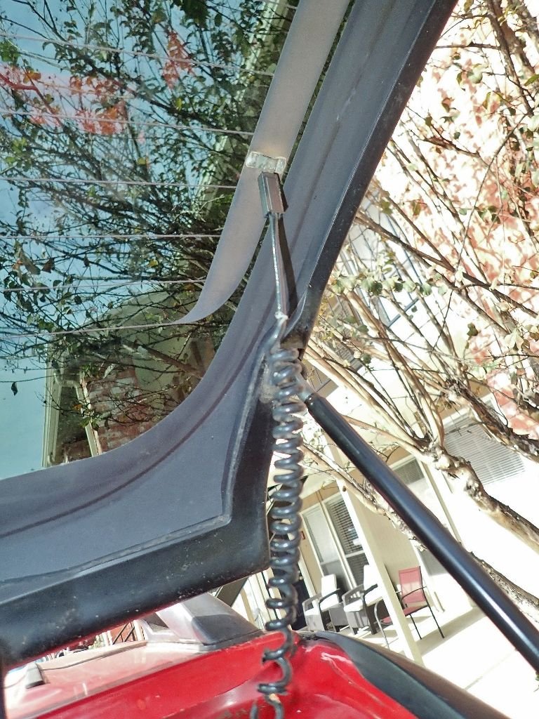

The window has a wire grid embedded in the glass, and wires running to both sides to make them heat up to eliminate fog and ice.
The power cords are coiled to allow them to flex as the window lifts up and down. One electrical connector to the glass wire grid, and another underneath the headliner.

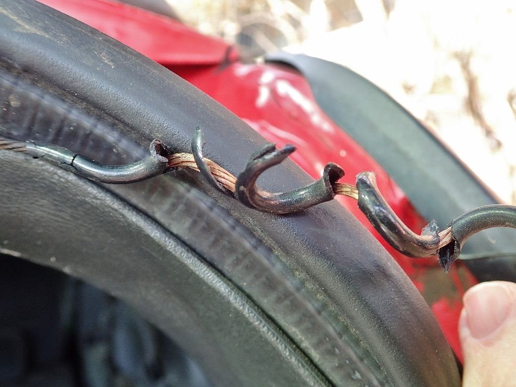

After 20 years in the Texas heat, the wire insulation has become brittle and is crumbling into pieces as it flexes, exposing the bare copper wire on the inside. That can't be good. Short circuits, sparks, fire? Nah, I don't think there's that much voltage here. But it ain't right.

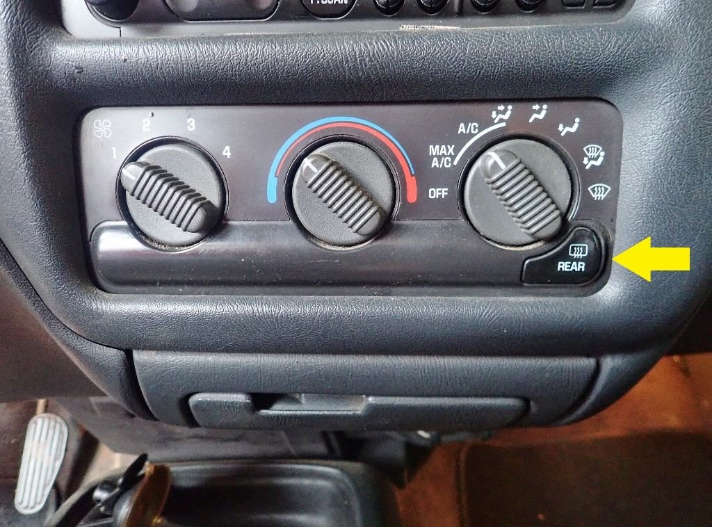

Tested by pushing the rear window defogger button. And they work!
