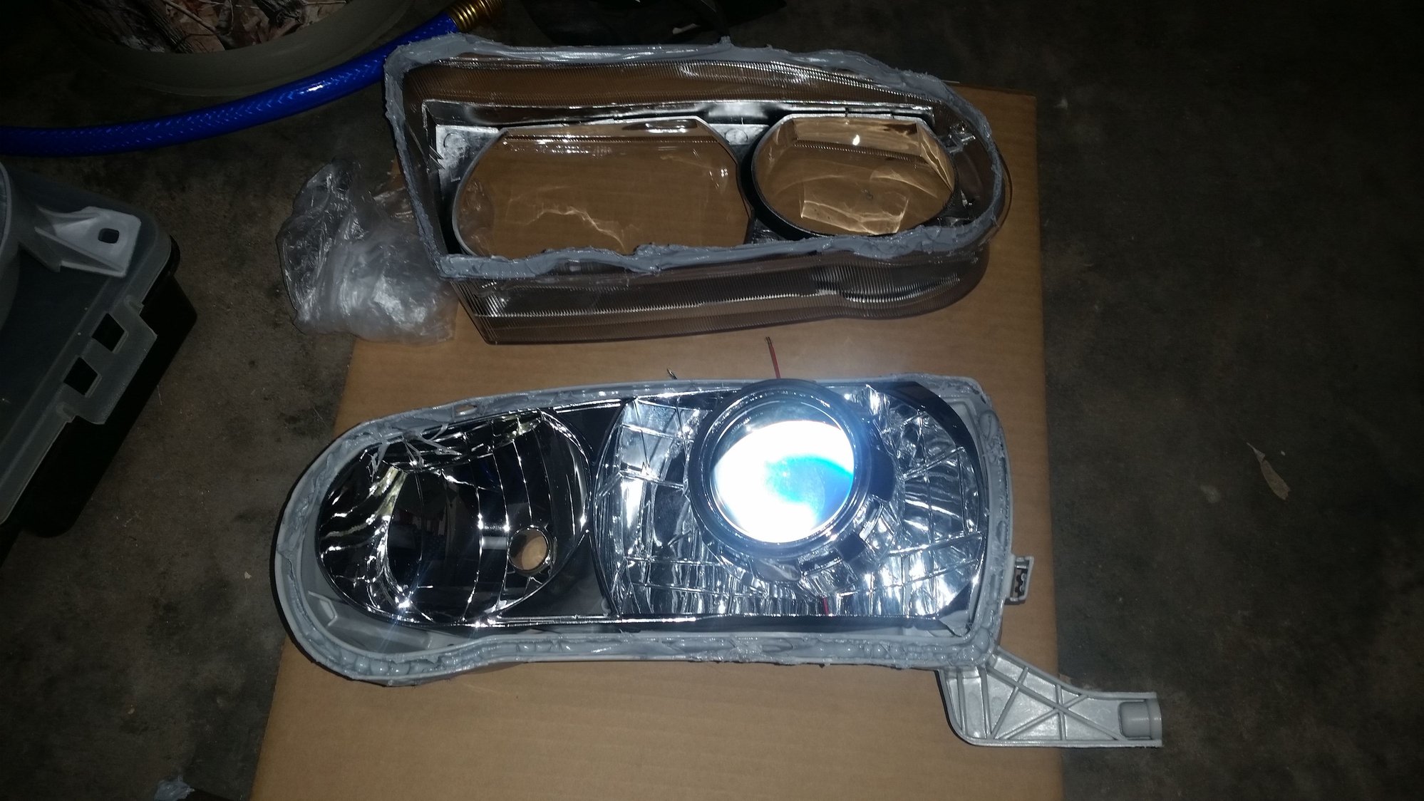

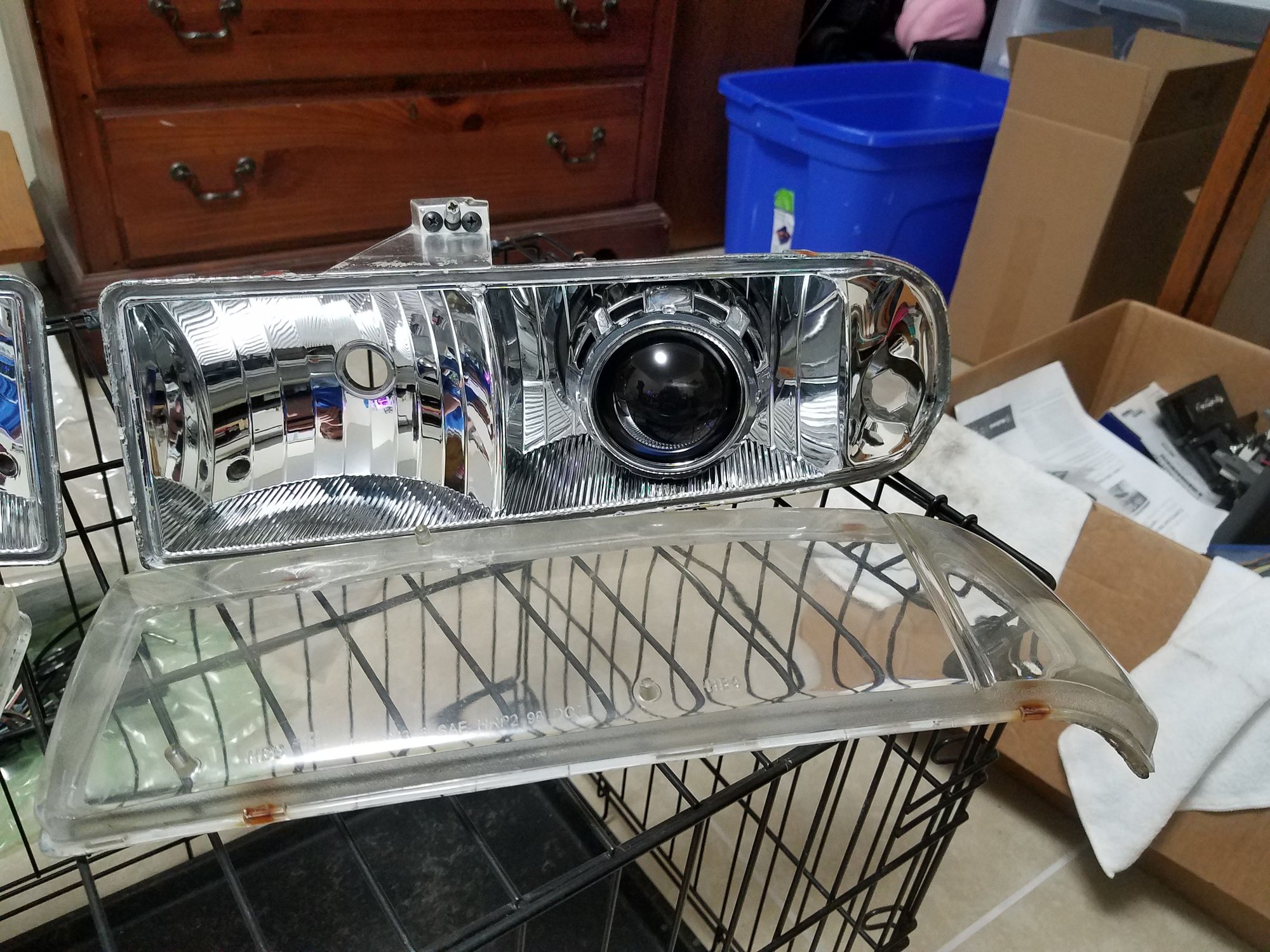

New bulbs come with new seals (at least the high and low beam bulbs do, the marker light has the seal on the socket itself). You should be able to buy new bulb sockets for the small marker light in most parts stores and just rob the seals from them for your existing sockets on the truck, if you suspect that to be the leak.
It's uncommon with stock unmolested lights, but it's possible that the seal between the back half and the lens is letting water get in. I say "unmolested" because the only time I've ever had water get in through that seal is after removing the lens from the light (opening it up, for a modification of some sort) and then trying to reseal it when reassembling. If you suspect this seal to be the cause, you could disassemble the light (pull the chrome trim ring off, it's just snapped into place, and pull the 4 metal clips around the light off), clean the area where the lens meets the back half very good all the way around, and apply a bead of clear silicone all the way around, being sure to work it into the crevasse between the two parts. Then reassemble.
The only other possibility is a crack in the housing somewhere that isn't immediately obvious. Check around all the mounting points, as that's typically where the cracks will form, because those areas see the most stress just from vibrations from driving acting on the mounting bracket holding the light in. Again, not super common, but a possibility none the less.

You could always try dunking them in water to test the lens seal. Clean up the bulb areas and put some tape over them (electrical tape, duct tape, anything you can make a good seal with temporarily). Fill the bath tub up, hold the lights lens facing up, and dunk them in and hold them under for a little while. Watch for water creeping in on the inside. If you get them dried out before hand, even better, because if they're dry when you start but there's water inside after the dunk, you have your answer.
They're not easy to separate, it's a process, but the lens does come off. What I was suggesting is to try and apply some silicone to the outside edge along where the two halves meet without removing the lens. Prying the two halves apart on older lights is more difficult than doing it to new ones I've found out. The only thing that I can assume is that heat cycles over the years makes the sealant more resistant to loosening up. I've broken my fair share of older used lights trying to open them up, however I've never had too much of an issue separating and opening up brand new lights.
