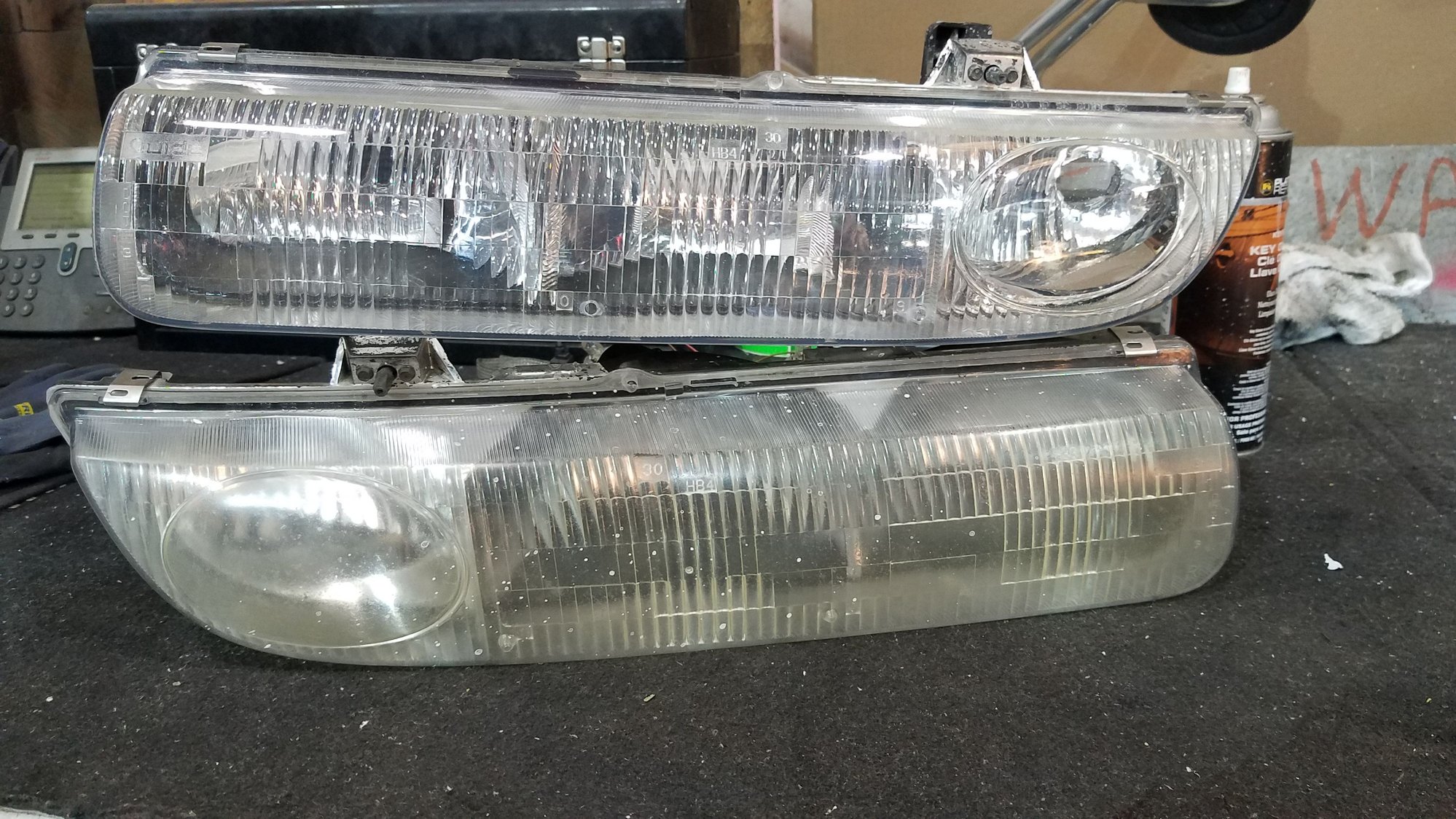

Yeah you would be surprised at just how much light gets blocked from faded and yellowed lights.
I took my old 98 Saturn headlights out a while back, brought them into work, wet sanded and buffed them, and it was a night and day difference (no pun intended) in both just the looks of them and the light output.
Even did the same with it's fog lights lol
