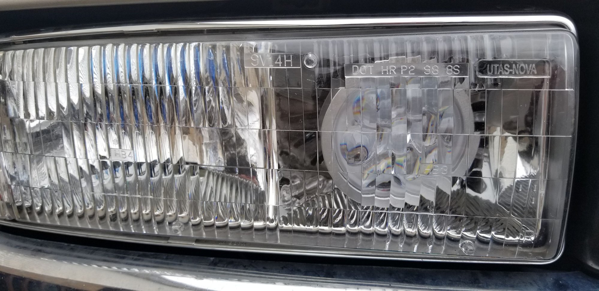

I baked the covers off and replaced the high beams with these 5 beam LED projector...Love Them critter spotters, went from lethargic to satisfied
