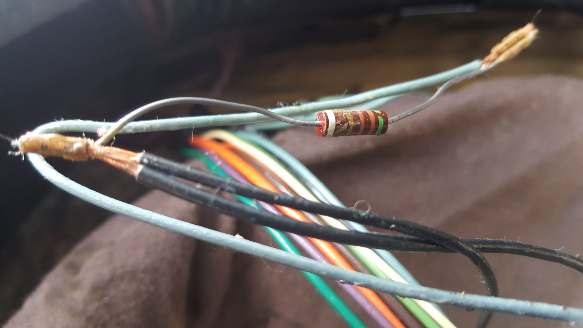

I since found tail loght wiring loom.
It is hidden behind a vouple o plastic covers and runs up over rear door glass.
I had to remove a couple of the plastic covers and unplug rear interior light unplug rear glass defroster and rear brake light strip plugs to be able to bring loom out and into a space i can give it a good looking over.
i found an interesting man made nest with a ? Diode fitted between right rear live brake light wire and the black earth wire.
Has anyone encountered this before.
thanks

That looks like a resistor. Do you have LED tail light bulbs?
oh ok. Wondered what it is and why its there.. thanks Tom..
I have a problem with 1 tail light not workin when i push the brakes so tried to find a short and come across this resistor
no LED tail lights either Tom
