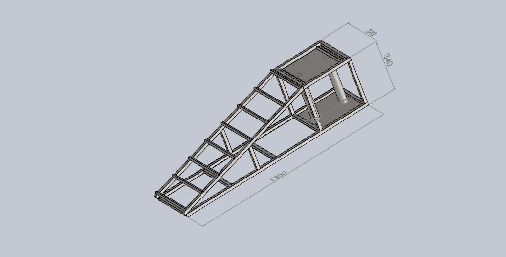

I've also recently got a decent welder. I am thinking of welding a set of these as a first project:
I may post a list of materials if You like. Below the end plate are a profiles (top one goes over above the bottom one), so they make sort of a telescope and could be jacked even higher. They are going to be horizontally drilled through, so that You could put a locking pin through.

that would be the perfect project if you can pull it off,i get so tired of using a jack for my car,my truck doesnt need one,i need a ladder to get inside it LoL.
