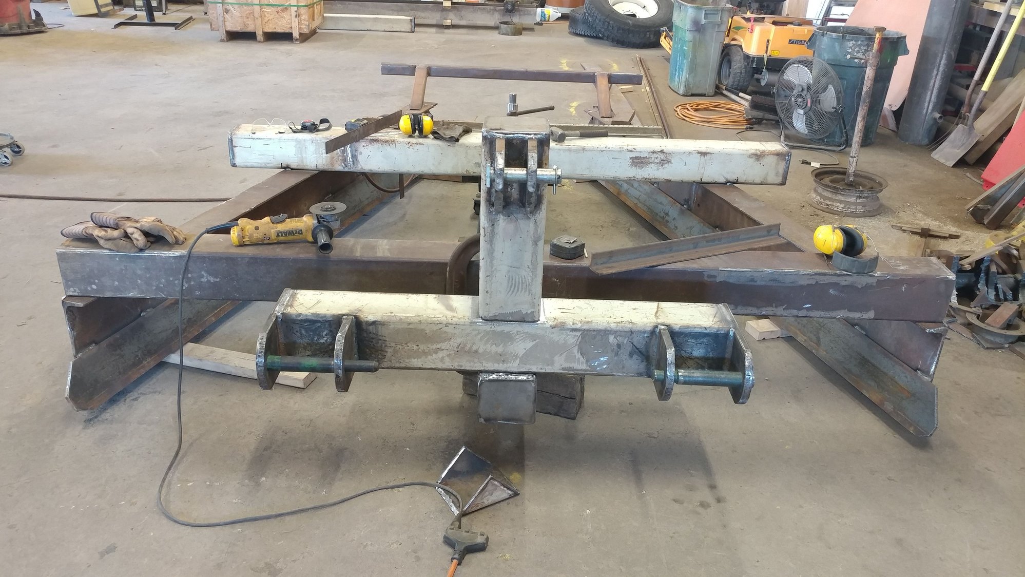

Combination drain tile stringer & trench closer fabrication. Mostly scrap steel.
All together & checking operation. This ended up being too heavy for our 6xxx series tractor so we ended up just using it as a 3pt hitch mounted trench closer.

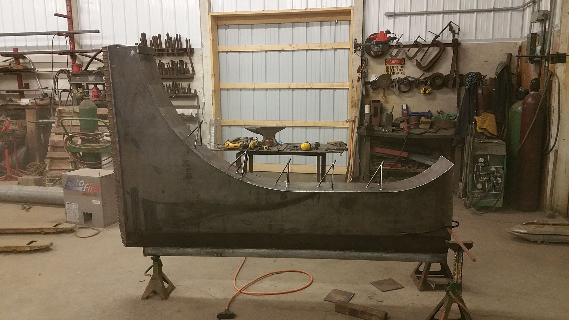

New 8" boot for our tile plow
New 4" boot for our tile plow. Old boot installed 3.6 million feet of drain tile 36" deep or deeper.

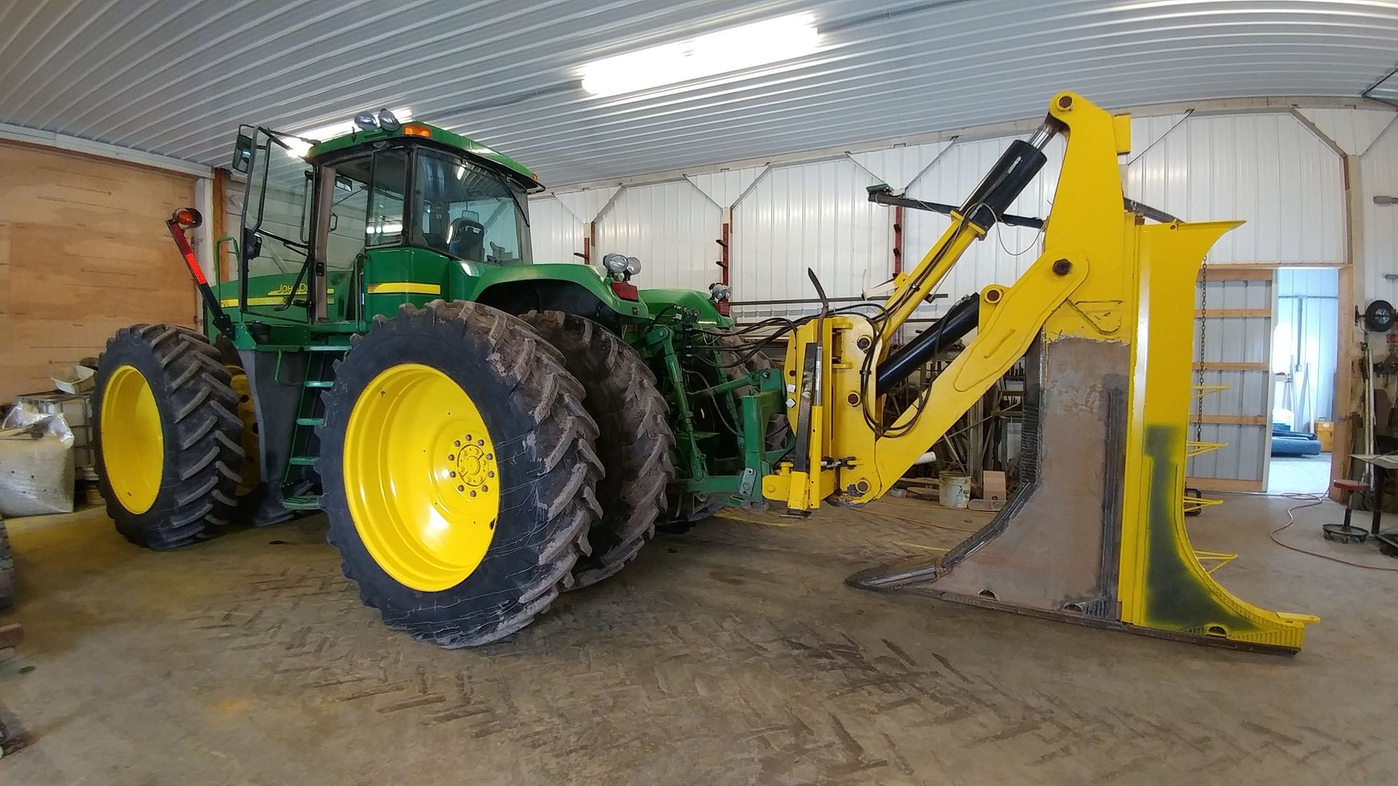

An in process picture of the plow hitch I redesigned & rebuilt a few years ago and is still holding strong. I had to reclaim the horizontal brackets that house the bushings for the 4" diameter pivot pin and keep all 4 of them in proper alignment while I burned everything together.

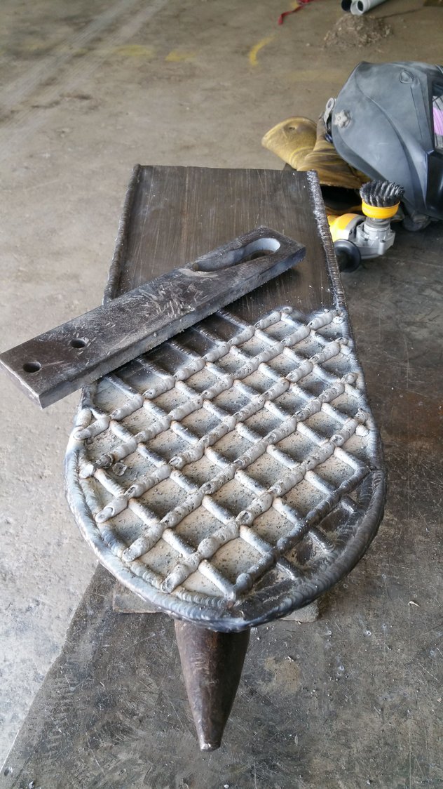

Hardfacing on 1.5" thick 9" wide AR500 plow point. The cross-hatching on the top captures dirt & extends the life of the point.
I will lay down 5-6 layers of Lincore-55 on the underside of the point to provide better wear resistance than the already fairly wear resistant AR500 that the point is made out of.
I use a L-tec 250 (made by Esab) at the shop and have a Miller 211 for my garage. I vary from 75/25 argon/co2 to 90/10 at the shop depending on what I'm doing. Even though the hardface wire has its own shielding, I still run 75/25 over it because it makes the weld harder which is the purpose. For everything else I run 90/10 because I hate splatter and since we are rarely welding on clean new steel, the 90/10 helps control the splatter.
