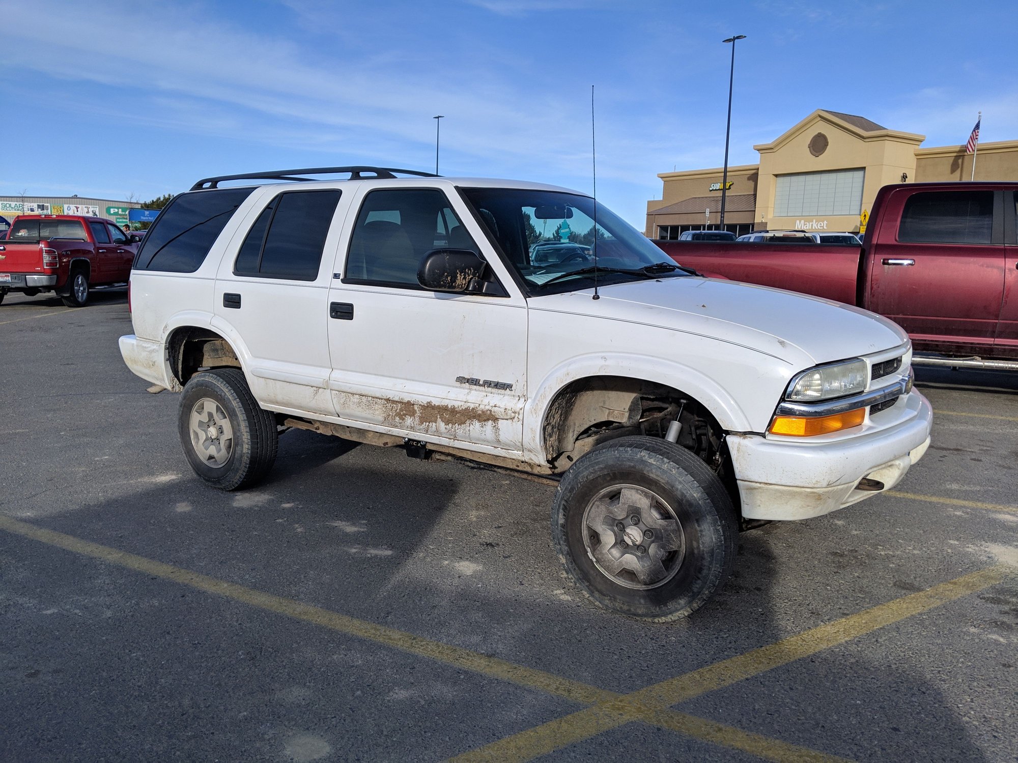

So now I am trying to sell the Jeep and I bought a 2003 4x4 Blazer. I changed the intake manifold gasket, changed upper A arms, tierod ends all around, I've put on a 6" rc lift, eventually with 33s. I am thinking about regearing the differentials, cause I have the GU6 diffs, and I am not sure how they will do with the 33s. I am also looking at lockers for the rear. I'm not at all knowledgeable about diffs so I will be looking around here. Overall I am really excited to start tinkering with the Blazer and happy to be here.
After the lift, before the new wheels.

I have the 6" rc lift as well, and I'm running 33x10.50 boggers. Definitely need to do some fender trimming to get them to fit. The back edge of the front fender is the worst spot.
Also, you'll need wheels with less backspacing, to avoid rubbing on the frame at full lock (depending on how wide you go, anyway)
You'll want to regear for sure. I have 3.73s, and at some point I'm going to go up to 4.56s.
