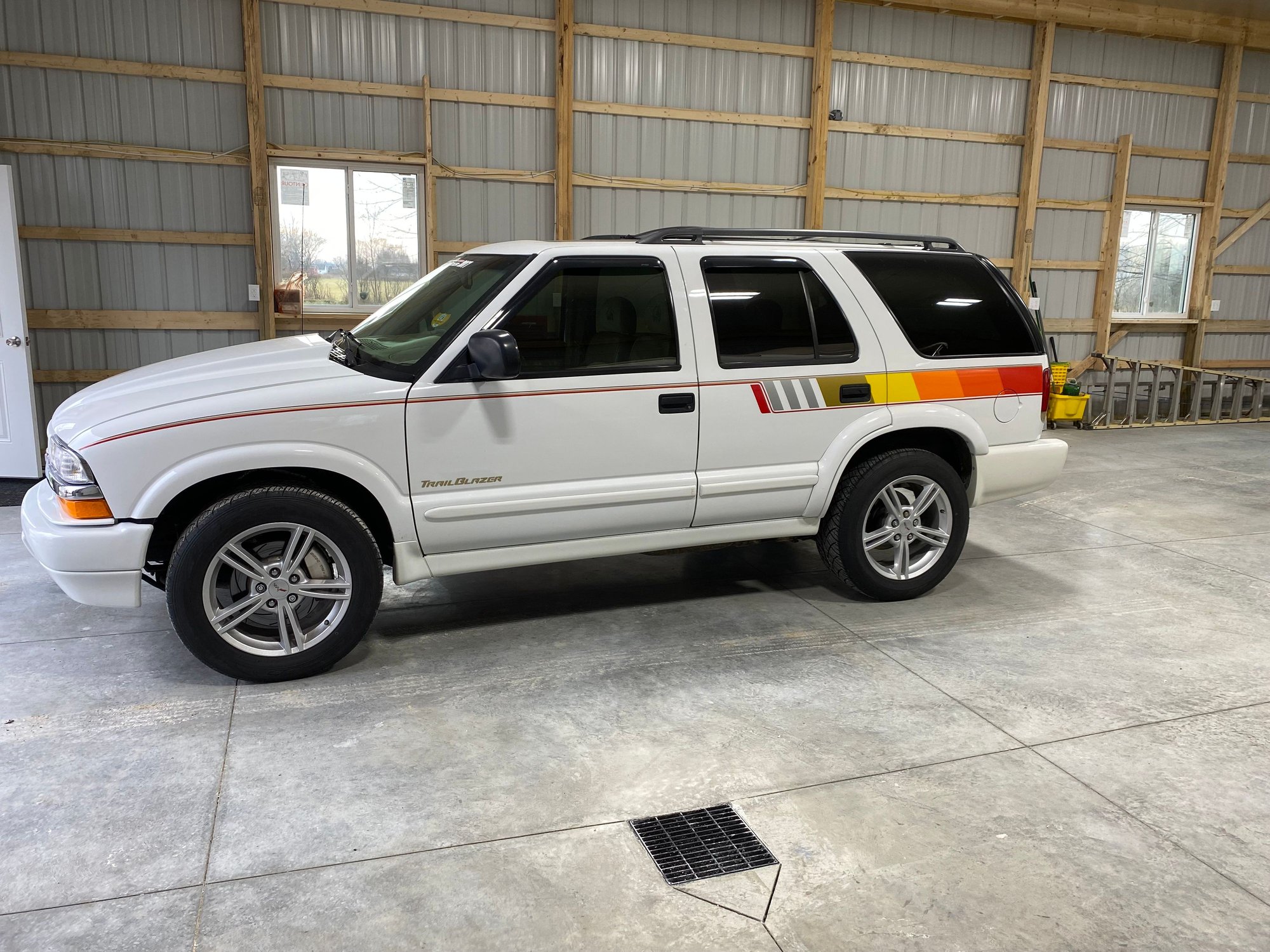

I have a 2000 Trailblazer with AWD. The 4x4 AWD switch is not working, but sometimes it does, but doesn't stay engaged.. Don't know if the actual switch is bad or the actuator. Is there something else it could be? Any help would be greatly appreciated. Thanks, Mike. P.S. It has a LS2 engine with Manguson supercharger and transmission from a 2006 GMC Yucon.

Not sure which transfer case it is.It is the AWD one. It is out of a 2006 Yucon Denali I believe. I bought the truck the way it is. It has a new hand assembled 6.0 LS2, with Champion ported heads, mild blower cam and Manguson supercharger. It has absolutely zero rust and has 69,000 original miles and was a Texas truck all it's life. It is in pretty much mint condition with super nice interior and has original paint, except for cowl hood.
