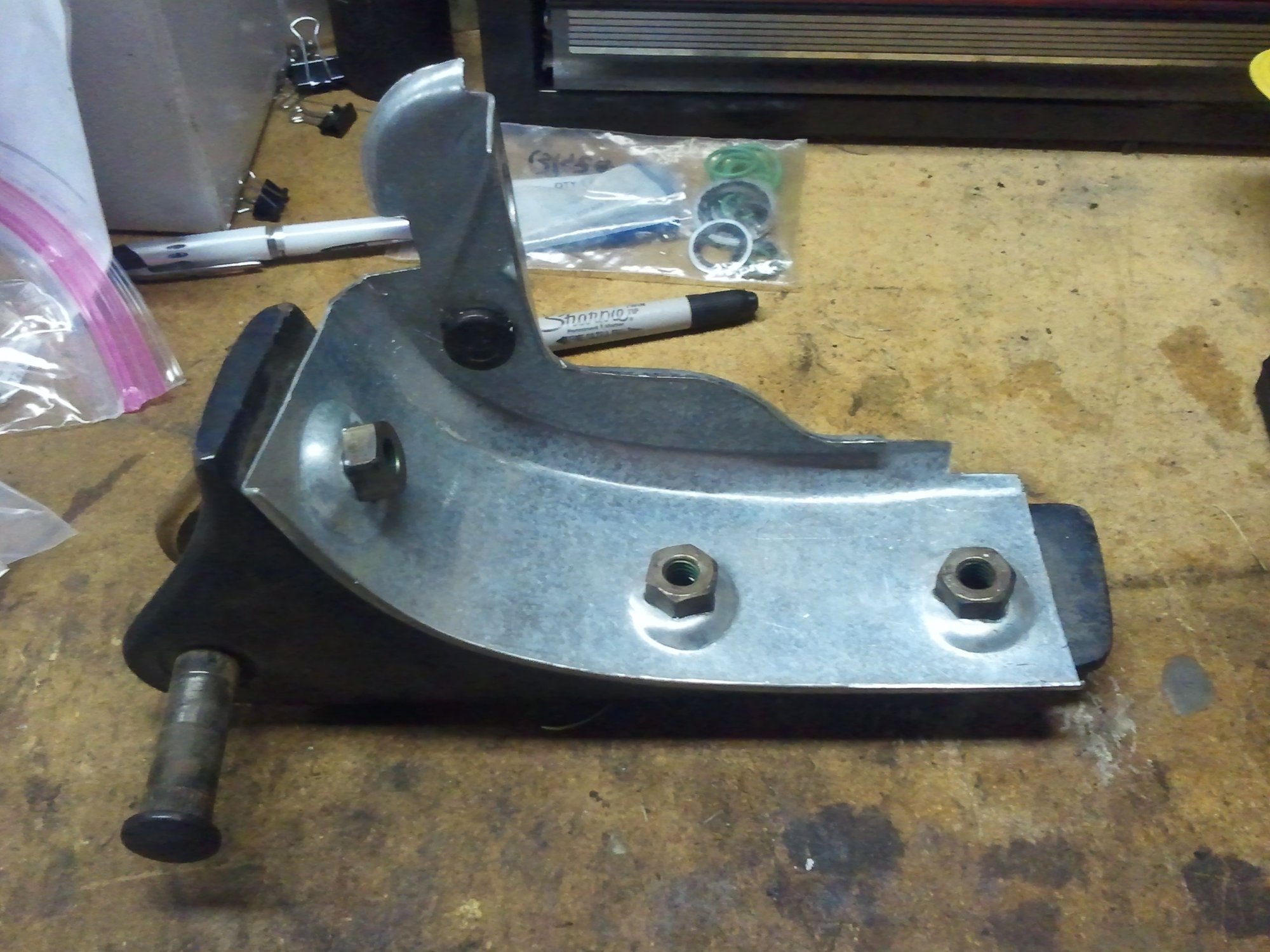

Here is a one of many writeups I've found on this forum. I plan to replicated much of how this member approached it. The one think I might do differently is added sheet-metal body-panel adhesive to the reinforcement plates as a way to take some of the load.
https://blazerforum.com/forum/builds...-66048/page54/
Then here is a link that shows what the stock upper bolt attachment looks like. Spare Tire Carrier
And this is what the lower reinforcement looks like. You can buy this part still but you cannot install it unless you take off some of the body sheet metal (as far as I can tell).

I agree with Christine. The factory brackets technically can be removed from a parts vehicle, but they're really difficult to get, and it involves cutting a fair amount of sheet metal on both the donor truck as well as on yours to make them fit. When I installed my spare tire carrier I decided to just use a 3" fender washer stacked with a normal washer and lock nut on each of the 6 bolts. There's pics in my build thread, as well as a main thread in the how-to section that showcases a number of different install methods that people have used.
The main thing to worry about with the setup is if you go much bigger than a 31" tire which will get quite heavy, or if the lock mechanism doesn't close properly and the swing arm comes open while you're driving. That's the only time I've ever heard of someone having issues with the sheet metal bending is when the swing arm wasn't latched and it swung around while driving. But that will dent the fender even if you have a factory installed setup. I drove my 4-door for 3 years with the spare tire carrier and a 31" AT tire and I never had any denting or sagging of the carrier. Most of the time the weight is supported by the bracket bolted to the tailgate, so unless you stand on the carrier while it's open you'll likely not have any problems.
