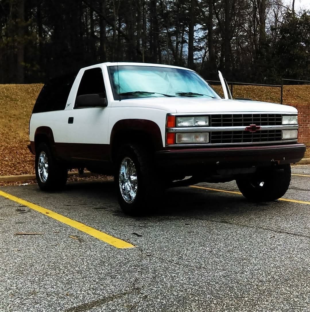

Hello everyone my name is Tyler and this is my 1992 k1500 blazer sport with the 350 TBI . She was my father's truck before me and I've been trying to restore her to her former glory after sitting for 7 years. So my issue is my idle. When it's cold it idles high around almost 1100ish rpm until it warms up and it will sit at 750 for the most part but sometimes it surges for a few minutes after warming up and levels back out. It will also die sometimes putting in to gear but always starts right back up no problem. When the truck is in drive at a light it will sometimes idle low after warming up between 5 to 600 rpm and it never dies when I keep it in drive but when I go to put it in park it will. But at the end of the day I'm not sure if it's my iac valve or a vacuum leak. Just to get a complete picture I've replaced the motor and transmission. Every sensor and connector on the entire truck. New fuel tank, pump and fuel filter. I've replaced all the ground straps to my knowledge could have missed one I'm not sure. I've replaced the brake booster and master cylinder. All the ignition parts are brand new. The entire TBI is rebuilt with new parts and gaskets. I'm at my wits end I'm not a certified mechanic and I've spent so much money throwing parts at it or in and out of shops who can't resolve the issue. Bottom line I need help from my fellow blazer peeps please help. Thanks everyone have a blessed night

Welcome to the forum! Pretty nice looking truck!
Does the truck still have the factory EGR system? These can sometimes cause an issue with idle quality which can lead to stalling when there is an abrupt change in load on the engine (putting it into or out of gear for example).
