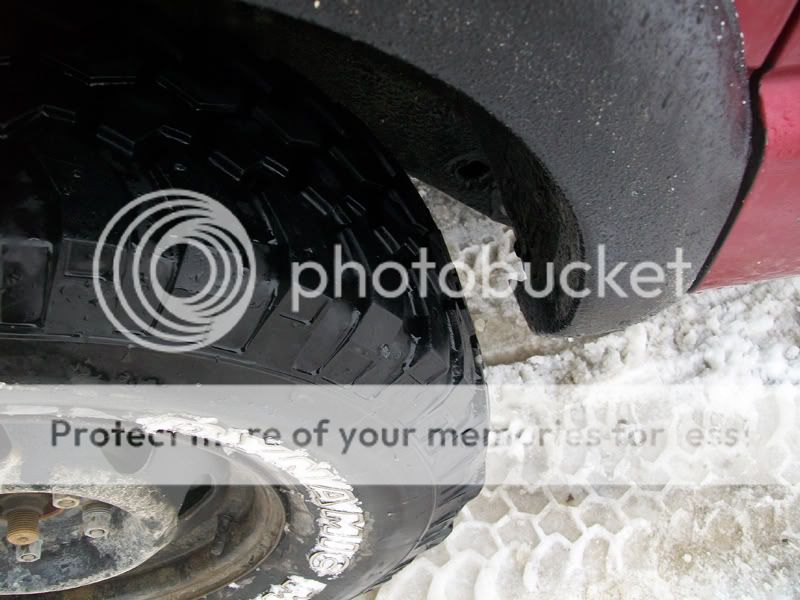

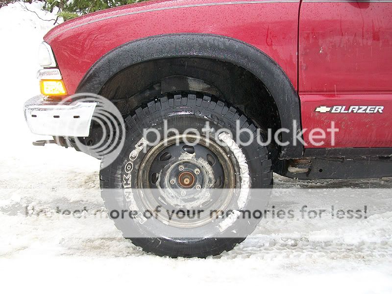

Now, I haven't had a chance to off road much yet, but with a torsion bar lift and nothing else 31x10.50x15's Goodyear Wrangler Authority's (just like every 31 I have owned measures a little bit over 30.75 inches on the stock rim) on stock wheels do fit and don't rub in the front.
They look like they will rub, but I will take some pictures here in a bit, and show some of the mild offroading it has been through so far with only the back rubbing. in the back when flexed they do rub but I have 2" shackles that still need to be put on.
As far as ride, ride is excellant. Twisted the bars up all the way on one side and backed out 1 turn and level the other side with it, and with the Bilstein shocks I think it rides as good/better than stock.
PICS WILL BE UP IN A BIT. HAD A VERY BUSY WEEKEND (had to buy tires for 2 vehicles, got the transmission out of the celica on the garage floor, spent 4 hours getting tires on the blaze cause WAL-MART effin blows).

Yep, I've always bought 31's for all 3 of my previous 4x4 S10s. I've also always had air shocks on the rear to level out the rig. They do rub every now and then (tight turns/wheeling), but I've never had a issue. Only reason I'm not running them now is these tires were on this rig when I bought it.
Join Date: Jan 2011
Posts: 13
Power, man for the way I drive there was vertually no differance. You have to understand I am 27, the wild days are behind me (I had a 306hp ford ranger 2wd with 100 shot, 88 4x4 with the same motor, I have had mustangs, I have had blah blah blah) so I am not saying it didn't lose power, but nothing bad, for the way I drive, which is mostly 100 miles a day to an from work at 60mph.
Pics are coming, I didn't get a chance to get them taken and posted last night. Family obligations come first.
After a little more driving if I flex it hard (20* hill with a 45* approach angle) it will rub the rear inside inner fender. I think the 2" shackles will fix this. If I am wheeling it hard and turn all the way I can get it to catch something in the front, I think it is sway bar, have a little more looking to do here.
mine has 31x10.50 bfg tires and they will rub on a hard bump and i have shackles on the back and the tbar lift on the front. only way you can get it where it wont rub is body lift or cut on the fenders a little bit.

Sorry guys, I don't have pics up yet. I am Tool control S c/o at a prison and it is dark by the time I have been getting home. I may make it home in time tonight I don't know. If not, I will be off Fri. Sat. Sun. I will defiantly have some pics up then (should be some off-road pics as well).
I don't know why some of you have problems running 31's, I know of several around here (non ZR2 running it, the only one that had major rubbing problems was one running a set of 15x10 wheels.
Is there some other "HD" suspension the dealer around here might have ordered on most of the 4x4's... Is it a 2 door thing? here are my RPO codes from compnine any really stand out? Possibly the z85?
