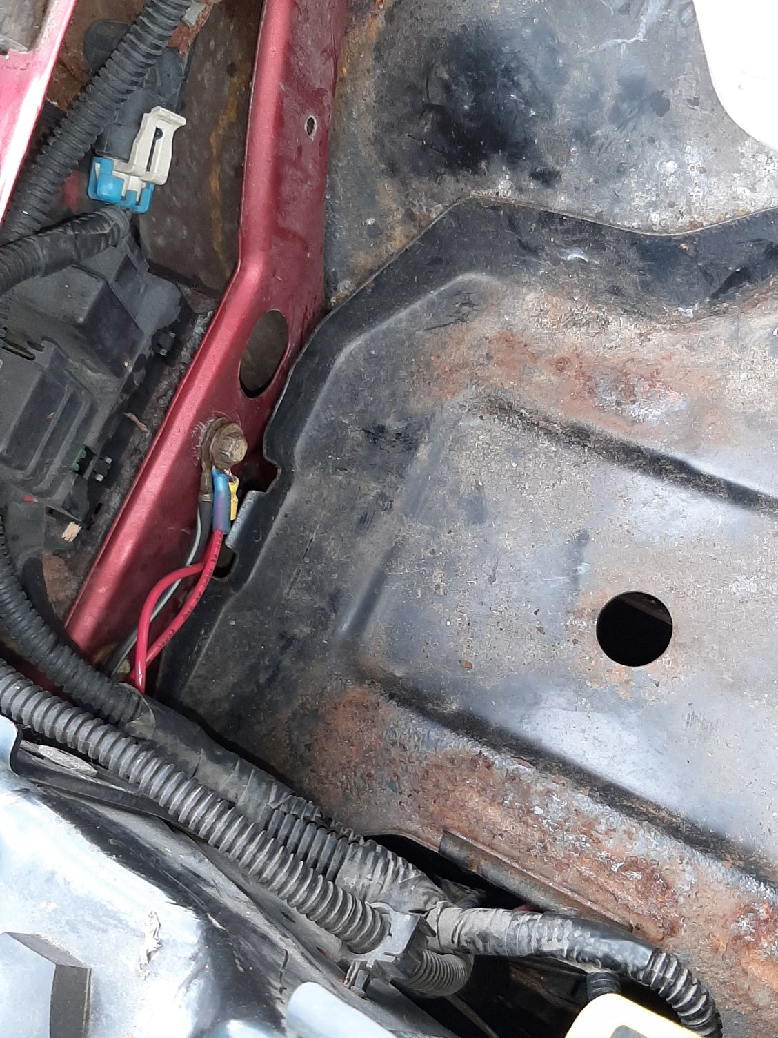

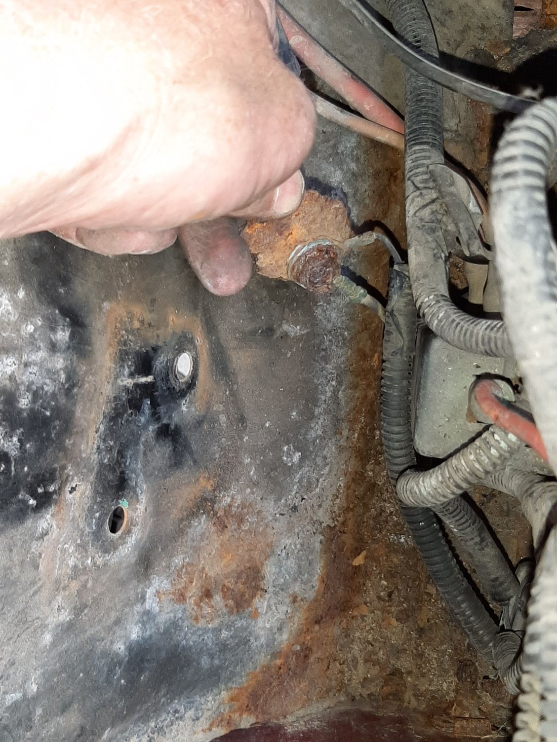

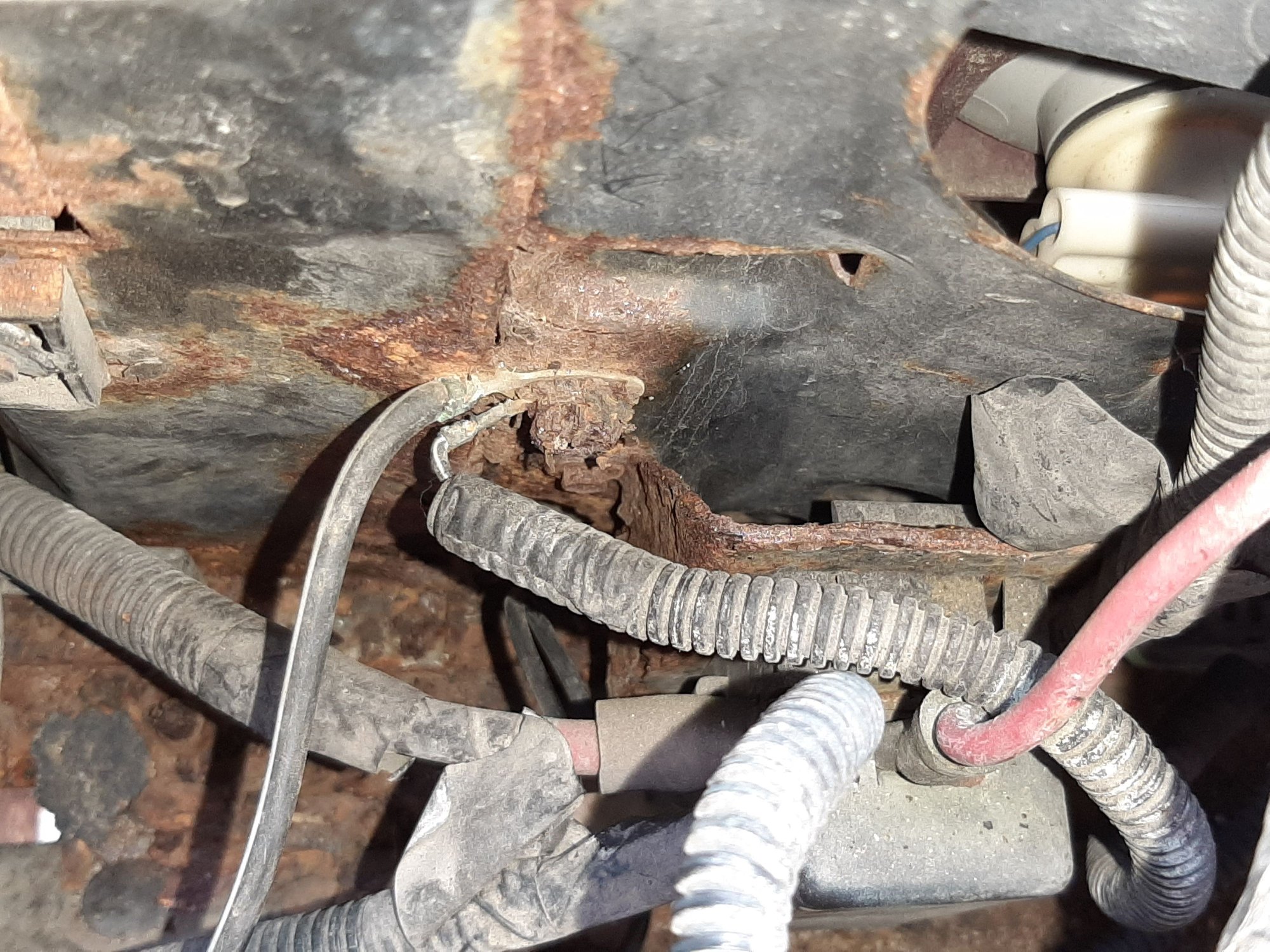

Tom A. mentioned a ground on the core support and that indeed was the trouble. There were 2 ground connections, 1 was broken free, the other still attached but not doing much good.
I added some wire and new wire lugs and moved everything to the right inner fender beside the battery.
Yes electrons and rust don't mix.
Relocated to the inner fender beside the battery box.
Under the battery box on the core support.
20+ yes of Michigan rust broke free.
