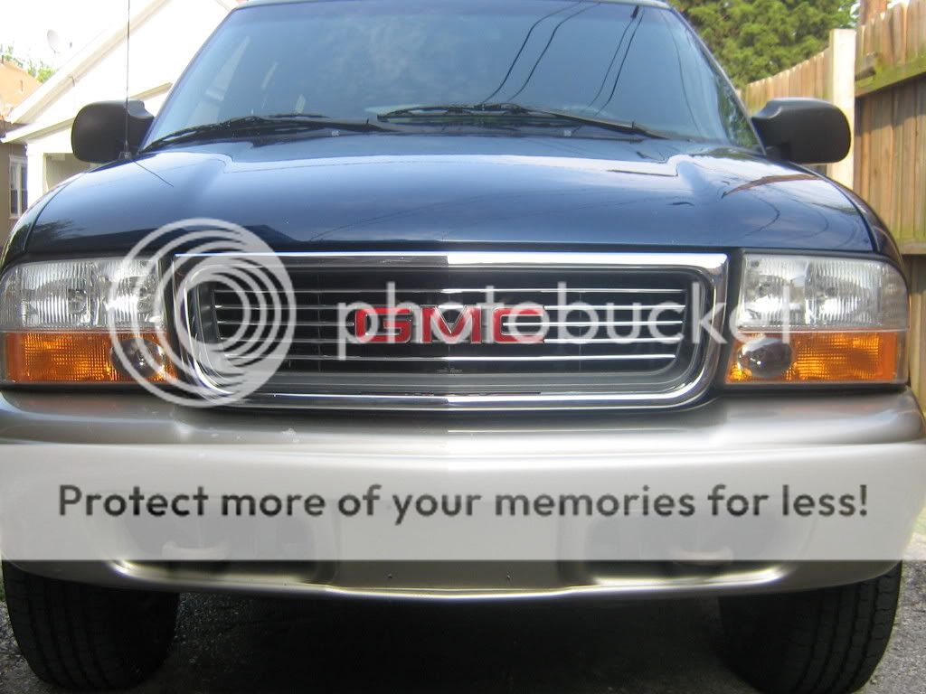

Take your stock grille off the front of the truck. It's just held on by five or six push clips so giving it a gentle tug should pull them out of their holes. Then, once it's out, start sliding the door edging onto the horizontal bars on your stock grill. Make sure you get the door edging all the way to the edge of the grille so that you get an accurate length. It may take a little bit to get the edging started onto the bars as it wasn't really meant to fit on there, but it will fit very snugly when you're done. Continue applying the edging until you get to the end of the bar on the other side of the grille. Cut the edging (be careful not to cut too short!!) where you think it should end at the other side and finish applying it. MAKE SURE TO SUPPORT THE BACK OF THE BARS WITH ONE HAND. You can break the stock grille when applying this stuff because it does require a bit of pressure to get it to go on. My grille was already broken so I had to be extra careful. Just make sure you support the bar your working on with one hand and press on the edging with the other hand. Repeat for every bar, wipe the finger prints off, and you're done! Here's some pictures for comparison.
BEFORE
http://i17.photobucket.com/albums/b7...t/IMG_2416.jpg
AFTER
http://i17.photobucket.com/albums/b7...t/IMG_2419.jpg
http://i17.photobucket.com/albums/b7...t/IMG_2420.jpg
swartlkk Jun 12, 2007 07:30 AM
RE: $5 "Billet Grille" for Jimmys and Sonomas
That actually looks pretty darn good! Nice job!
rabbit0102030 Jun 12, 2007 07:48 AM
Wow, I'm surprised dude, that does look pretty darn good!!
lennyblazer Jun 12, 2007 08:20 AM
Wow, that looks amazing, never thought of that before. I think I might have to try it. where did you buy a roll of that stuff cause all I have found is the pre cut strips for more than $5?
Great Job!
-Lenny

throttlesteer Jun 12, 2007 09:26 PM
Advance Auto Parts is the place. It's in the section with the pre-cut strips but it's in a bigger plastic package and in a circular spool. Cost may be a bit more than $5 depending on location and taxes.
I would have never tried it before if I hadn't seen it on another car. I used to work at a Nissan dealership and a guy with a 350Z did that to make the front grille stand out. I thought it was pretty trick and thought I'd try it on mine.
Thanks for the nice comments!
