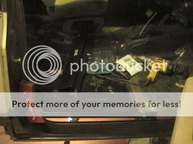

Now I have a dilemma. The floor panel is in place and I'm getting ready to install the new rocker panels but... From the side the bottom of the out rocker panel is lined up, I saved a small portion of the panel at the front and back as I was cutting to aid in lining everything up, but there is a gap between the floor and the top of the rocker. Somewhat smaller in the front than in the rear. Any ideas?
Here's what it looks like.
There is some success though. Here.

Went ahead and installed the outer rocker panel. Even though the floor doesn't seem to line up perfectly the door does and so does the rest of the bottom side so I guess its going to ingenuity time on the floor to rocker tie-in.

When I do mine, I will be fitting the rocker on before the floor. This will allow me to move things around as needed to align at the seem between the floor and the rocker.

Ha! Good idea. One note. The rockers from LMC are of considerably thinner material than the stock pieces. I ended up cutting a small section of the old rocker that was rust free to use as a backer at the welded seams.
