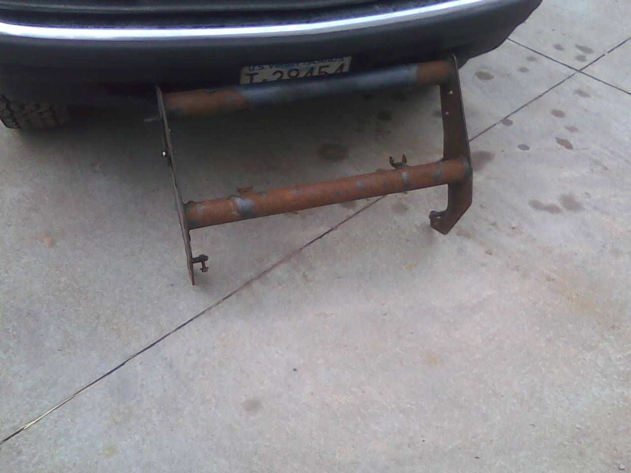

picked up this gem for 30 bucks.
i figure i can wheel the hell out of it and etch prime and paint/ bedliner in a can this bad boy.
anyone have any advice before i get to work, as in having done this and any areas i should be aware of. should be straight forward restore and rust treat.
thanks

Nice find!! Wish I could find something that cheap.
As for the restoring, looking at how rusty it is you may want to invest in some Rustoleum primer just to ensure the best bond possible. Either that or some specially formulated rust primer. Obviously try and get as much of the rust off as possible. It looks like mostly surface rust so I don't see you having much of an issue.
Couple coats of primer and a couple coats of paint should do it. Any thoughts on using undercoating for a finish?

yup the steel is still solid, only surface is rusted. it came off pretty easy which was a bonus. the only hang up is that it came off a cherokee. the width is fine, just needs a little massaging with the cutting wheel. to small bumper mount brackets that are coming off.
i fig. i would wheel it and use some rust "converter" primer and/or metal etcher.
i also was going to finish the job with the good old bedliner in a can that i used on the rockers. it is cheap and easy. then later light that baby up!!!

use POR-15 for the base coat. it's a primer & a sealer-works amazing! the only draw back, it's not UV friendly. but considering how your truck sounds alot like Alex's, it'll work just right for you.
the UV rays turn any of the blacks to a dull "flat" finish. the paint doesn't come off-in fact it's pretty durable. it lasted 6 yrs on my drive shafts before any indication of rust (probably guessing stones finally chipped the paint).
if you use the POR products, just follow their directions-to the "T". in fact, if you just brush off the loose 'n flakey stuff off the push bar, it'll stick better than using a wire wheel to remove it.

well, i haven't given up on the guard...holidays are slowing my progress a little bit.
i have it stripped and am working out the mounting details (cardboard mockup)

that being said, my brush guard only has some surface rust. a lot less than yours, but my plan was the same: wire brush it clean, converting primer, bedliner in a can, reassemble and mount to fabbed brakets! hope you make some good progress! keep us posted!

If you dont want to spend much money, Rustoleum Rust Reformer works great. Spray it on, let it dry and top coat it. It holds up well. Used it on some jeep bumpers some time ago.
