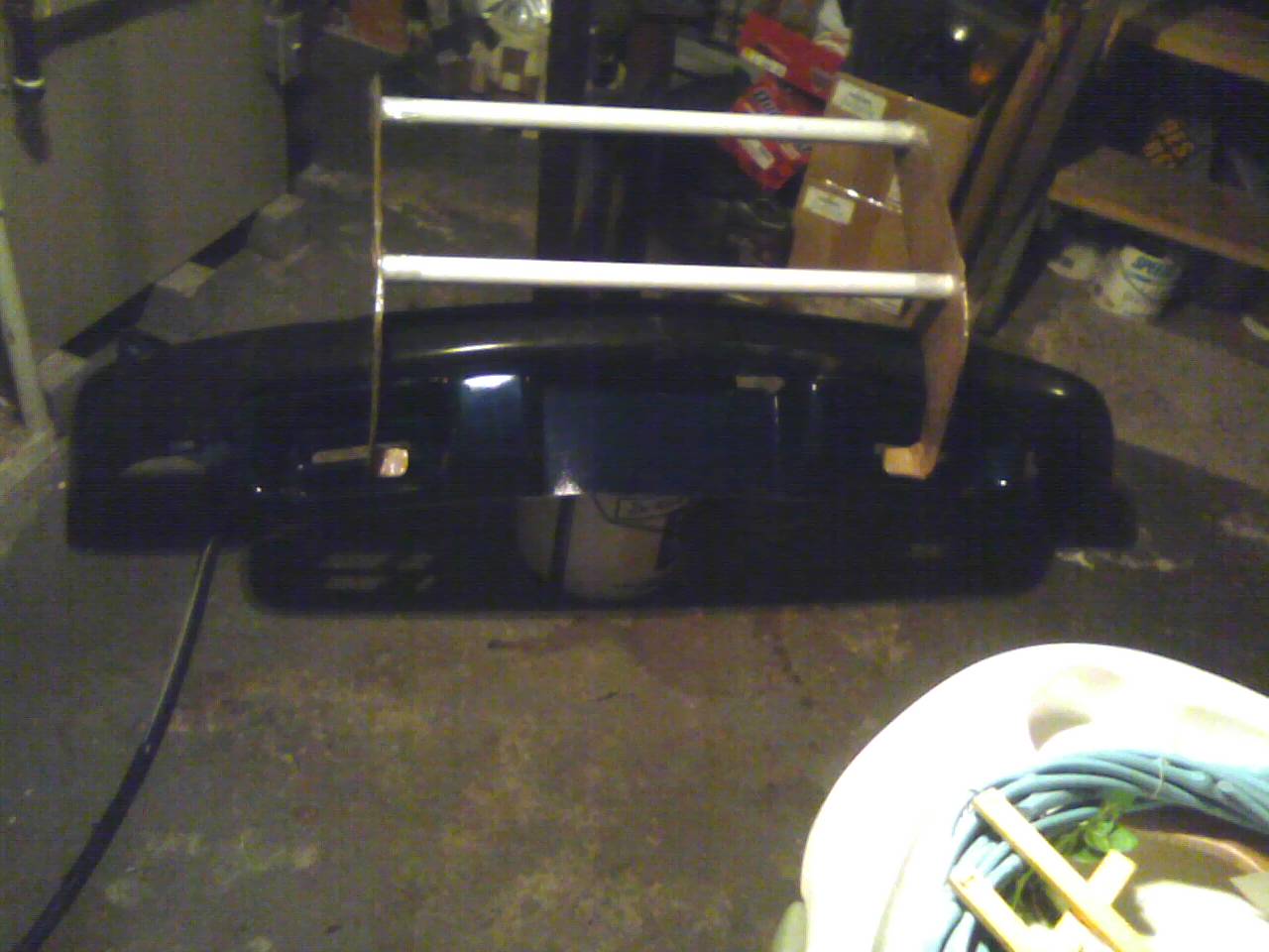

i am working on the guard as best i can. with winter set in my options are limited as far as paint work (no garage) soooo..... i am trying to borrow a garage for the weekend when holidays are wrapped up.
the interior bedliner is gonna have to wait for warmer weather. but it is on the to do list.
i have lights picked up .
i have mock up madeof guard (a lot easier to maneuver), just need materials and time for mounts.
any ideas/suggestions for material thickness?
was thinking just some steel plates, cut to fit and drill out, for mounting hardware.

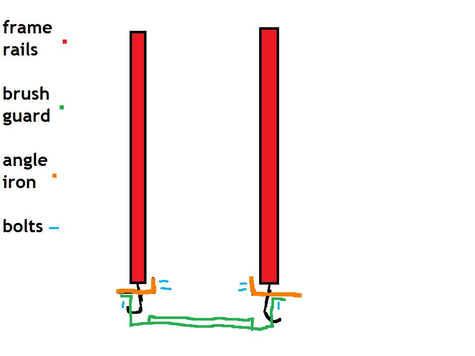

get angle iron. with the set up you have there, go to the front of your frame rails, mount the angle iron on the inside of the rail capping the frame rails OVER the tow hook mounts
use grade 8 bolts.
see below

nice sketch Curtis! you sure you don't work for the engineer's corp?

lol! i am kicking around the same design for mine ... i figured since we are the same guy working on the smae project for the same truck...why not go with the same set up

that was my thoughts as well x2 on diagram.
what thickness u using?
1/4" at least?
