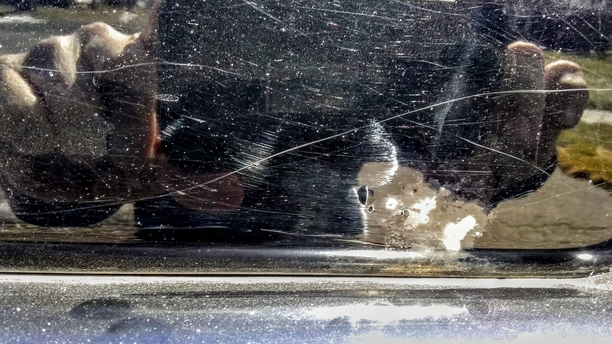

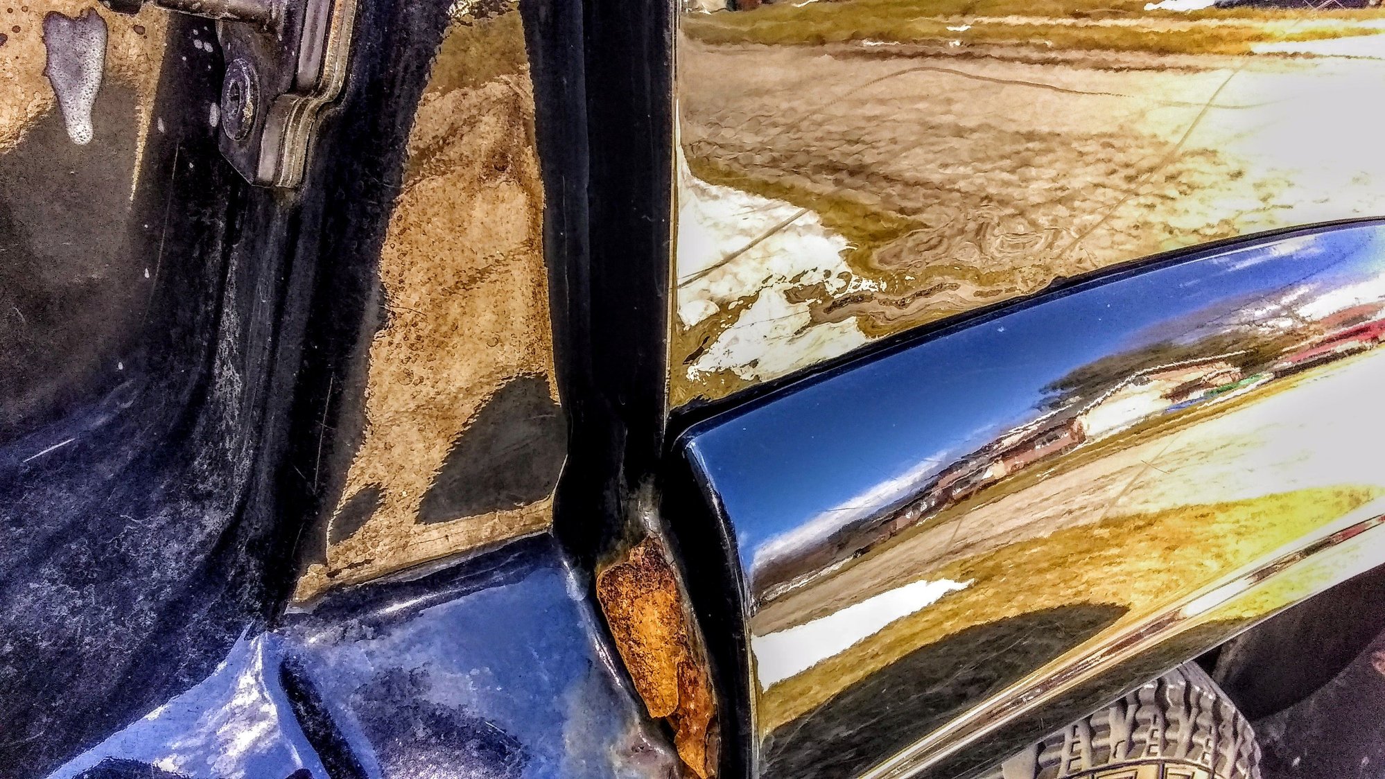

Old Mar 5, 2021 | 11:09 AM
bravo99's Avatar
Joined: Nov 2019
Posts: 219
From: Lansing, Michigan
Default updated dead thread...
driver rear door sill-meets-wheel well...evil bubbling and Sill delam...
passenger evil bubbling just above rear quarterquarter clad.
ugh, it has begun. do I really want to know how bad it is under the rest of it? 🙄😪
