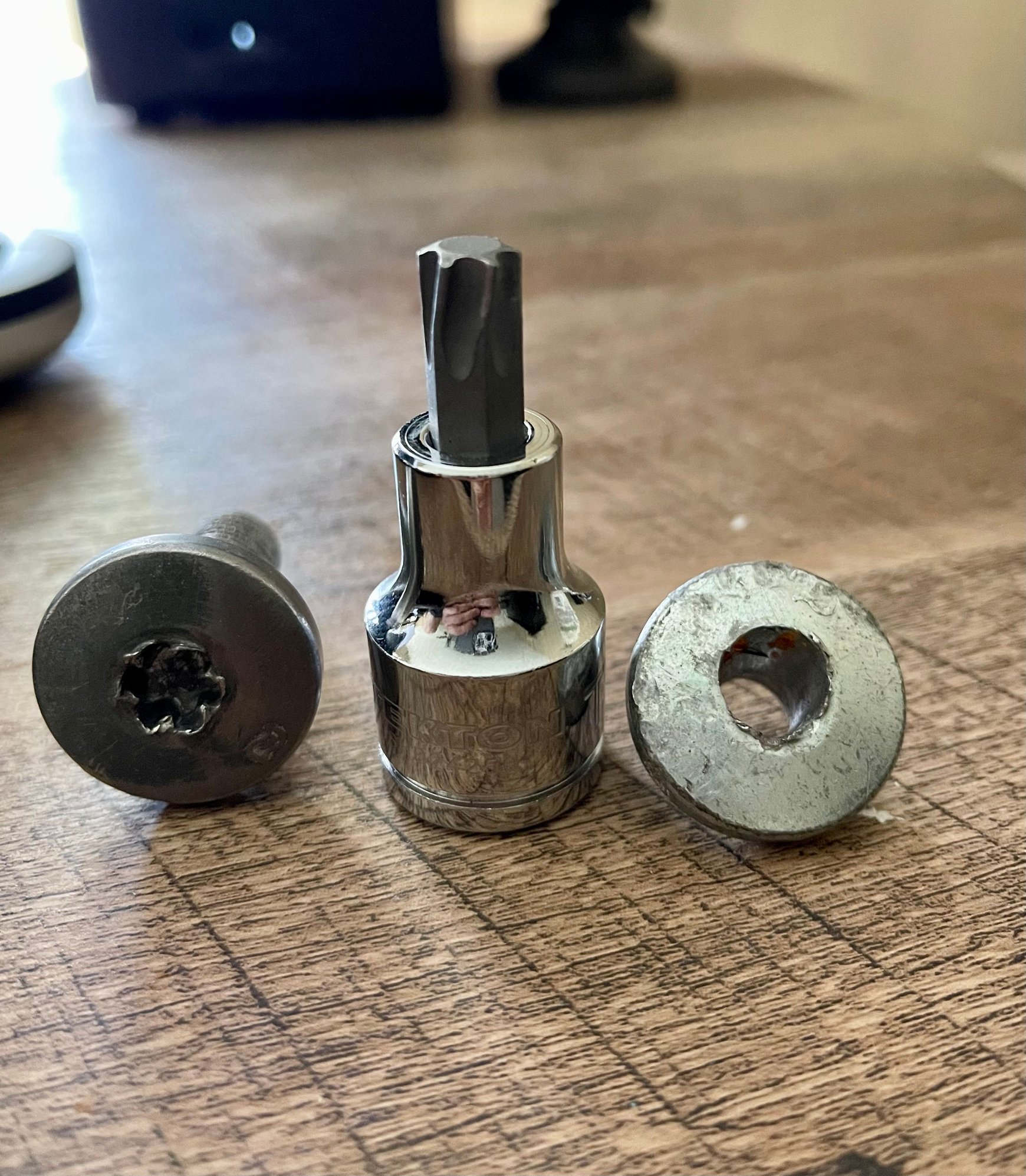

As you can see in the photo I twisted a 1/2 inch drive T50 before drilling through the head of the bolt. I think I used a 3/8ths to drill through it but it ended up just falling out about a quarter of the way through. It’s necessary to remove the seat whether you drill it, cut the head off, or break it loose because you’ll want full access to the hole with no obstructions from the seat bracket. Make sure you’re drilling as straight as possible, you’ll be boring the hole out but you don’t want to go completely sideways or biffed up because you really only get one shot.

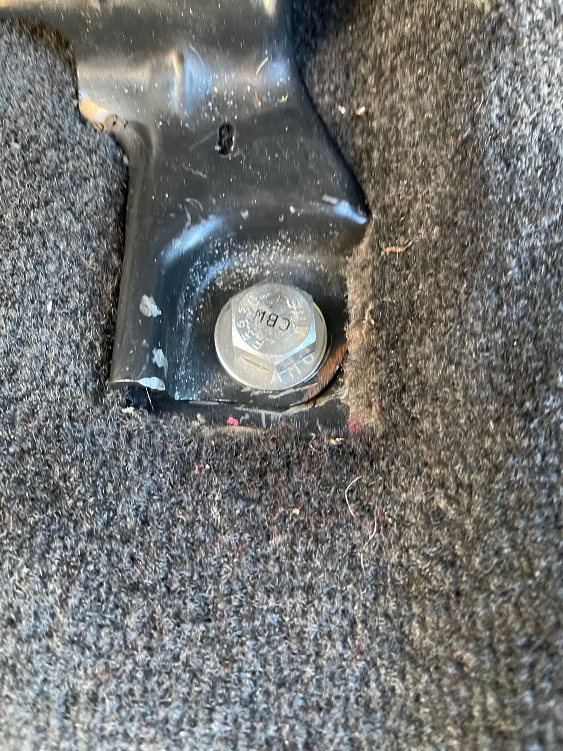

These things are trash

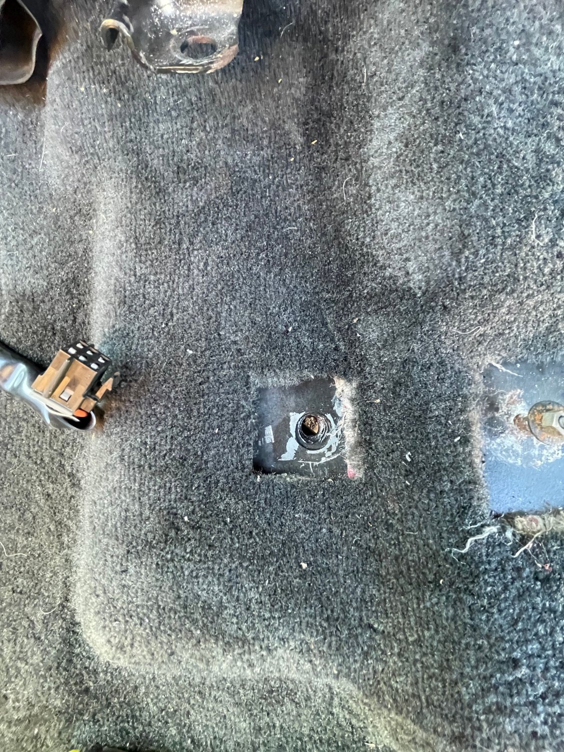

Drivers side

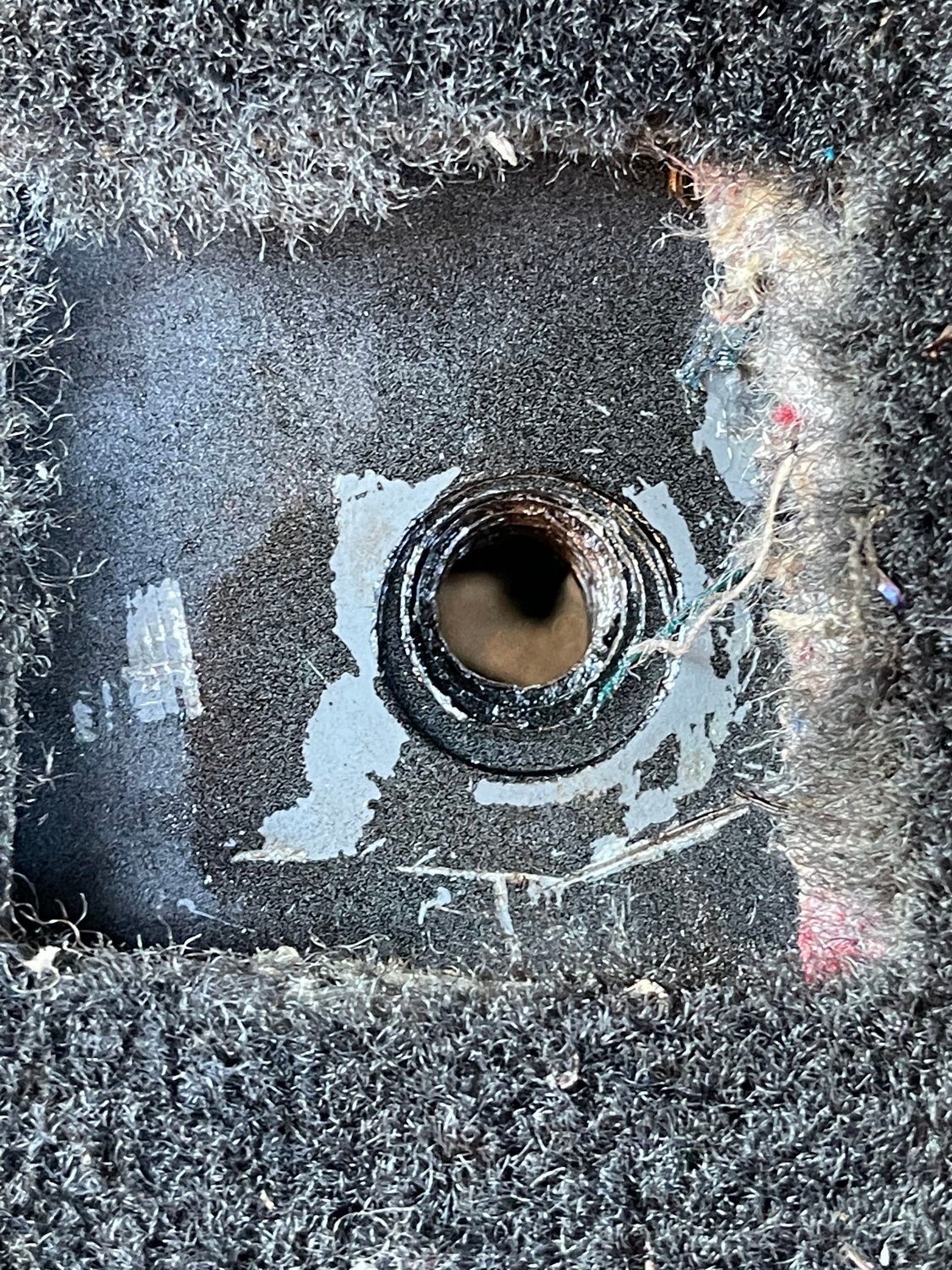

Tapped

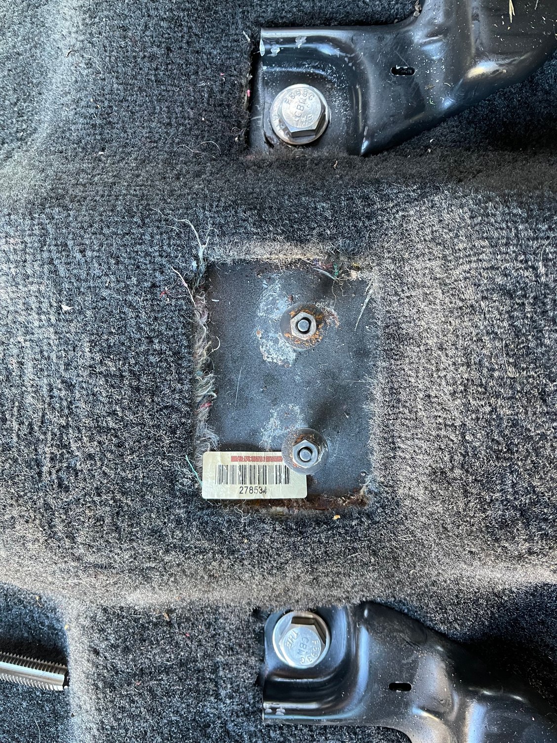

Drivers side drilled not taped - you can see asphalt under truck
