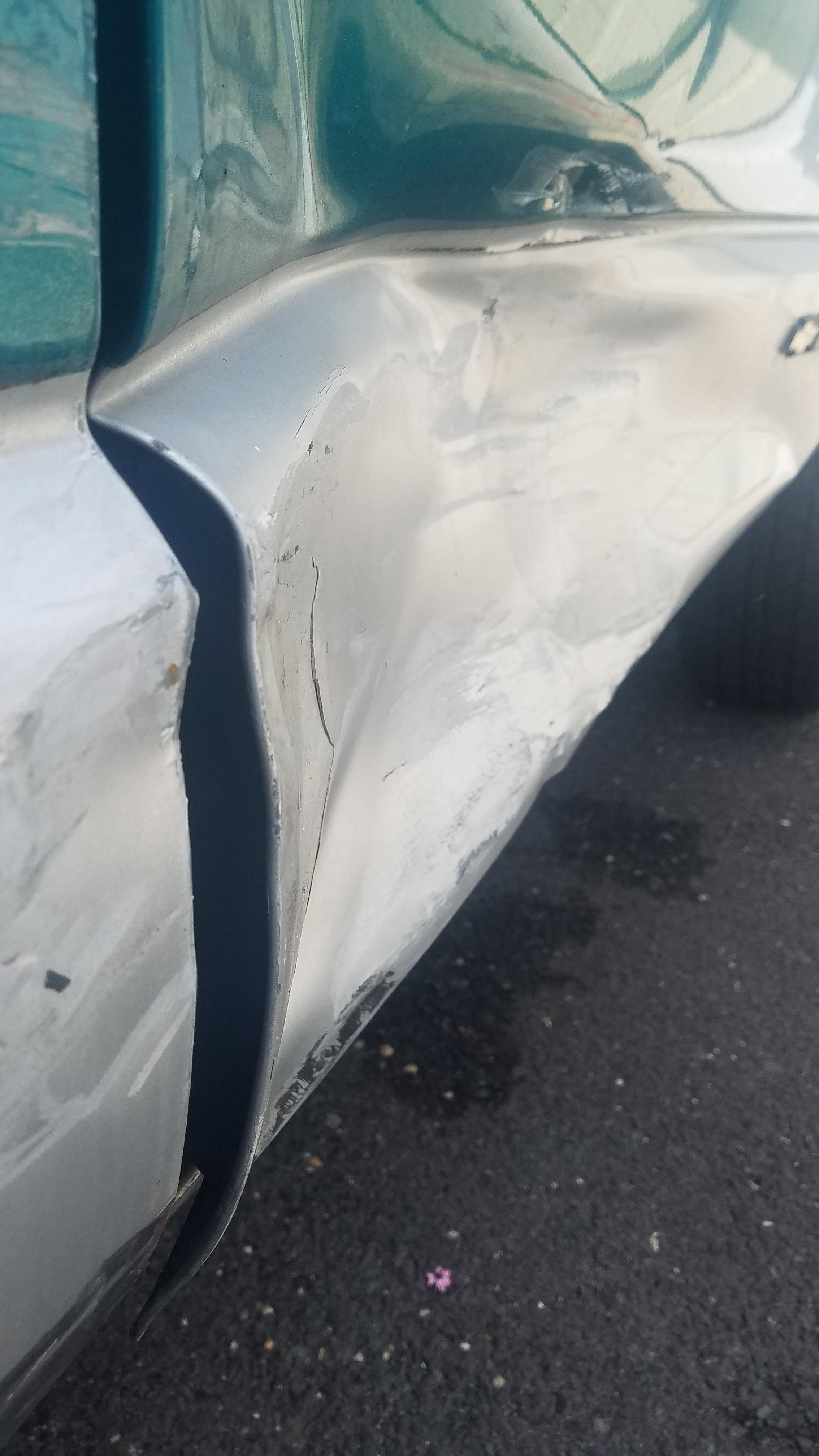

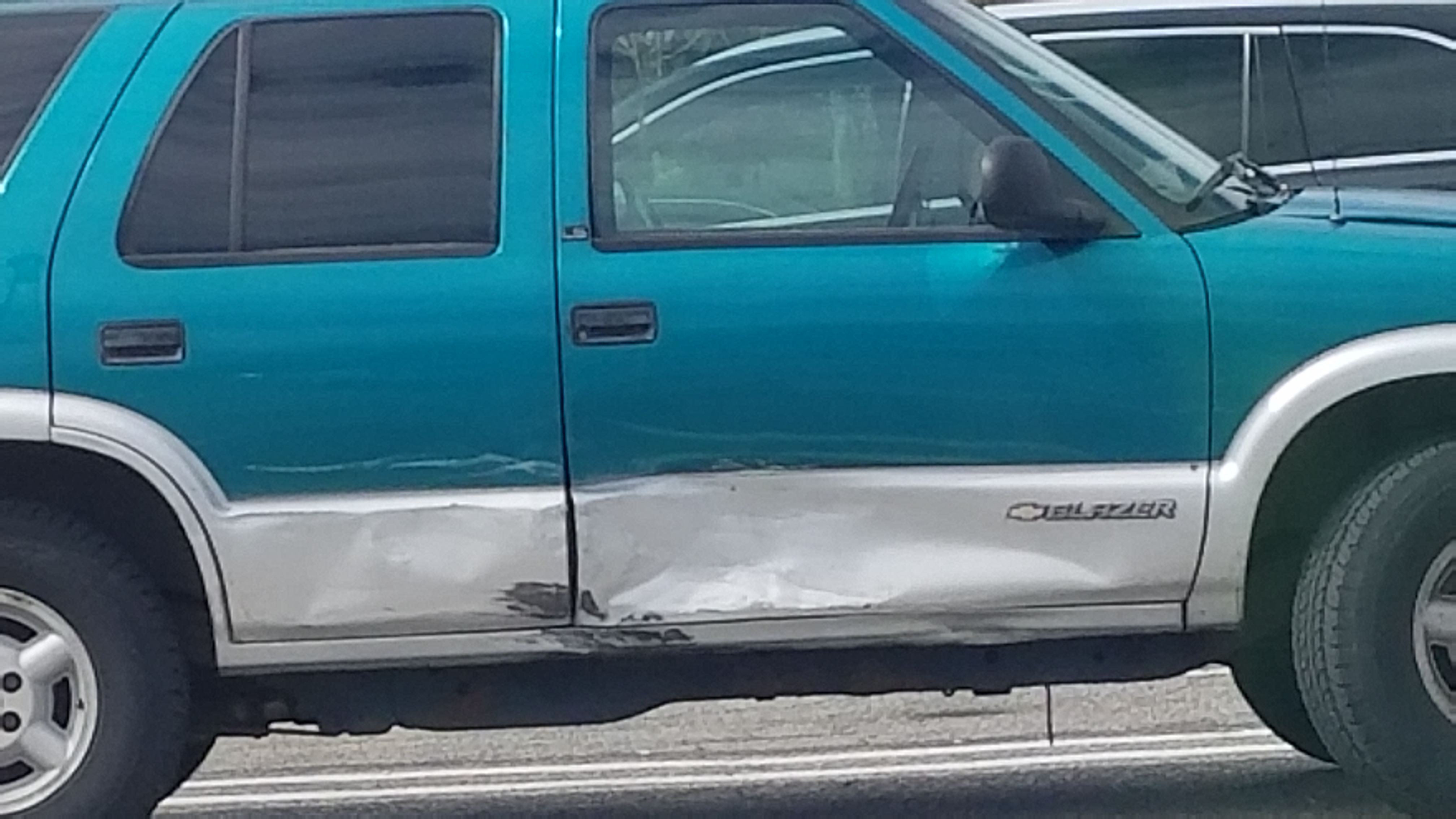

My paint scheme is rare ? Never had this happen.. now it has. Door opens like there is nothing wrong with it, however, now there is a dent .
How to get this to look like nothing ever happened? Body shop price? Kind of shop? How to not get fleeced here?
I can rubbing compound out the "scuffs" but that dent.. Its repairable, I think?? Umm... yeah.

You would probably be bucks ahead to get a used door and have it painted to match.
Old Mar 28, 2020 | 12:33 PM
Did you see if you could take the door panels off and push it out from the inside? When I swapped my drivers door for one from a scrap yard, it had almost the same damage, not as bad tho. I just said screw it a layered the bondo on to fill them in. That was about 2 years ago and still holding like it's part of the door. I plan on replacing it one day, tho...
Paint matching will be the harder part as it's hard to get the same shine with rattle cans, but if you got time and space, it's all doable work, and probably save you a ton compared to body shop, I just avoid them myself lol...

Thinking I'd like to find a shop that could in fact pop the interior off the door and do some skillful tapping and banging to straighten it out. It does look on the larger side. But seems well within what can be popped out.. or am I pipe dreaming ?

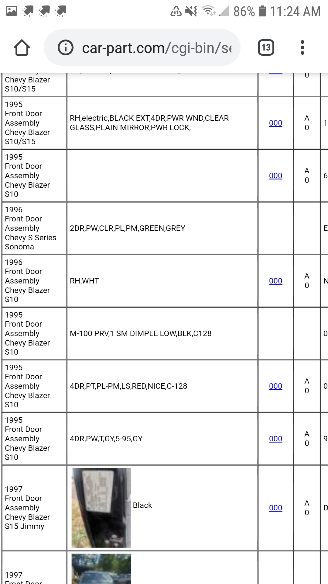

On a whim, I am looking at car-part.com to replace my doors . Based on my conversation with the guy that has "the connection" to shops/mechanics (obviously the "friends" rate,) sounds like all they were going to do is find two new doors anyway. Might even get one.. probably two.
So, I see the color "Green/Grey" listed and I am HOPING that is the same one..
WILL the passenger front from a 2-door fit on my 4!?

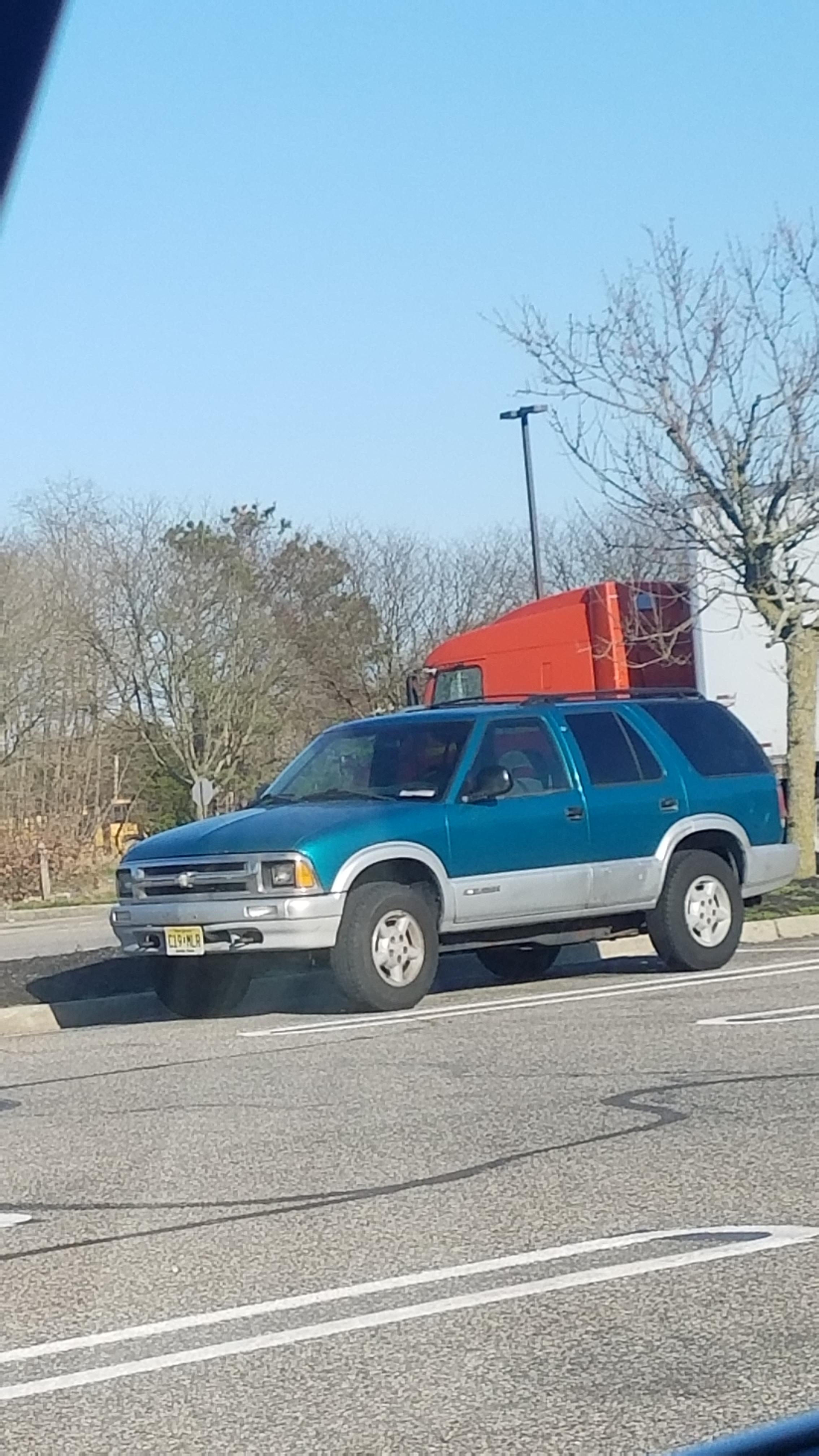

Ideally, I want it to look like the other side .
Is "new doors same paint" the best way to go?

Also.. is it "Green" or "Teal?" About to find the paint code.

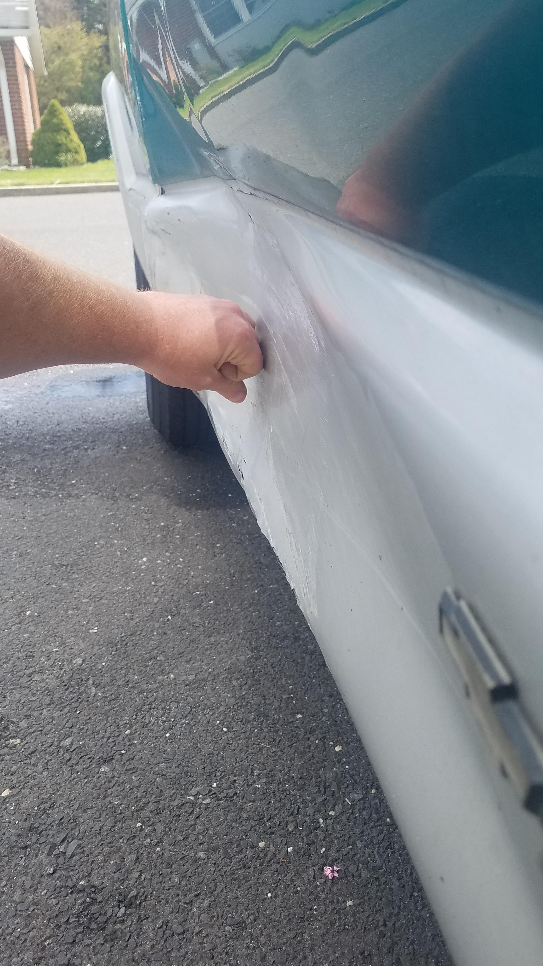

Or.. Seriously, are there other ways of getting this out?
I don't know if you would call this a "hard hit" or what but . Never expected that to happen, and I want this dent. Out...

The doors themselves can be swapped, the door trims and interiors and wiring is different for early and late 2nd gens
