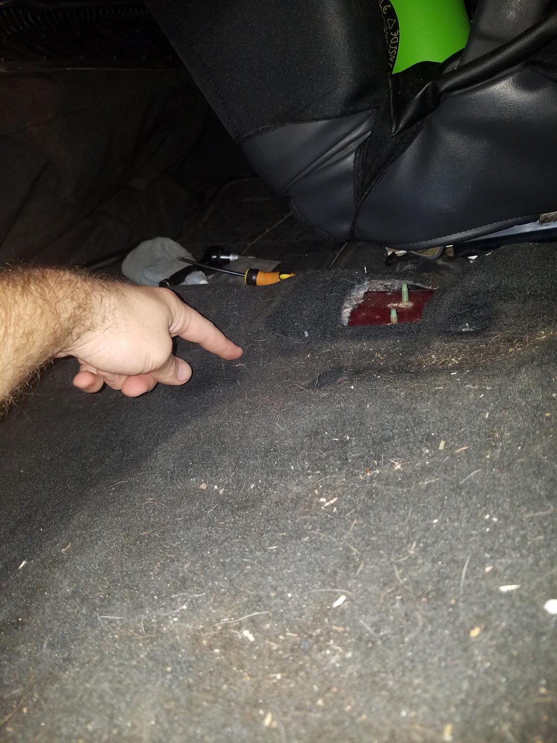

So this weekend, I layed a new Amp power wire under the carpet on the passenger side.
Upon taking the passenger seat out, I noticed I never found the power plug under the carpet.
Took the center console out to get more carpet up. Here's what I found out..
1st pic shows the larger greenish wire, with a suspicious harness looking wire looping back to the center.
As you can see, it appears to be a plug of sorts...
Here is the location above carpet, where the plug was located. It had a heavy duck tape holding it in place.
Pulled it through, and vacuumed.
Lumbar and heat works great!
Conditioned the leather, and put some new seat covers on. Good weekend.
