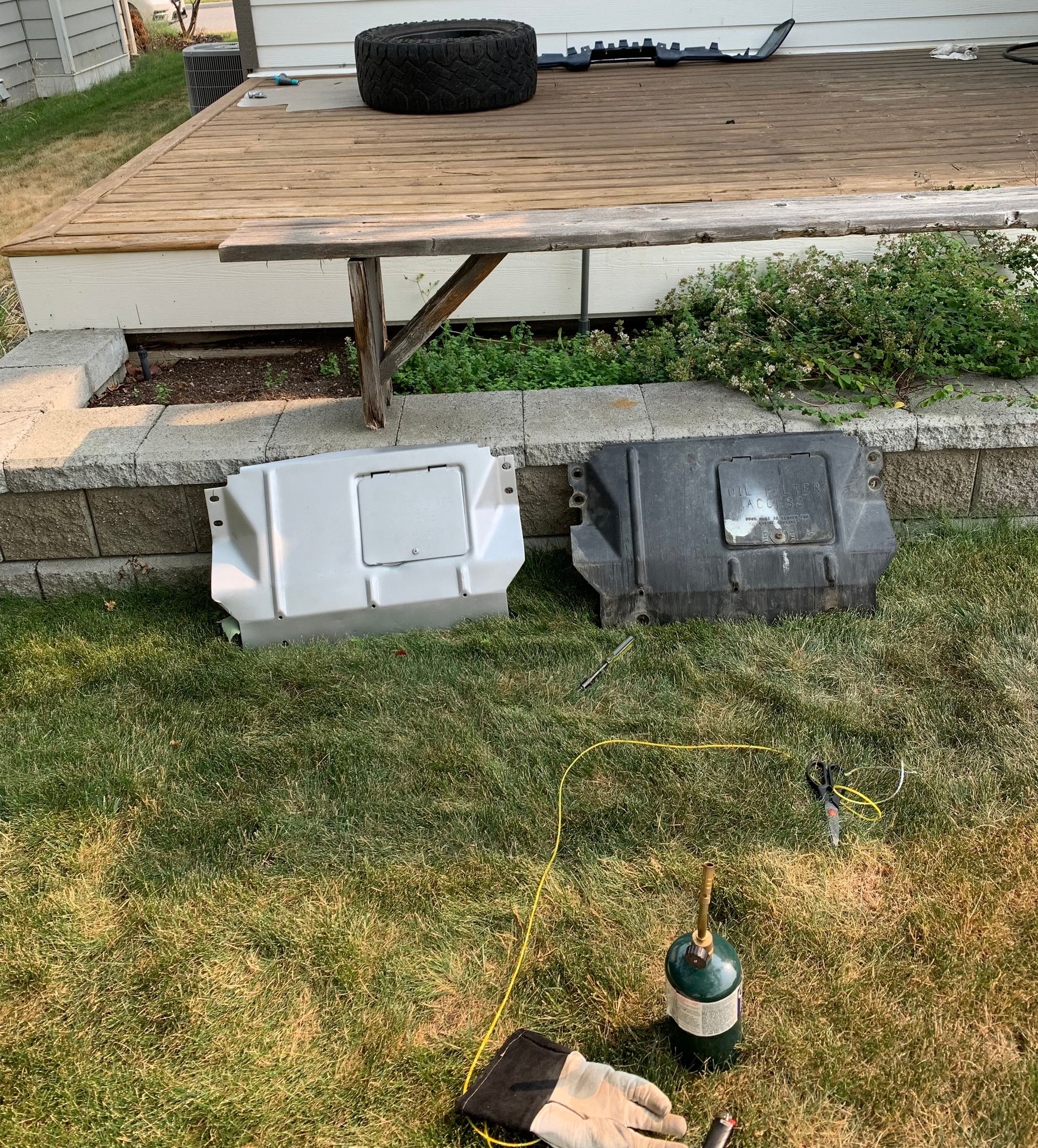

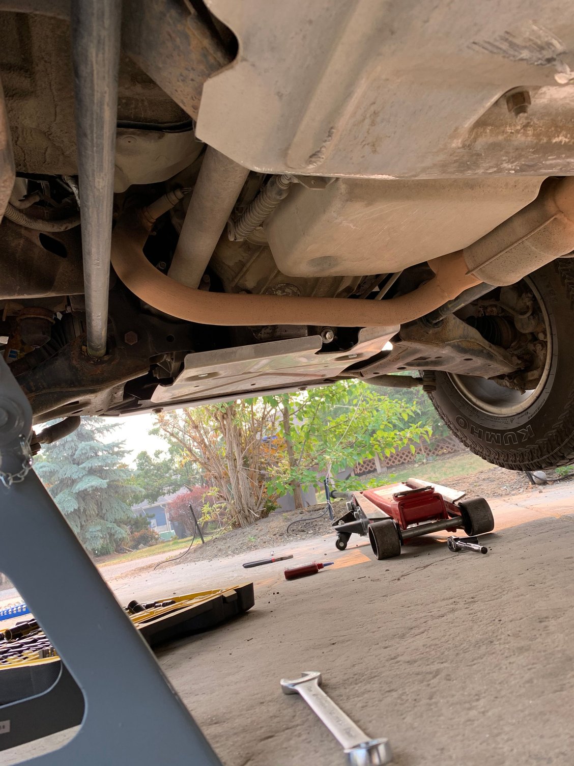

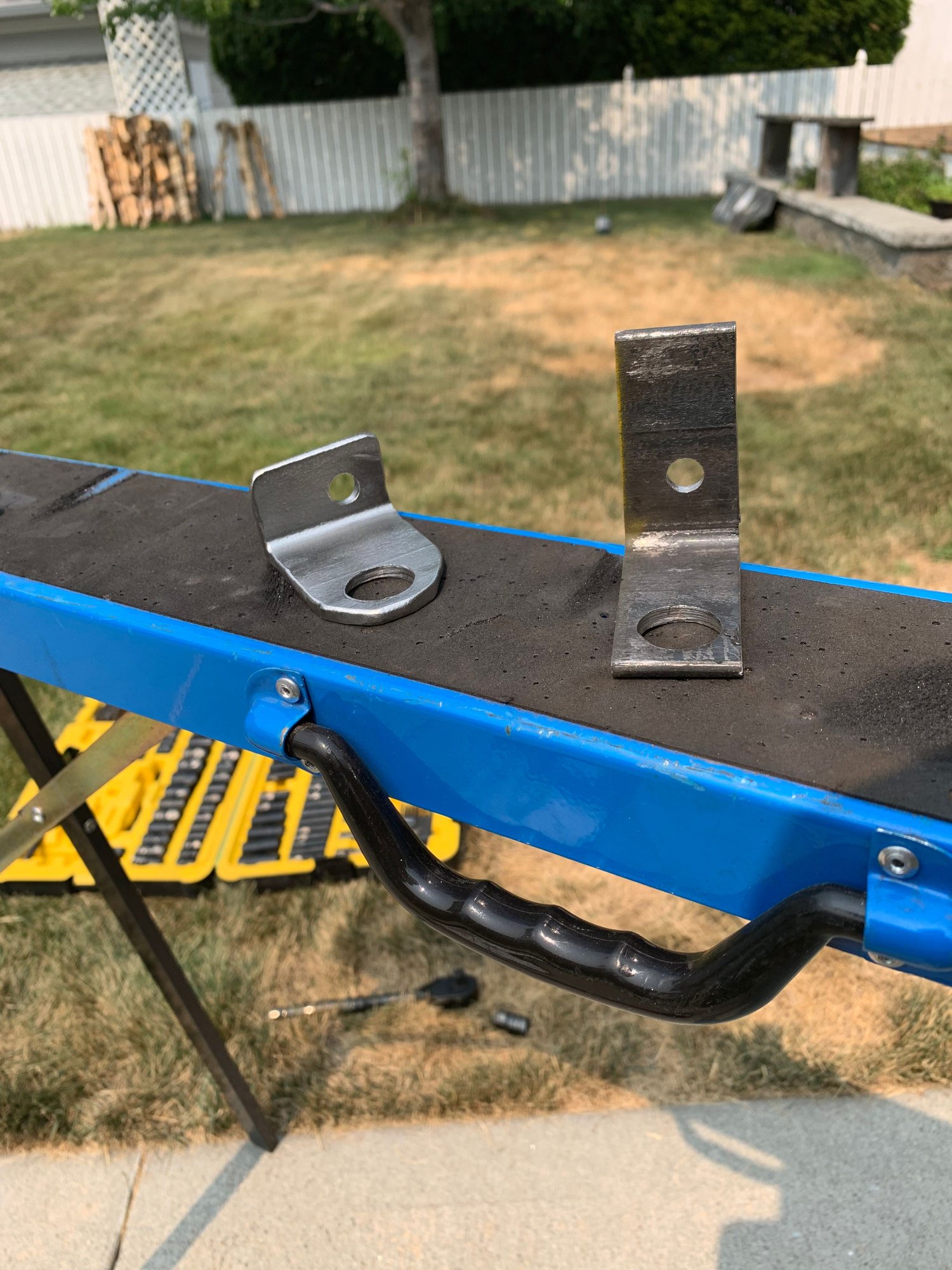

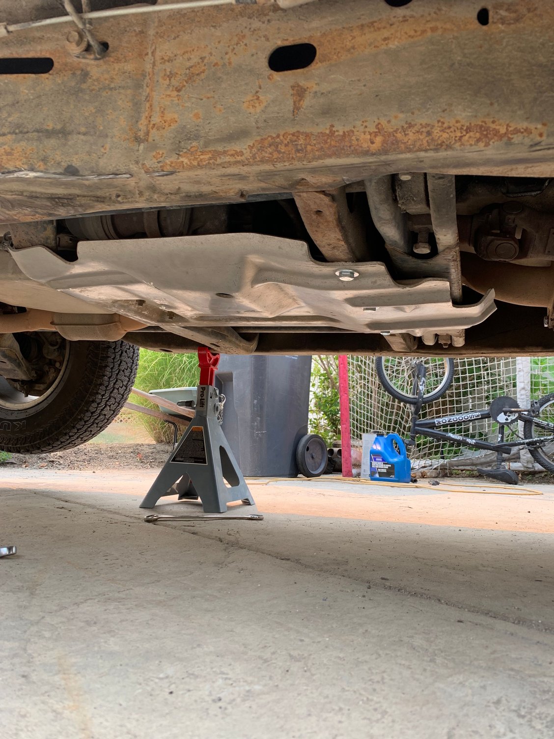

Hey guys, I read up on this thread while I was installing the skid plates and it really helped me out so I thought I would add what I can. I ended up making my own oil pan brackets because finding them these days is nearly impossible. I made the brackets out of 2.5x2.5in angle iron 3/16in thick and shaped them from there. Then tapped the hole so I could bolt the skid plate up. The oil filter skid and the transfer case skid directly bolted up. Pictures attached

Damn they look good. I love have a full set on mine just a pain when u have to work on parts that u have to pull them down for
Old Jul 31, 2021 | 05:46 PM
  #73
Very nice! Good job

Thanks guys! Much appreciated
