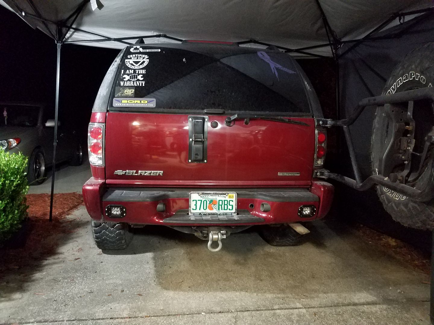

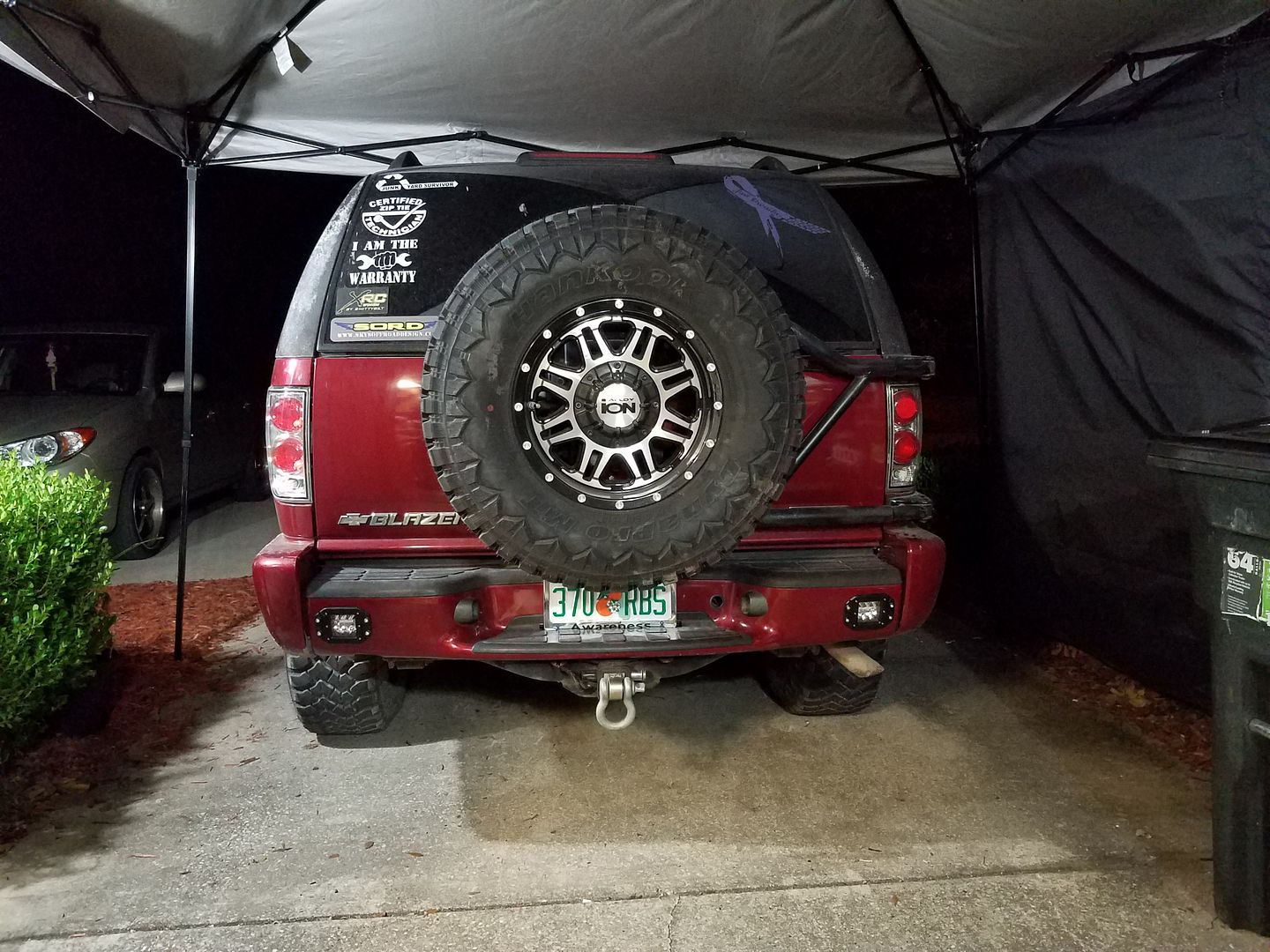

I converted over to the outside carrier on my 4 door and couldn't be happier. I had the same hesitation as you, being that I access the rear cargo 3/4 the time I drive the Blazer, that's usually why I drive it into town as apposed to my gas sipping 4 banger, the cargo area lol. But honestly it has not been that much of a hassle. So long as everything is aligned good when installed and the latch mechanism is in good shape and lubricated, it's super easy to pull the handle and unlatch and swing the tire out of the way, so it really hasn't been that much of an issue to me.

The blind spot was another thing that had me hesitant about the outside carrier at first, but even with a 31" on it it's not too terribly bad. But over the years at work I've learned to reverse looking mainly at my side mirrors too, as the rear view mirror wasn't always an option... Between that and installing a backup camera, I hardly notice the tire back there lol
Another thing to consider with the rear mounted tire is how strict your local law enforcement possibly is on tag visibility. It may be less of an issue with a smaller factory size tire, but with my 31" it actually begins to obstruct the tag. I haven't had any issues with it as of yet (knock on wood) but it's something to keep in mind if you're putting an oversize tire on it. If you're worried about that, you might want to think about relocating the tag to either side of the bumper or actually on the spare wheel itself.
Because of my OCD it did cost me more too... had to get a matching wheel and tire for it...

The rear carrier does look awesome on your Blazer for sure. Seeing pictures made me really consider it, but I have not fully convinced myself. yet.
