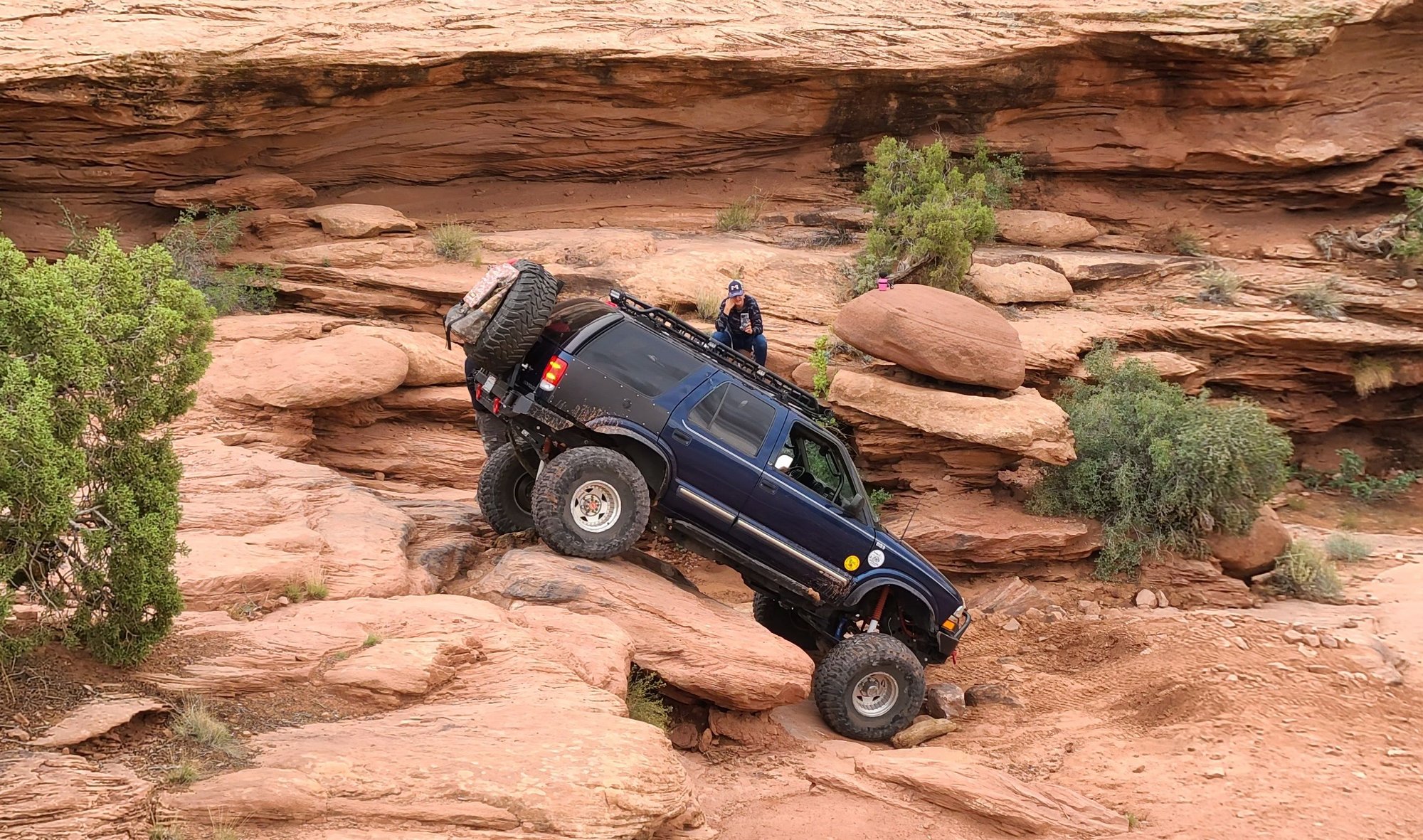

I wouldn't want to do this with too much more lift, lol.
