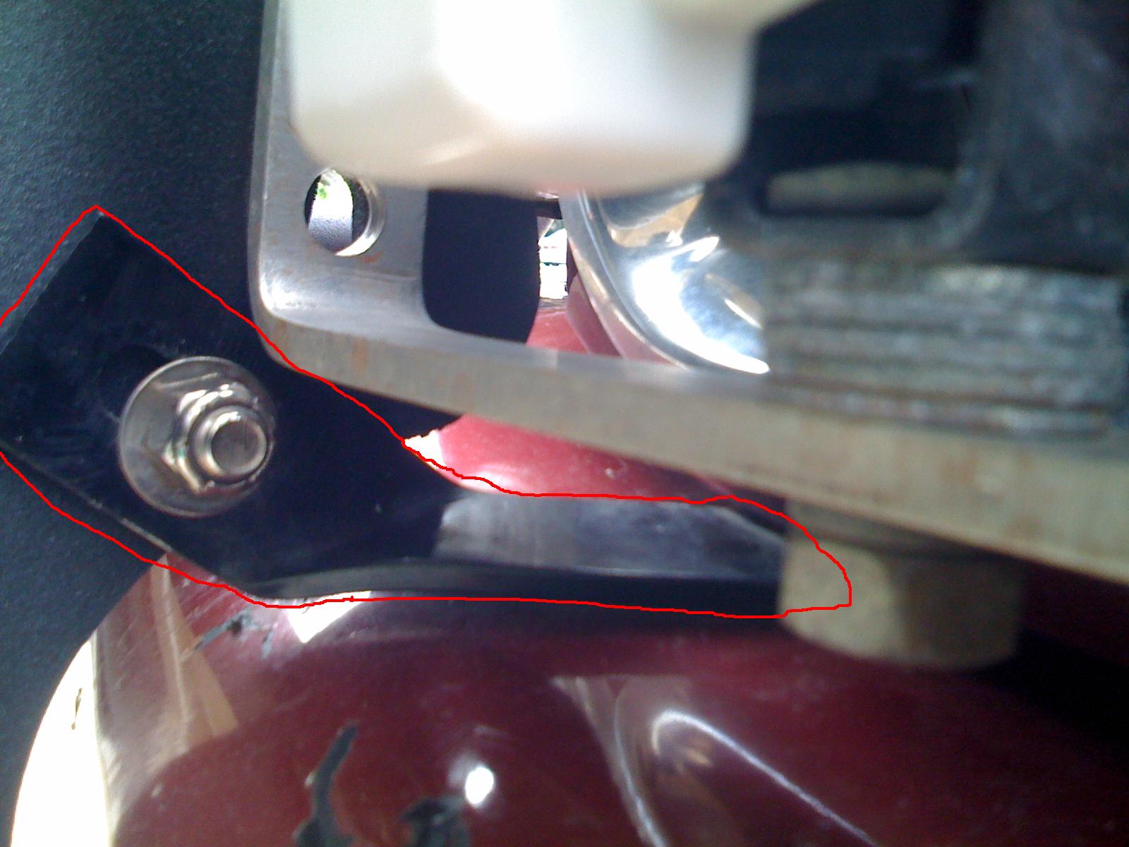

Sorry, I don't have any pics of there the washers go . However, from the looks of that bull bar, you may not need them. On my brush gaurd, there are two sets of mounts.
The first set, are the ones that bolt in place of the tow hooks (tow hooks are removed).
The second set, are directly behind the lower crossbar that goes in front of the grille. They run from the guard in between the bumper and the grille, and are help in place by the upper bumper mount bolts. This is where I needed the washers. I needed them to position the second mount correctly between the grille and bumper.
The first picture show the lower mount where the tow hooks used to be.
The second (it's a bit hard to tell) is the upper mounts that connects to the bolts that hold the top of the bumper. If you can make it out in the picture you can see the mount slide in between the bumper and grille. Thats where I needed the washers, in order to get that mount at the right level to squeeze in between there.
Sorry for the lengthy reply, but I hope it answered your questions haha
EDIT: I think I just found the bar you're looking at, and it doesn't seem to have upper mounts like mine does. So I think you're in the clear, as long as the frame didn't change, which I'm 99.99% sure it didn't haha!

Thanks, I think I see what is going on there. If I do get the bar I will need to find a new place to mount the recovery hooks.
