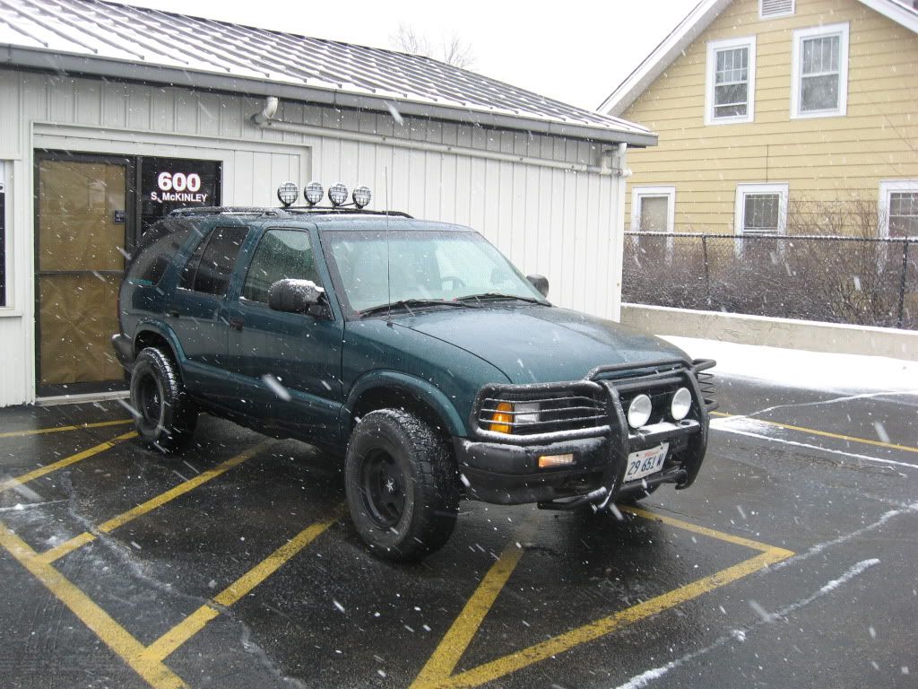

My 2001 4x4, on 2 inch fabtec shackles. 30 BFG Mudders.

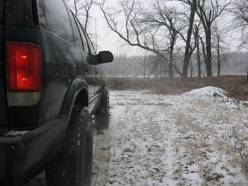

this is mine on a t-bar 1.5in crank and 30x10x15 rims with a 2wd off set.
